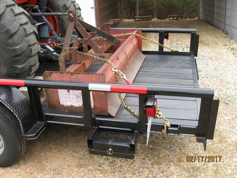

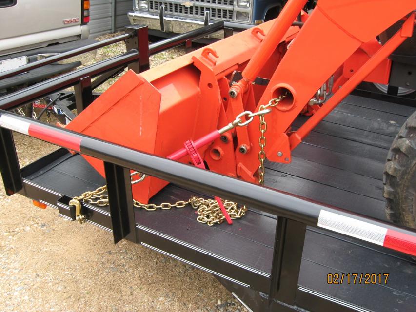

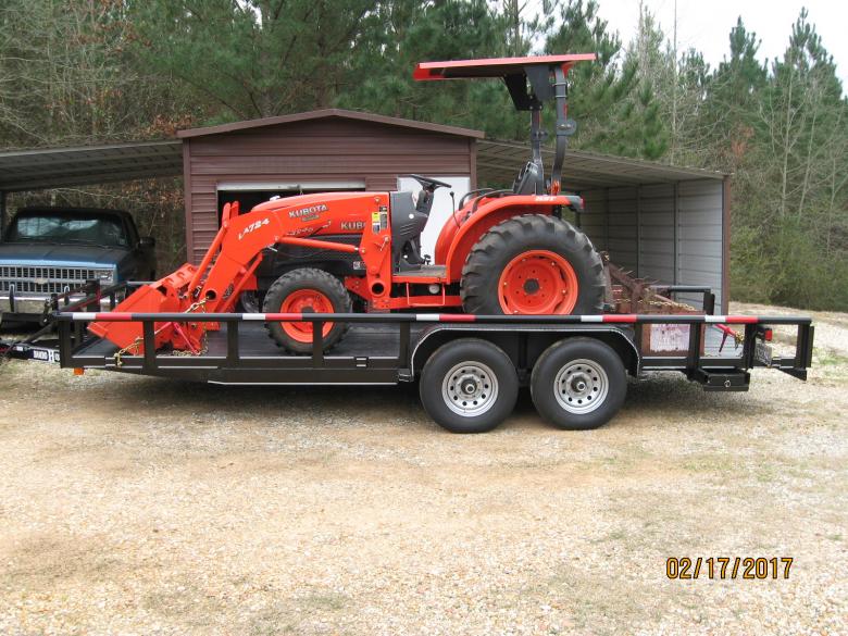

This has probably been discussed before, but I have yet to find a good way to anchor my tractor to my trailer and have the "four corners with X pattern" configuration. See the attached photos. I used two chains and two ratchet binders to anchor it down. The front through the pipe on the front end loader and the rear through a clevis hook. It's anchored securely but I couldn't find any locations to meet the "four corners with X pattern" configuration. It would be nice if the Kubota design engineers would put anchor hooks or something on the four corners. Any suggestions?

You are not making an "X". The way you have tied down still allows sideways motion.
All you need to do is use the same points, but cross over the chains at the ends to the opposite sides. This forms an "X" across the device/attachment and prevents sideways motion as well as forward/backwards.
Not to say this is the best way (or the legal way), but you definitely need the "X" pattern across both the front and back chains.

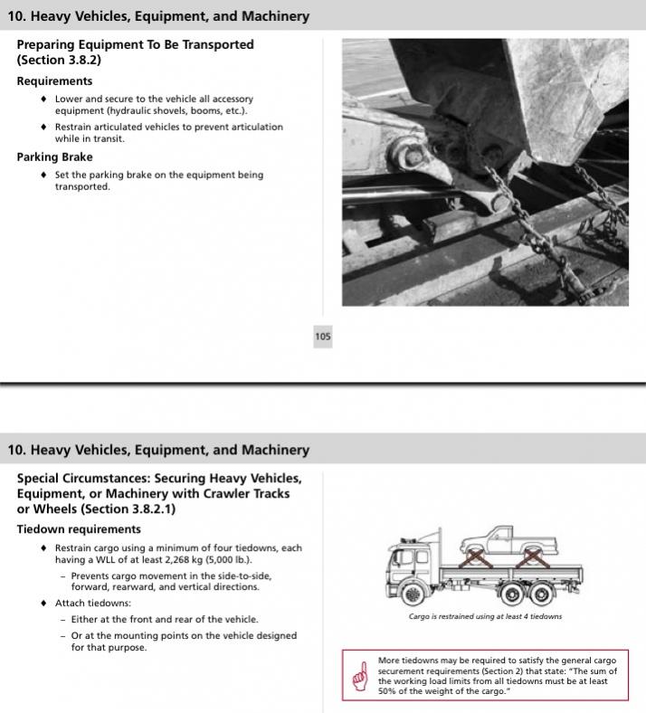

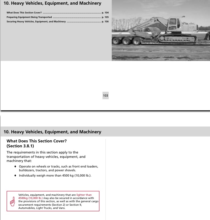

This is out of the DOT book.
§ 393.130 What are the rules for securing heavy vehicles, equipment and machinery?
(a)Applicability. The rules in this section apply to the transportation of heavy vehicles, equipment and machinery which operate on wheels or tracks, such as front end loaders, bulldozers, tractors, and power shovels and which individually weigh 4,536 kg (10,000 lb.) or more. Vehicles, equipment and machinery which is lighter than 4,536 kg (10,000 lb.) may also be secured in accordance with the provisions of this section, with § 393.128, or in accordance with the provisions of §§ 393.100 through 393.114.
(b)Preparation of equipment being transported.
(1) Accessory equipment, such as hydraulic shovels, must be completely lowered and secured to the vehicle.
(2) Articulated vehicles shall be restrained in a manner that prevents articulation while in transit.
(c)Securement of heavy vehicles, equipment or machinery with crawler tracks or wheels.
(1) In addition to the requirements of paragraph (b) of this section, heavy equipment or machinery with crawler tracks or wheels must be restrained against movement in the lateral, forward, rearward, and vertical direction using a minimum of four tiedowns.
(2) Each of the tiedowns must be affixed as close as practicable to the front and rear of the vehicle, or mounting points on the vehicle that have been specifically designed for that purpose.
