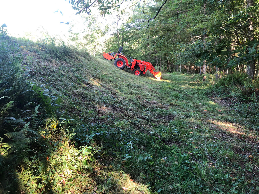

Having just come from a B2650 (previous version of LX2610) to an L2501HST the difference in weight and overall robustness is apparent, and if you don't need the mid PTO is probably a better choice for very little, if any, more money. One area where it'll be noticeably better is on hills because it's about the same height but the rear track is about 6" wider.
Messicks video comparing B series to L01 series discusses some differences between B2650 (now LX2610) and the L series,
I went with an EA grapple that's made for compact tractors, big and strong enough without being too heavy.
In fact I was using it yesterday to clean up and make firewood from a standing dead cherry tree that fell a few months ago. I probably use the grapple almost as much as the bucket.
I have an old rotary cutter but I bought a 5' flail for mowing down the meadows and around the pond. I'm now on my second year using it and so far am very satisfied. The tractor runs it just fine and it's a lot more maneuverable than it is with the 5' RC, and it mulches up the cuttings better.
Thanks for input, I'll definitely look at the EA Grapple.
I like the hill your 2501 is on, my land is sloped similarly but for about 400-500 ft more up hill.
How stable is it on that hill, I'm guessing it can only go up and down, not sideways?
how do you like HST vs the gear drive?
for hills which is better, AG or the wider industrial tires?

That hill is actually my pond dam and by far the steepest on my property. I back up it to the top, lower the flail and mow it down hill. HST all the way for me for a number of reasons. R1 Ag tires will definitely provide more traction than the R4's on dirt and grass. I think R4's are a bit more puncture resistant, stiffer, and smoother on road.
