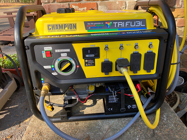

I found a generator of suitable size plus one that would run on Natural Gas which was a requirement for me. This is "Tri-Fuel" and will run on Gasoline, Propane, or Natural Gas and is the only generator that I found that had that option. I have two other Champion generators and have had excellent service from them.

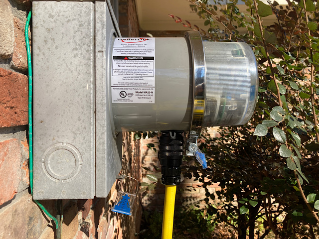

Next on my shopping list was a transfer switch. This GenerLink plugs between the power meter and the power box and does the switching without me wiring in a transfer switch.
Underneath is the inlet for the alternate power source plus indicator lamps to show the power status.

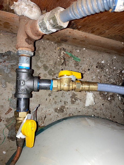

I needed to add a "T" and shutoff valve in the natural gas line. The supply line to the generator is seen on the right.
The GenerLink was installed by the Power Company.
Natural Gas is being supplied by the gray line on the left and the 240v power cord is on the right.

I actually found out about the GenerLink from my rural coop power company's publication. They did not sell or offer it, but they did install it. I had to Google to find a source to buy it and the supplier had to have verification that it was approved by my power company before they would sell it to me.

There are 4 different models available; 30 amp surge and non-surge protected and a 40 amp surge and non-surge protected.
One of the above pictures shows GenerLink's contact information.
My power company encourages the use of the GenerLink and there is no charge for their installation.
