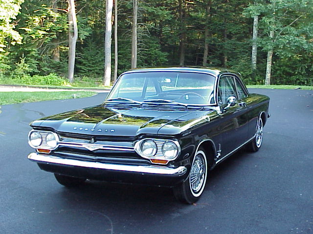

I have a 1964 Chevrolet Corvair Spyder, and if you don't follow the tire pressures recommended by General Motors, you will not be driving that car very long at 50 mph, since it will spin out of control and most likely result in a crash. Doesn't matter what brand of tires are on the car, it is the front-to-rear tire pressure ratio that is important. Back in the 1960s many of the tire dealers didn't understand the handling characteristics of the Corvair and overinflated the front tires and had all 4 tires at the same pressure. That made the handling of the car more like trying to drive a squirrel. This is what led Ralph Nader to mistakenly say that the Corvair was unsafe at any speed. I have put thousands of miles on that car in the 30+ years that I have owned it, and I always have the tires inflated to what the manual says they should be. Doesn't matter if they are bias ply or radial tires, the front-to-rear pressure differential must be adhered to. I also agree with what N I W has said about tractor tires, and I inflate them to the maximum as indicated on the sidewall of the tire. With cars I follow the manufacturer's recommendation, on my tractor, I follow the tire manufacturer's recommendations. Trucks and trailers are another subject and I will leave that the those with more knowledge about them than I have.
6,639
4,198
Beautiful!
Do you still have it?
