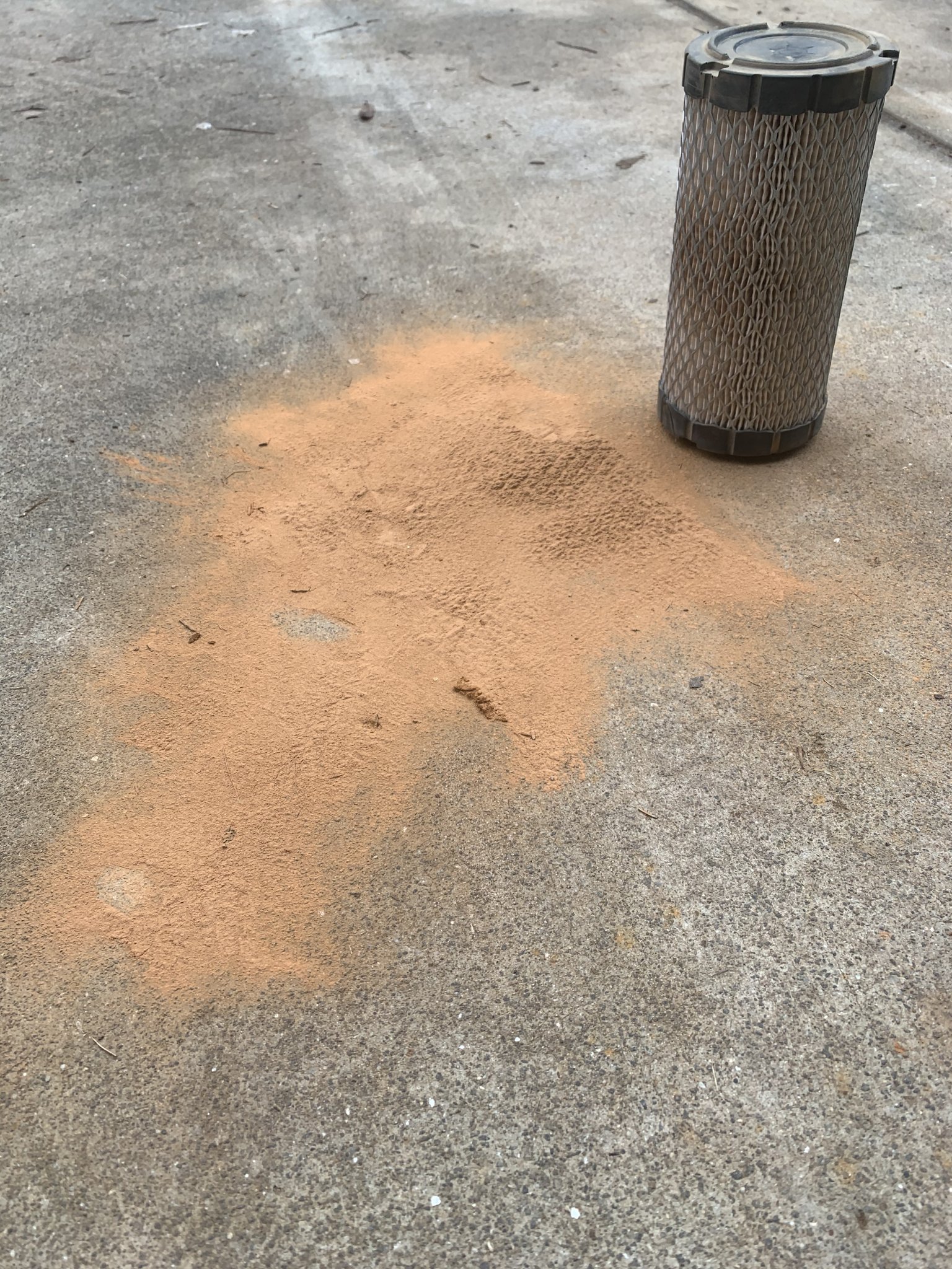

Knock out the big chunks and blow them from inside out with 90* wand. This is from a JD bunker rake used on a ball field.
