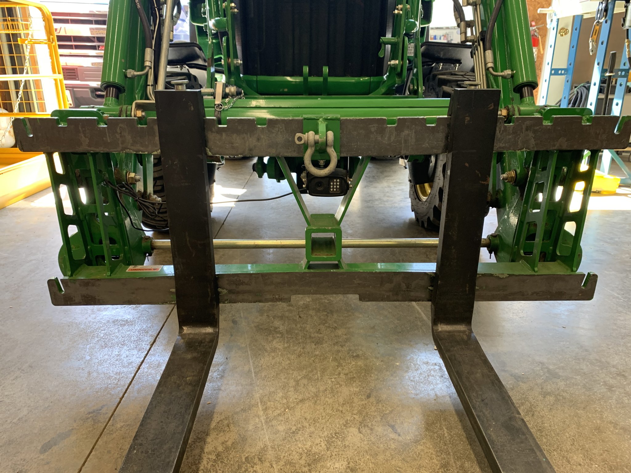

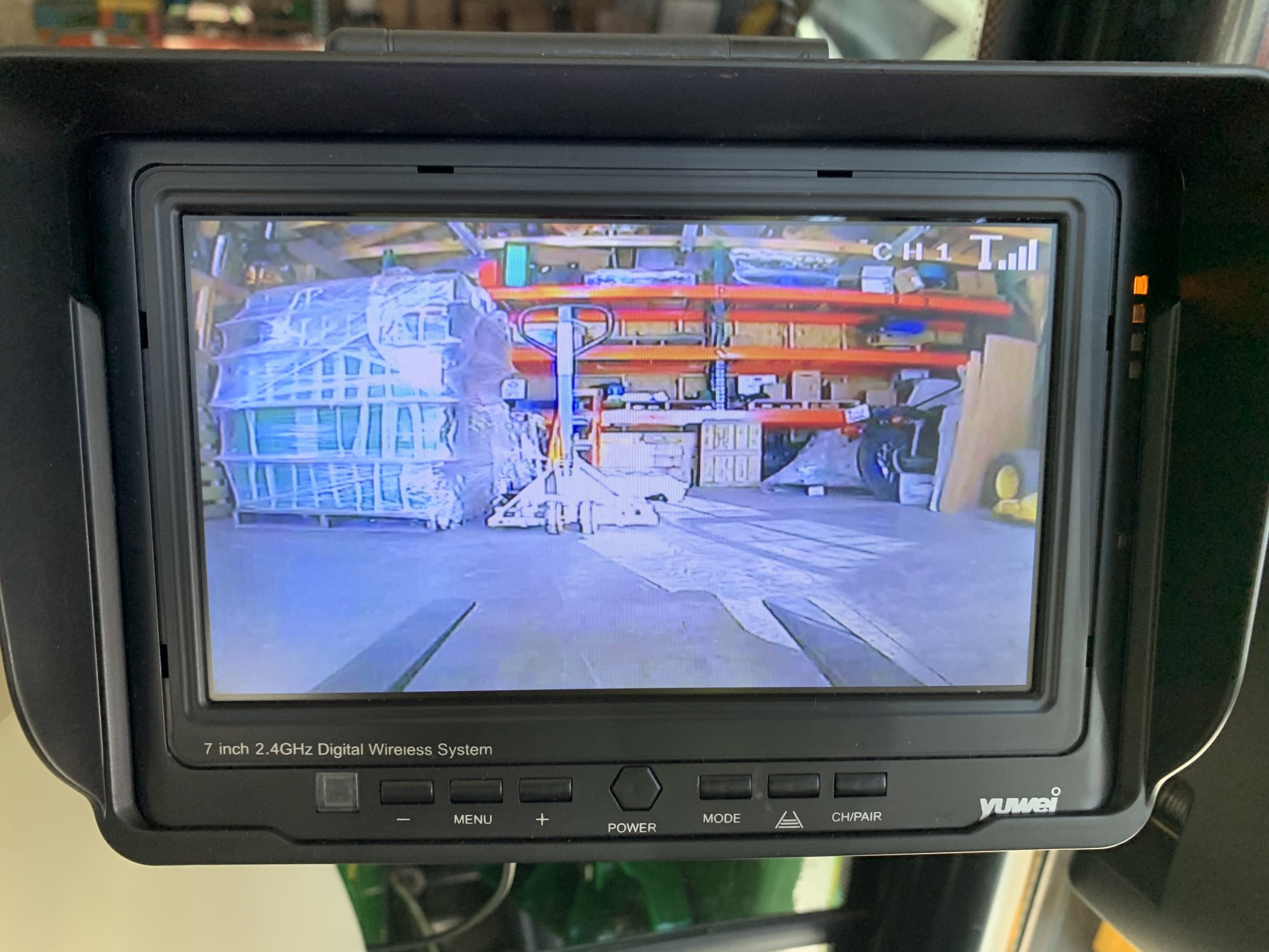

I ordered the camera from Amazon and the bracket from Paul & Kathy. I plan on using the forks a lot on my new L and don't want to be poking holes in my product. My fabrication skills are 0 for this kind of thing and I've bought from them before and was pleased with their parts.

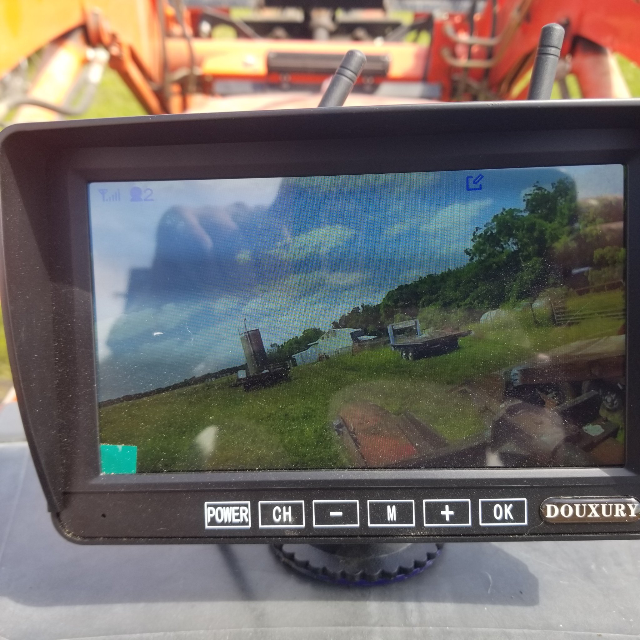

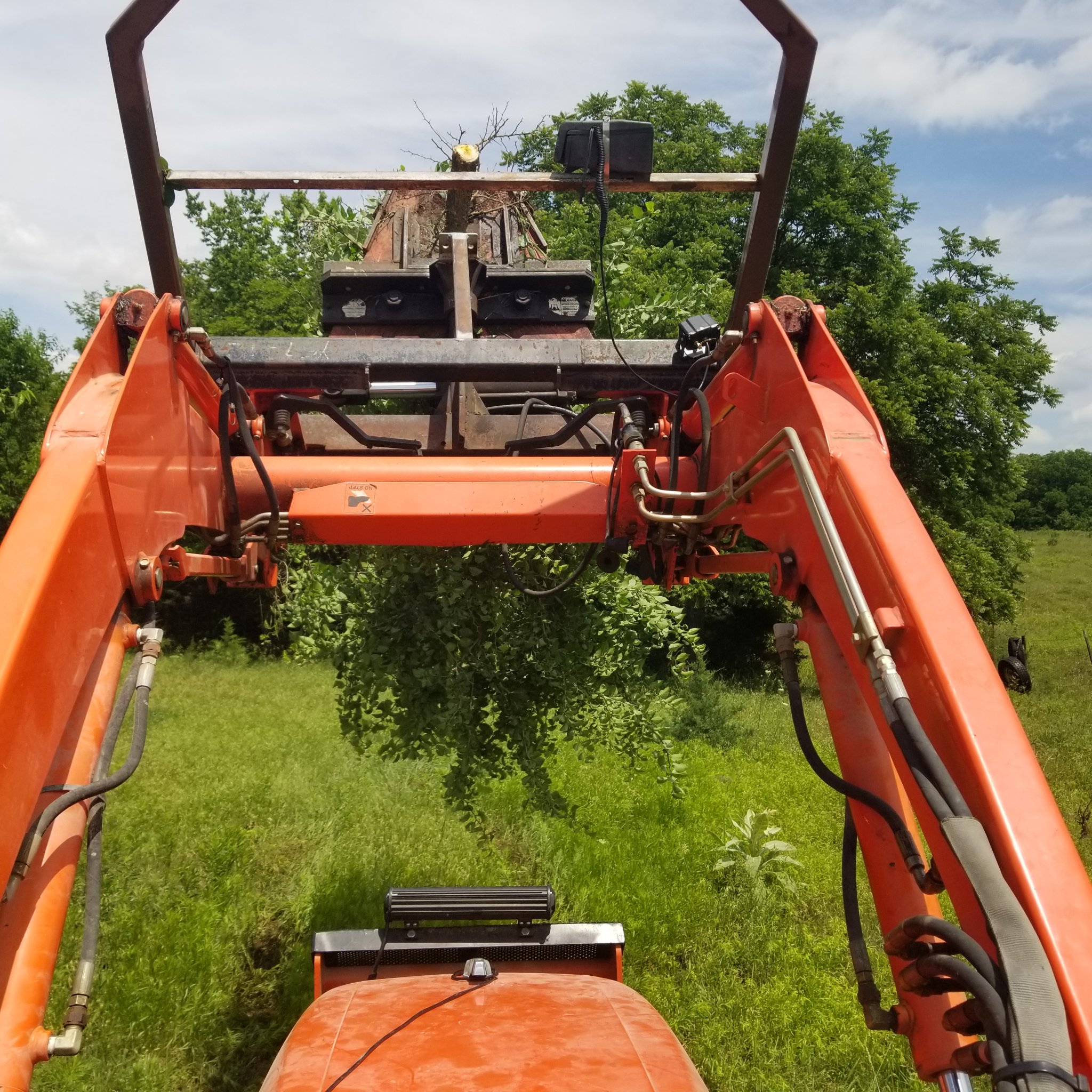

I use a backup camera when I use my tree sheer. I had the same problem with vision.

I attached an piece of angle across the brush guard of the sheer, bought a small 12 volt battery and put it in a box and clamped it to the angle. The camera is held in place by a magnet. Monitor is held in place by suction cup base that came with the camera.

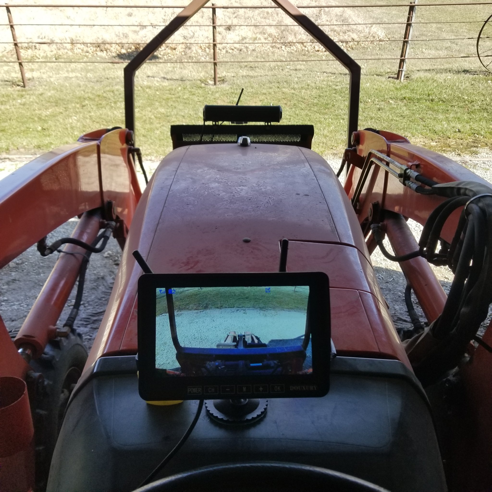

Can't stand up in my cab to see the tips of the forks so I too had to buy a backup camera. Magnetic mount so it sticks to the frame of the forks, and an 8" monitor mounted on the Kubota's dash. Helps a lot - but takes some practice to use.
