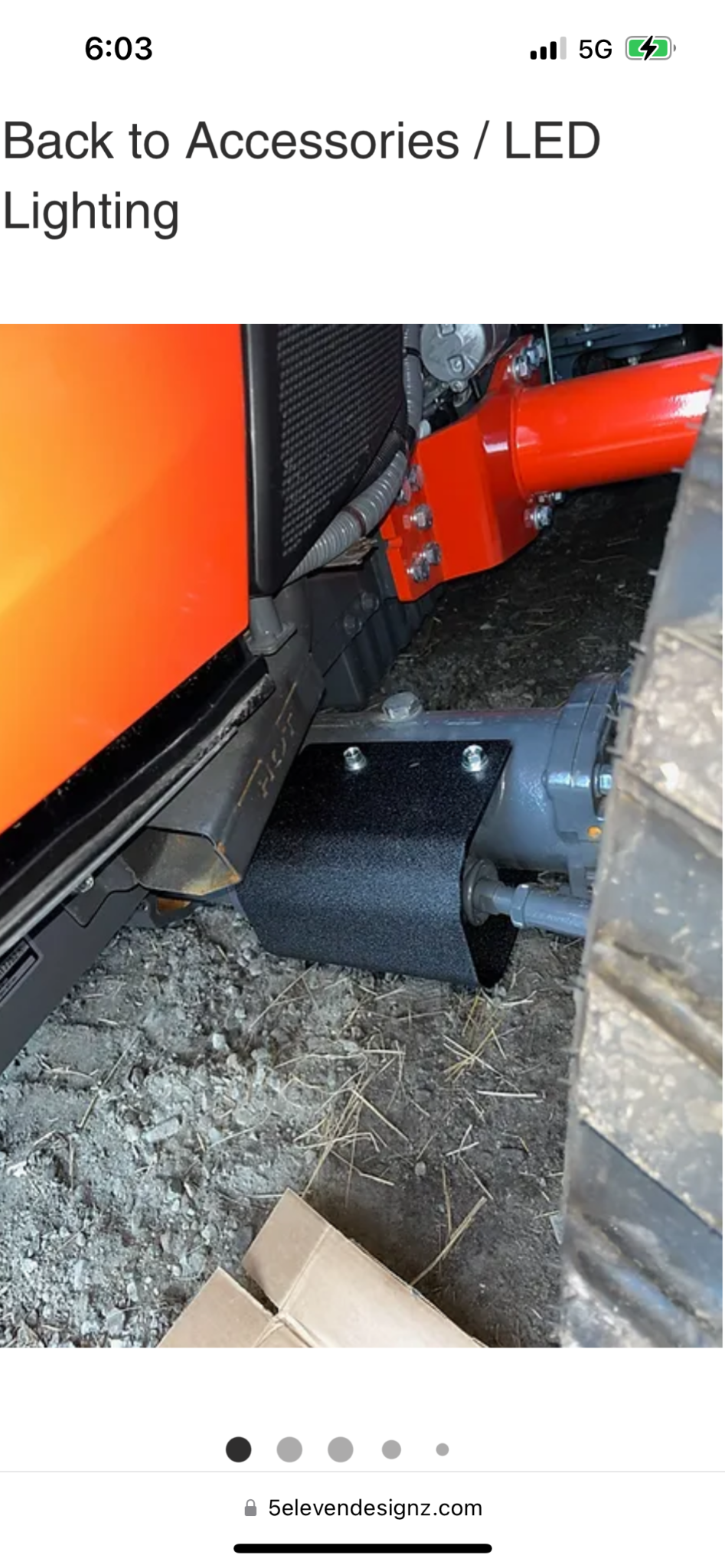

Hey i appreciate The reply. I guess I should Have been more specific. But I’m looking for an aftermarket metal guard. Like this.

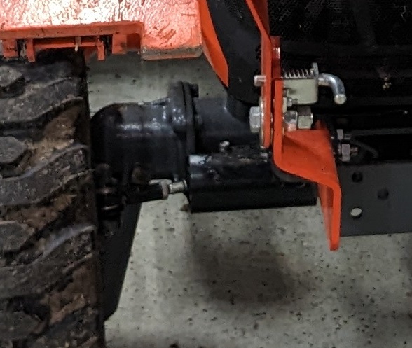

My LX2610 came with guards from the factory pretty much like what you have photos of....

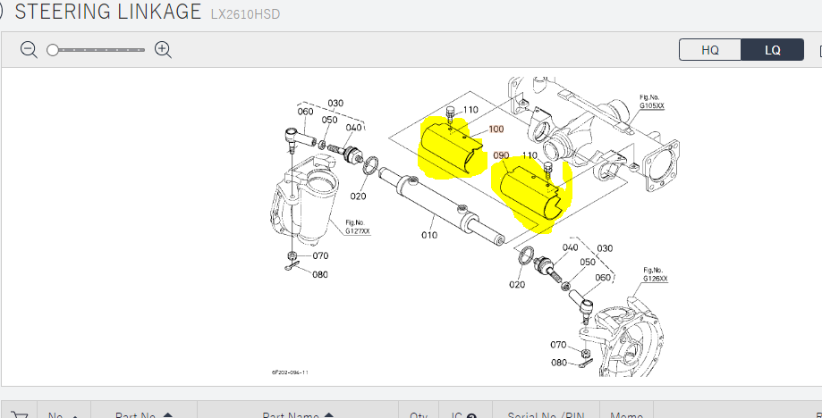

Yea I'm a little confused as they are stock parts.

I don't know where to buy them, but that looks like a pretty quick (and fun) "fab job". Get some 3/8 plate and bend em up real quick. (y)
My biggest concern would be;
"What part is gonna get broken if the covers are so strong that they don't bend?"
Just from a quick glance, it would appear that either the bolts would snap, or worse, the axle mounting holes would get cracked/buggered.
It's almost seems like a "bent cover" is a warning sign that should be heeded.
