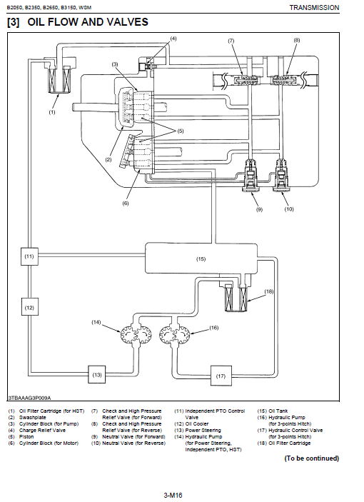

The tractor hydraulics power all of the tractor hydraulics including the HST. The HST is fed by the hydraulics and that fluid is filtered a second time before the HST.
This is not accurate. Most hydrostatic transmissions have their own charge pump and filter
Ok, strictly speaking, there's a separate pump for Power Steering, Bi-speed Turn (if equipped), Independent PTO and HST, and the other pump for 3-point and external connection, i.e. a backhoe.
So the tranny shares a pump with power steering and pto clutch.
Both draw oil through the same sump filter.
There's another filter right before the HST.
Sound right now?
Sound right now?
No they share the same reservoir and in some instances the HST circuit takes oil from the the same Hydraulic oil suction filter but generally has its own charge pump and propel pump and motor. As well as filter.
There are hydrostatic transmission designs that do share a pump for charge with another function but I am not sure if any Kubota models do this or not. I know the ones I have looked at so far do not. This does not mean there none I just do not recall seeing any in the Kubota schematics I have read so far.
This is where I got my info from about the hydraulic circuits in my B2650.
nbryan
Jan 3, 2019
1,307
829
Hadashville, Manitoba, Canada
Then that model does share the pwr str/pto pump as a charge pump. This is not used across the board so making a blanket statement is not accurate.
I was only referring to the poster who has a LX2610 tractor. Same unit a my B2650. Was not a blanket statement. His tractor has the same circuits as mine.
