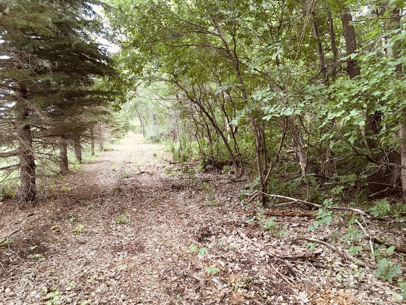

Ok, for Andy's decision making benefit, you shamed me into going out and taking some pics too. :LOL:
Here's the first trail, now 2 years old with the most passes with the flail mower. It's wider than it looks but the edges are covered with wild flowers (phlox and ?) so we're going to let them go to seed before I mow again. Two weeks ago they were in full bloom and very pretty.

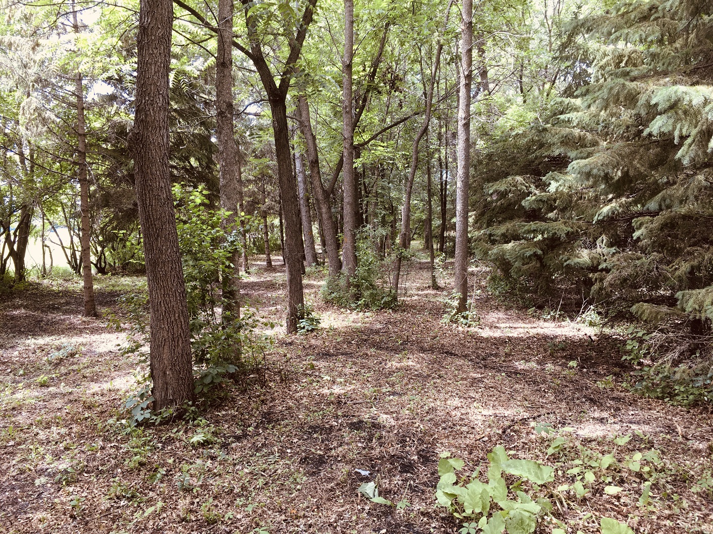

Another trail through the woods with a few less mowing's to date.

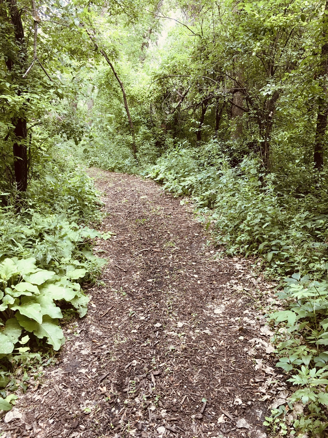

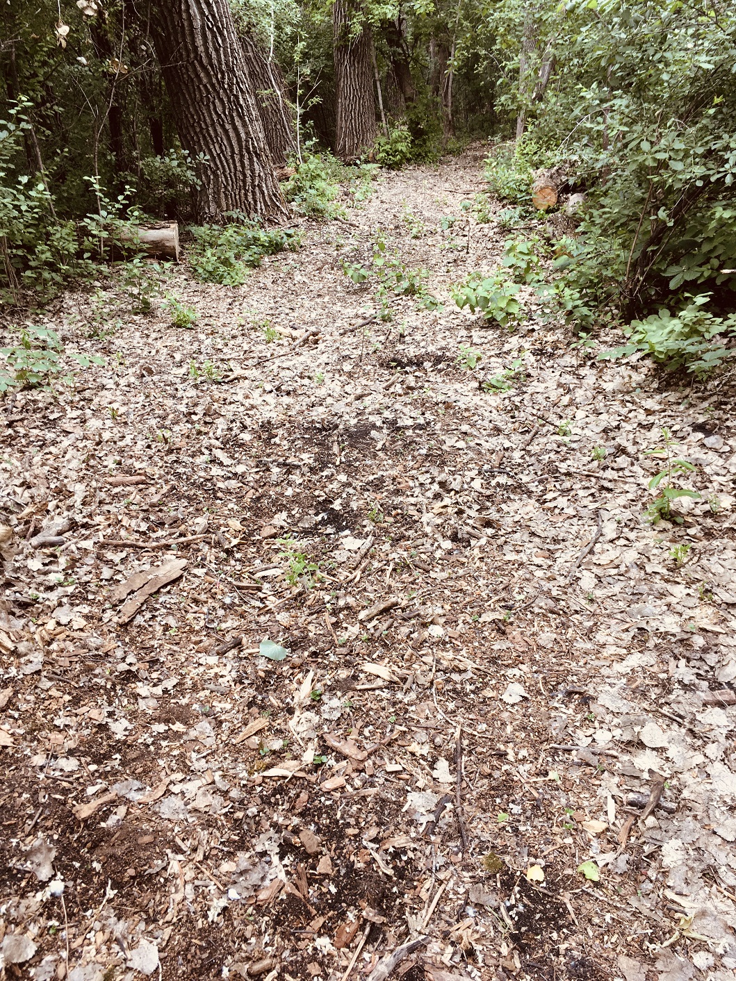

Here's two before/after comparison pics:
Before Clearing & Flail Mow.jpg Cleared and Flail Ground.jpg the taller junk trees (mostly buckthorn) were cut just above ground level and hauled away and burned. Then the area mowed with the flail mower. The 3" diameter stumps were either ground up or turned into a stub of bristles that resembled a barber's brush for shaving cream. If they were in the walking area of the trail as "toe stubbers" they were removed with the stump grinder, although that was more the exception, rather than the rule. A few more mowings over the next year may have eliminated them altogether too.

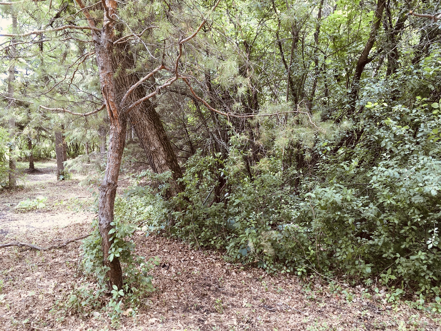

This last pic shows a swath I cleared along a row of pines planted against a dying shelter belt of brush/trees. It was time to clear away from them to the inside. First larger brush (buckthorn) cut and removed. Then, any toe stubbers and larger stumps were ground out. But the flail turned the rest into basically mulch.
For cutting under trees with the flail: You just raise the flail up; back under and lower; then drive forward. Works great. You just can't reach as far under a pine or more lower branched tree as you could with a 3 pt rotary cutter. But because it's short coupled....its much more maneuverable.
And even after all this brush/trail cutting it still cuts grass extremely nice!
Each mower type has their advantages. This is how my flail works for me. Hope this helps!

OK, that's super helpful. Those really nice looking trails. I like your advice about mowing under trees.
