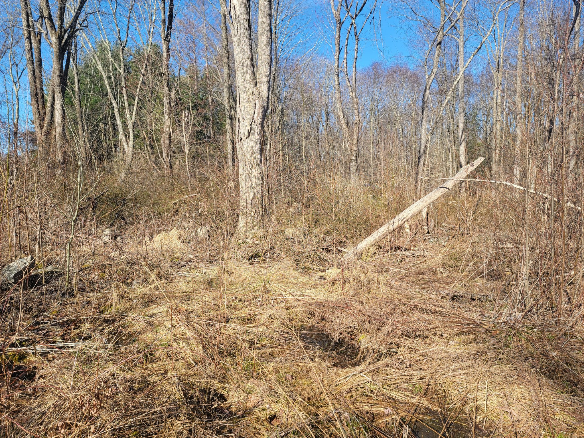

As I said in title, first tractor, older man. 62. I have no experience on them, but want to cautiously learn how. I say cautiously because don't want to injure tractor or ME.
Only own about 3 acres. Mowing is covered by a Wheelhorse tractor I have owned for over 20 years that takes care of minor landscaping chores as well.
The "unmowed" area is wooded with briar patches, ROCKS, saplings and some wet areas. This is what I call my playscape. This is why I want a tractor. I plan on slowly transforming it into a space for my boys to spend time in as well as myself and wife. Boys are still young as well as wife. 10 years old and up.
I am looking at 25 hp tractors. B2601, Lx2610/2620, or l2501/2502. I considered the BX23 for its backhoe , but thought it would be less than useful in ground clearance or power.
What would you suggest for a tractor that would be easiest to learn, maintain and get the most out of? I would love a backhoe, but the cost just kills me.
I will have plenty of time, so speed in working the land is not important to me.
I have considered a loader, of course with a grapple and possibly bush hog.
Many of the rocks out here are heavier than can be worked with tractor. So they will be worked around. I plan on adding a shooting range with backstop of dirt.

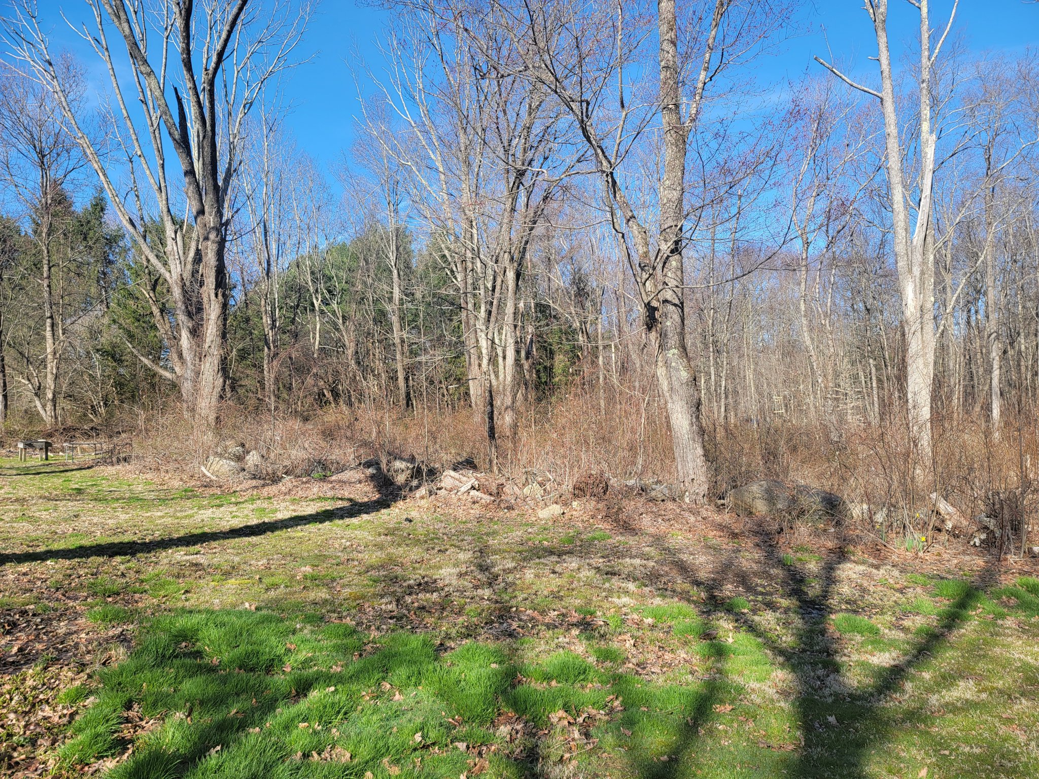

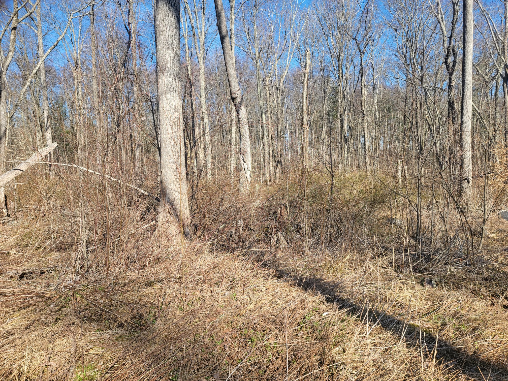

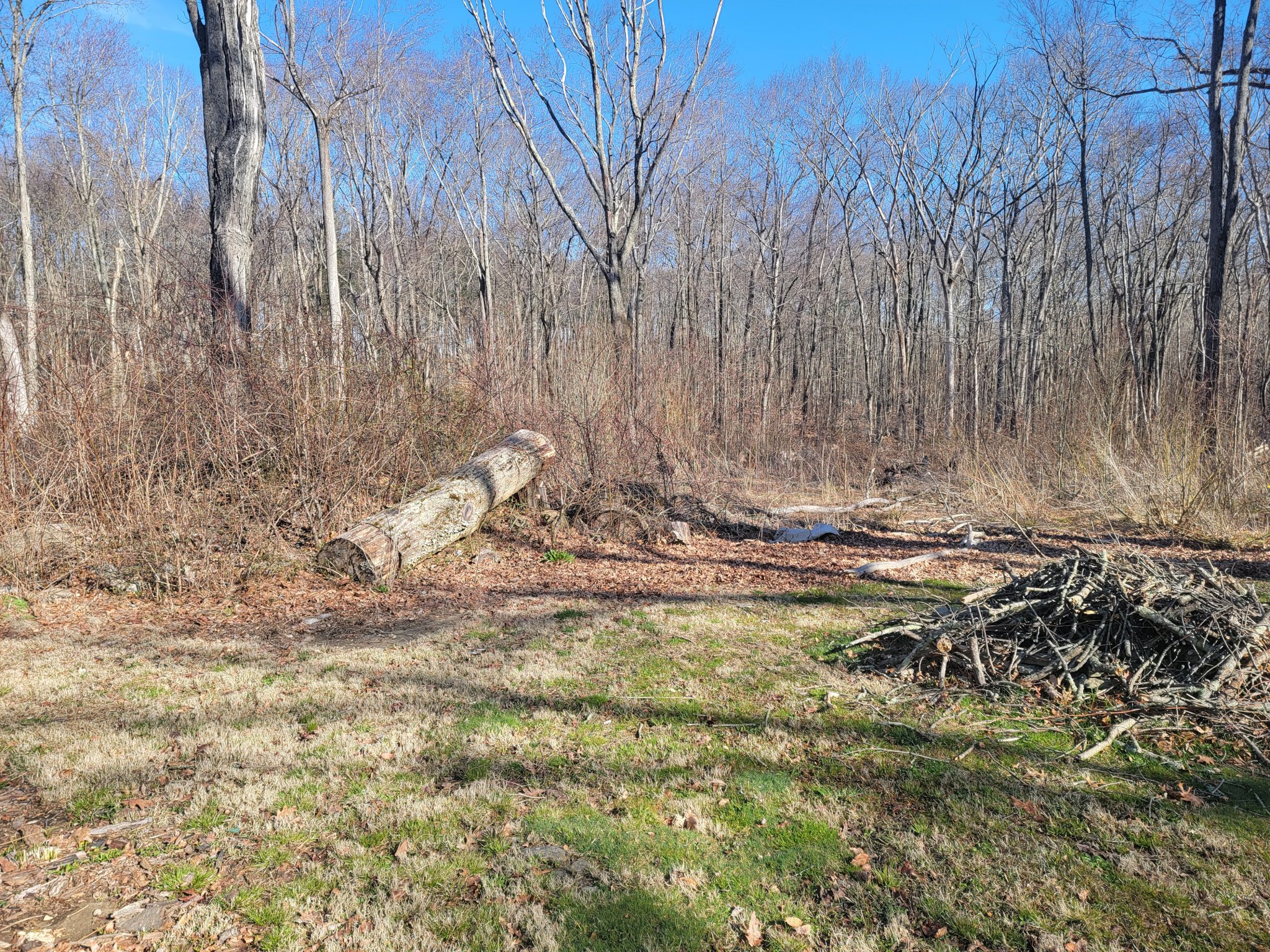

I will add some pics of the land as it is right now, if that would help.

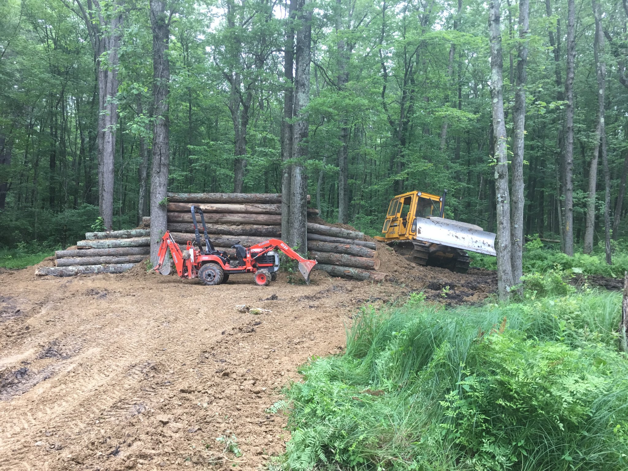

My shooting range was the VERY FIRST project I did when I bought my 2502 in September. I had just purchased my home and 20 acres in August and had to have a place to throw some lead....

Welcome aboard and congrats on the retirement! Take plenty of time to decide because it's better to get what you really need (or want) without going through a couple different tractors to get there. A tractor that may feel really big when you first hop on it gets smaller as you gate accustomed to it.
Can't tell from the pics, but some of that ground looks like it could be fairly soft in some seasons. If so, that would be a consideration.

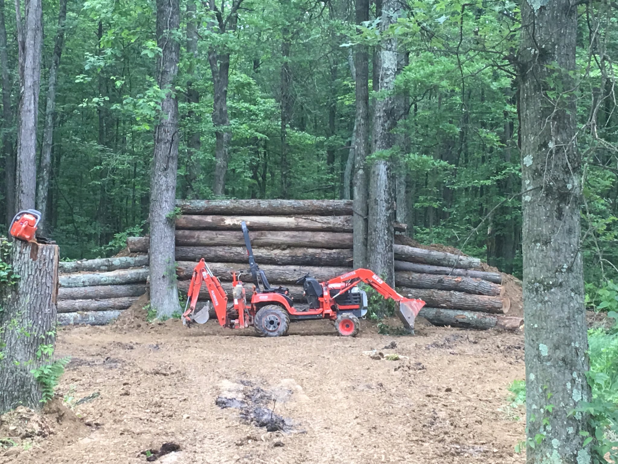

Welcome @mailman, you sound much like me. I have a bit more land that I maintained with four 520H Wheel Horse tractors, one with cab and snowblower, one with a loader, one with a 60" mower and the last one doing tilling, mowing, grading, snow plowing and various duties.
While it worked rather well I decided to add a B2601 with a backhoe and a 60" zero turn to the fleet. This gives the Wheel Horses a break so they might work for another 30 years. Yes, I don't need all of this equipment but it makes life easier. The backhoe was used to dig out under a building for repairs, sewer repairs, stump removal and just last week it dropped a large leaning tree that was partially uprooted.
I think this was the day that convinced me to get a larger tractor:

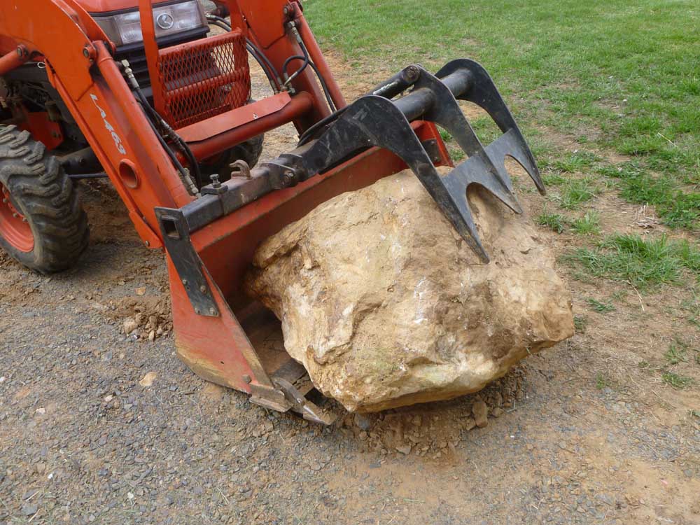

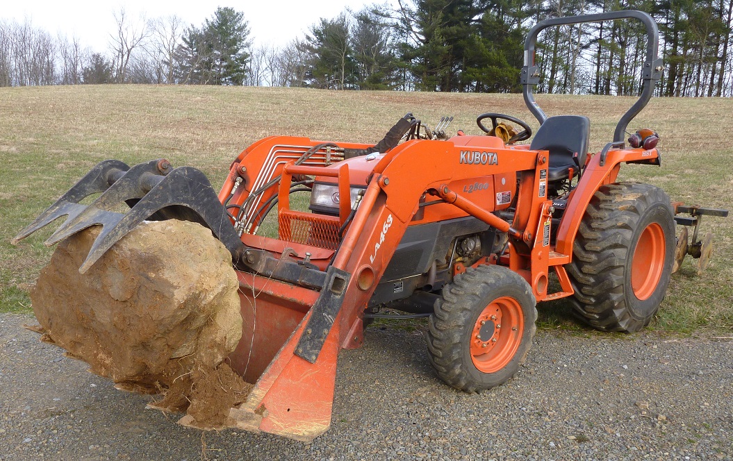

You'll be surprised at the size of rocks you can pick up. These are a couple of the smaller rocks I moved. The bigger ones filled the whole bucket.
Any of those tractors you listed would work for you... Only recommendation would be is to get the Hydrostatic drive, HST.
Old n Tired,
what is that grapple add on called?
That's impressive. Mind if I ask what attachment you have on bucket?

Eric View attachment 126455 View attachment 126456 View attachment 126457 View attachment 126458
