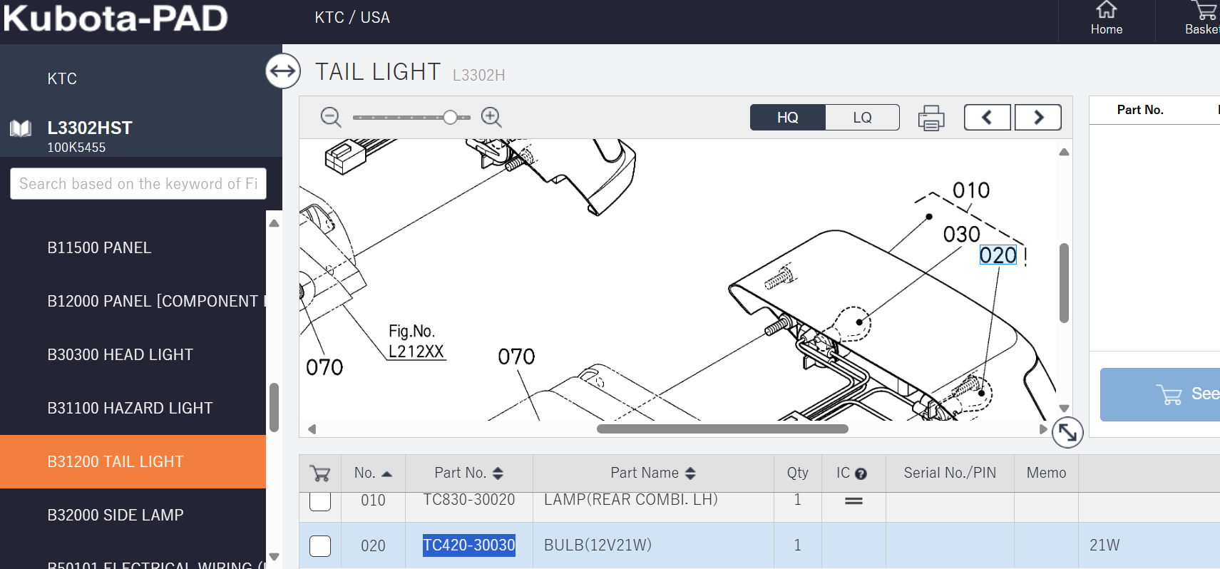

Did a quick search of you taillight bulbs. Look like conventional auto bulbs, but didn't find an auto version number or LED equivalent quickly.
I'm 98% sure they're easily gotten.
I would take one out. Take a trip to an auto store and compare. Betting you can find an LED version, or a least find what bulb model number it is.

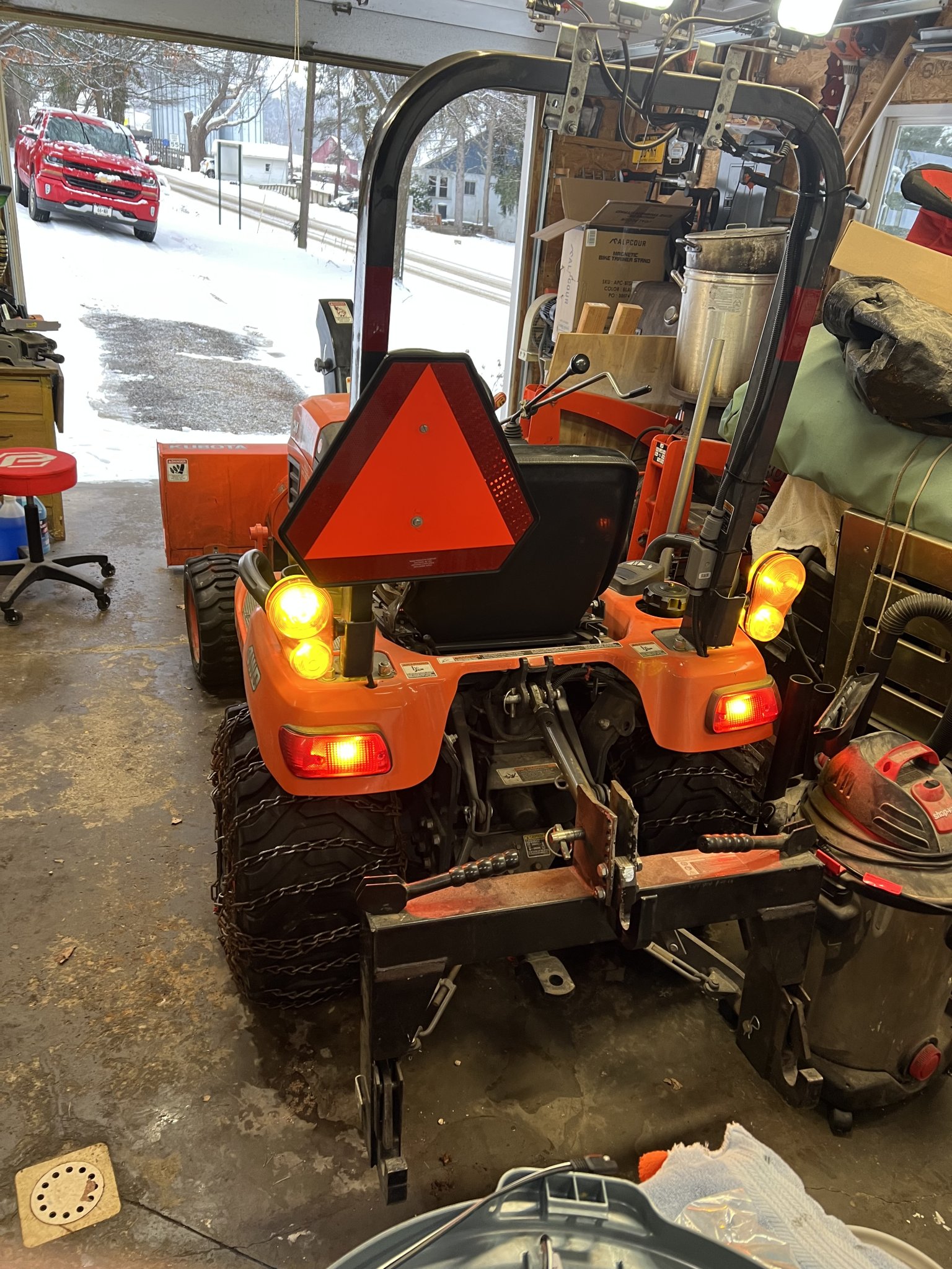

If your interested in increasing the bulb output and reducing latency from either your front or rear bulbs, high quality leds will certainly help. I added led headlights, taillights and lollipop lights to my LX2610 for the sole purpose of being more visible when I'm plowing snow near the road at night. I also added a led beacon and I engage the hazards whenever I am plowing near the road. Since I'm still here to tell the story, it has seemed to work well so far.

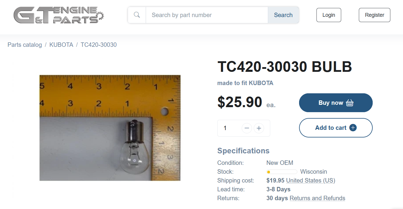

The OEM Bulb is spendy!
