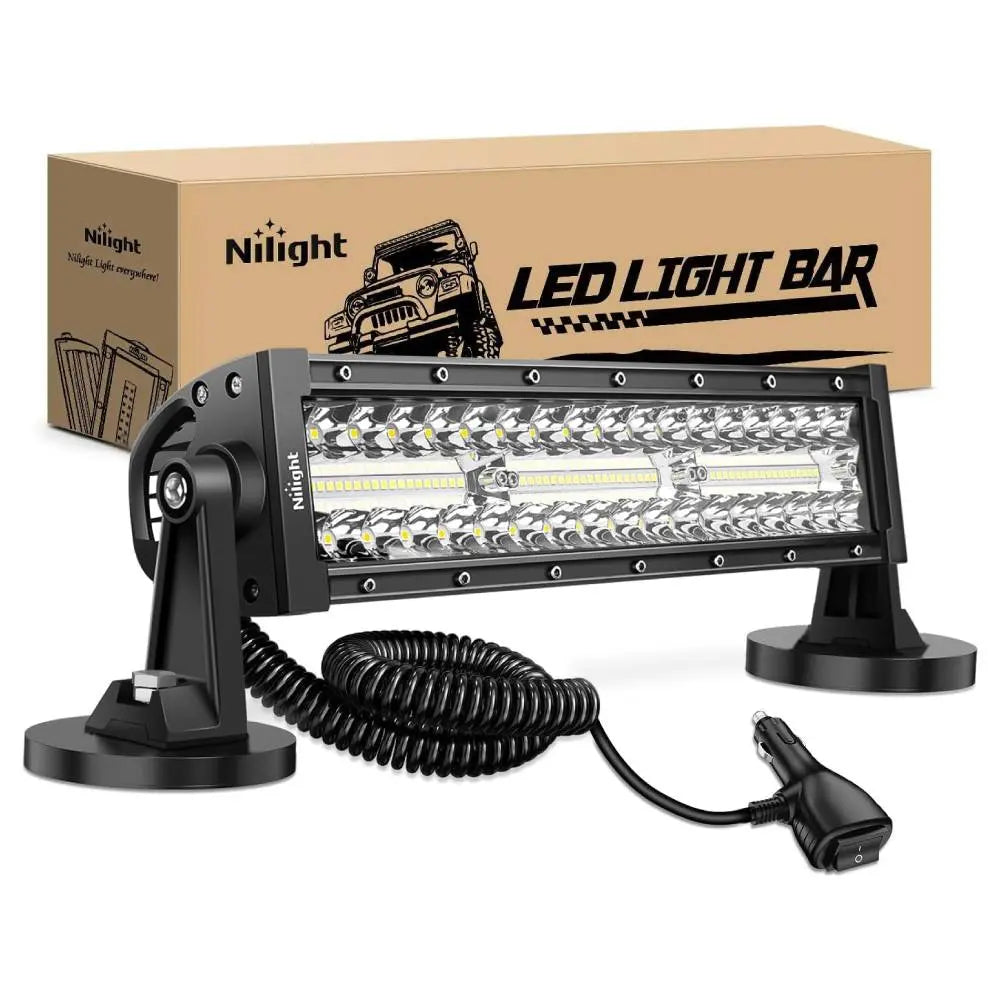

I went with a light bar that plugs into my cigarette lighter. I attach it to the ROPS.
