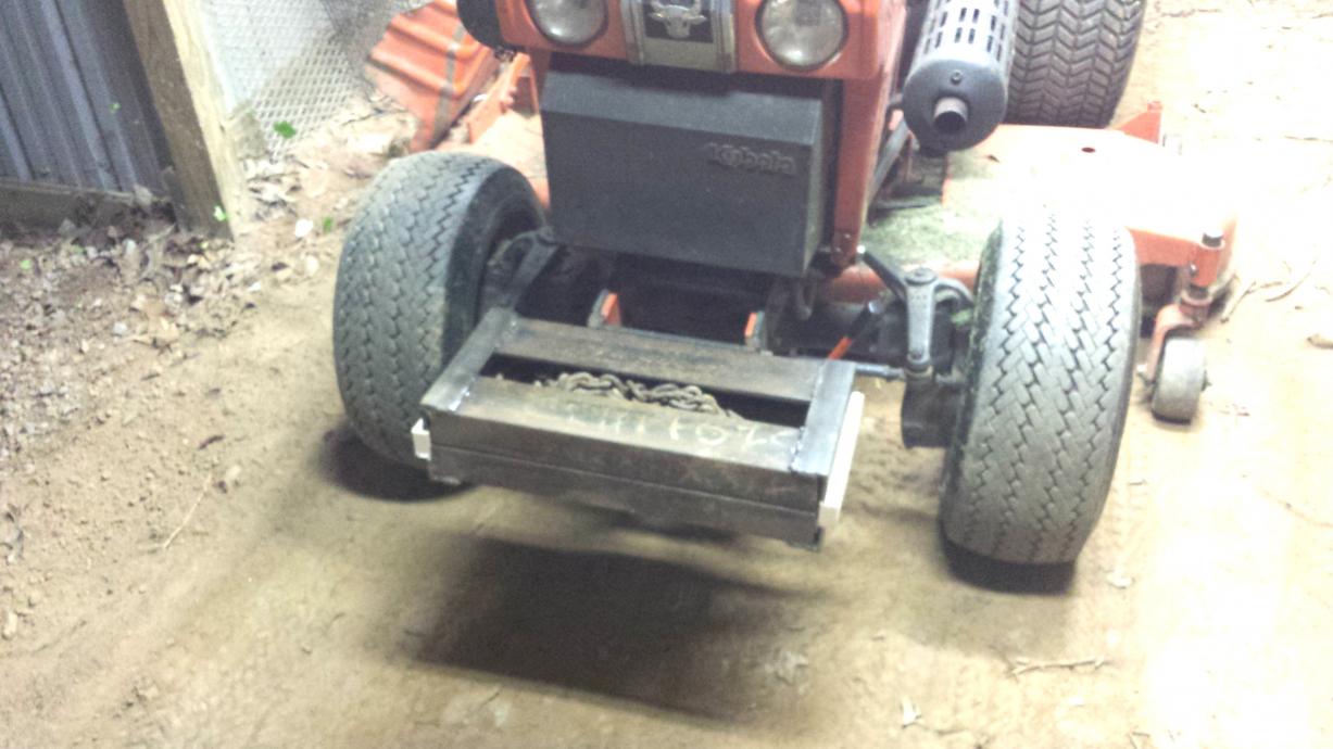

Had my son make a very simple metal box, top has a slot in it - box weighs about 25 pounds, the 20 ft section of chain with hooks inside the box weighs something like 30 pounds more. Utilized the holes in the front bumper that is stock on the B7100.
It works well when I have to cut grass up a very steep hill!
