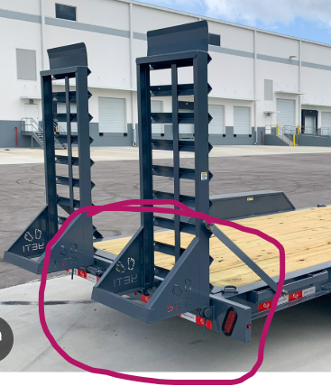

I reread what you wrote, are you talking about this style?
If you are then you need enough clearance so when loading they hit but when loaded they are off the ground, or you won't be able to fold the ramps up.

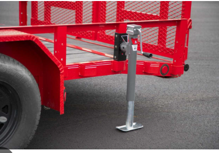

Or this.
My first statement was thinking you were talking about these.

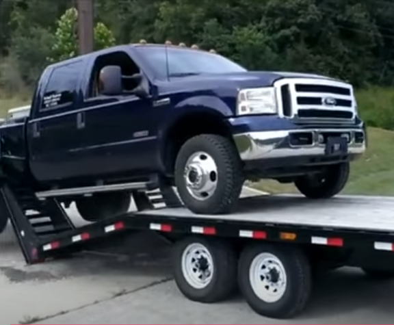

If you design them wrong this will happen!
