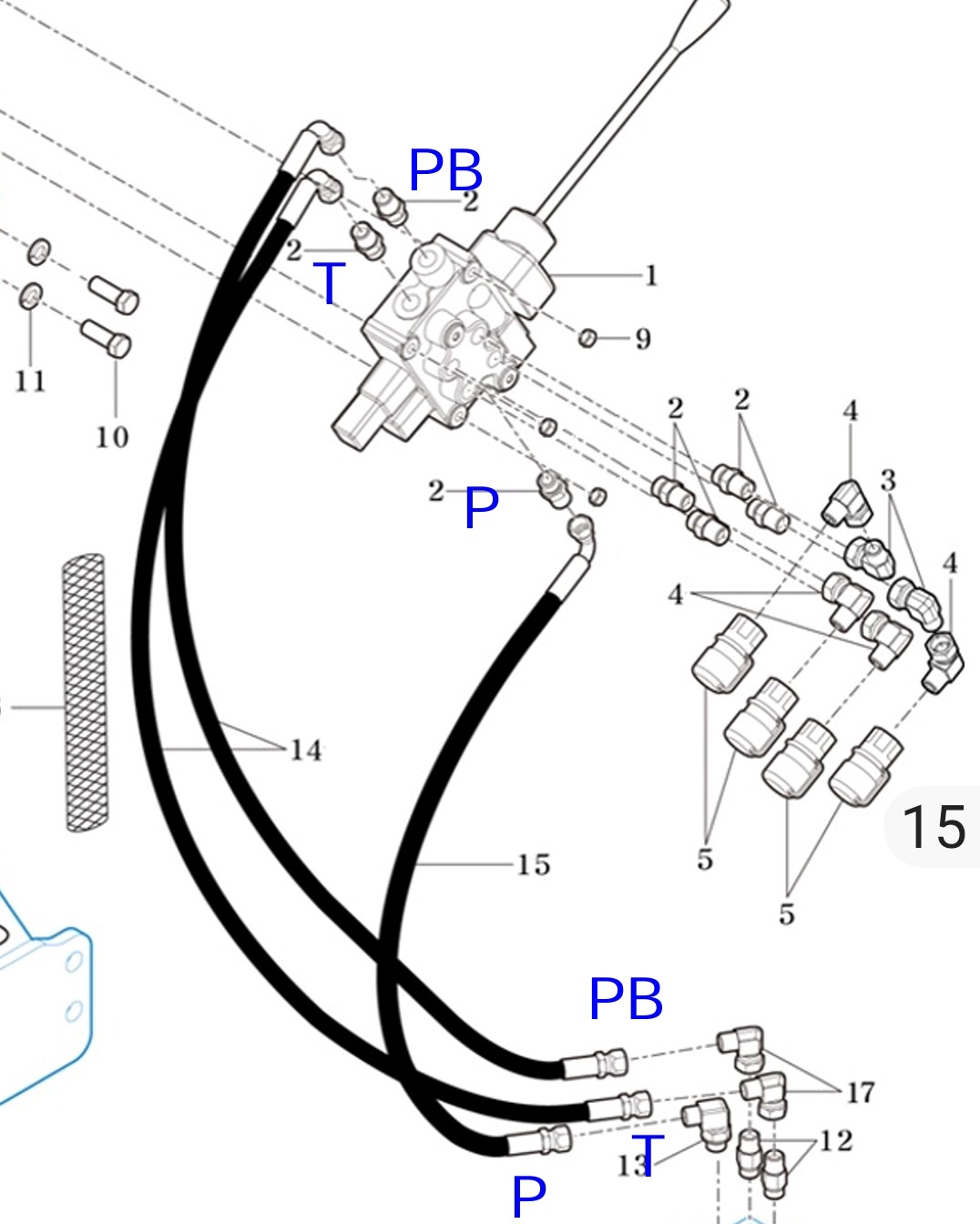

No thats not how it is supposed to be. The valve has P, T ,and PB ports and he was only using P and PB. Here is my best guess as to ports. You need to use all three.

I hooked it up just like the drawing you sent. I will get pictures tomorrow and send them.

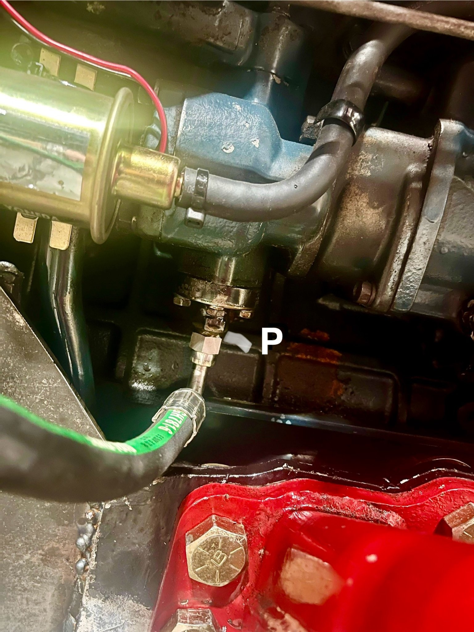

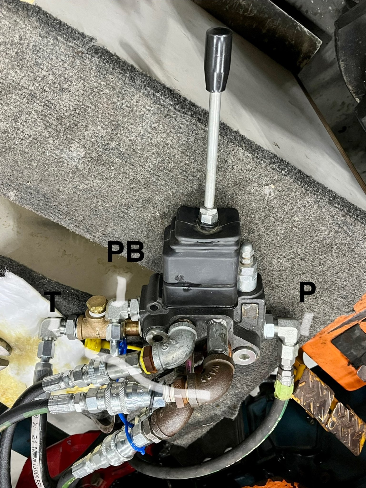

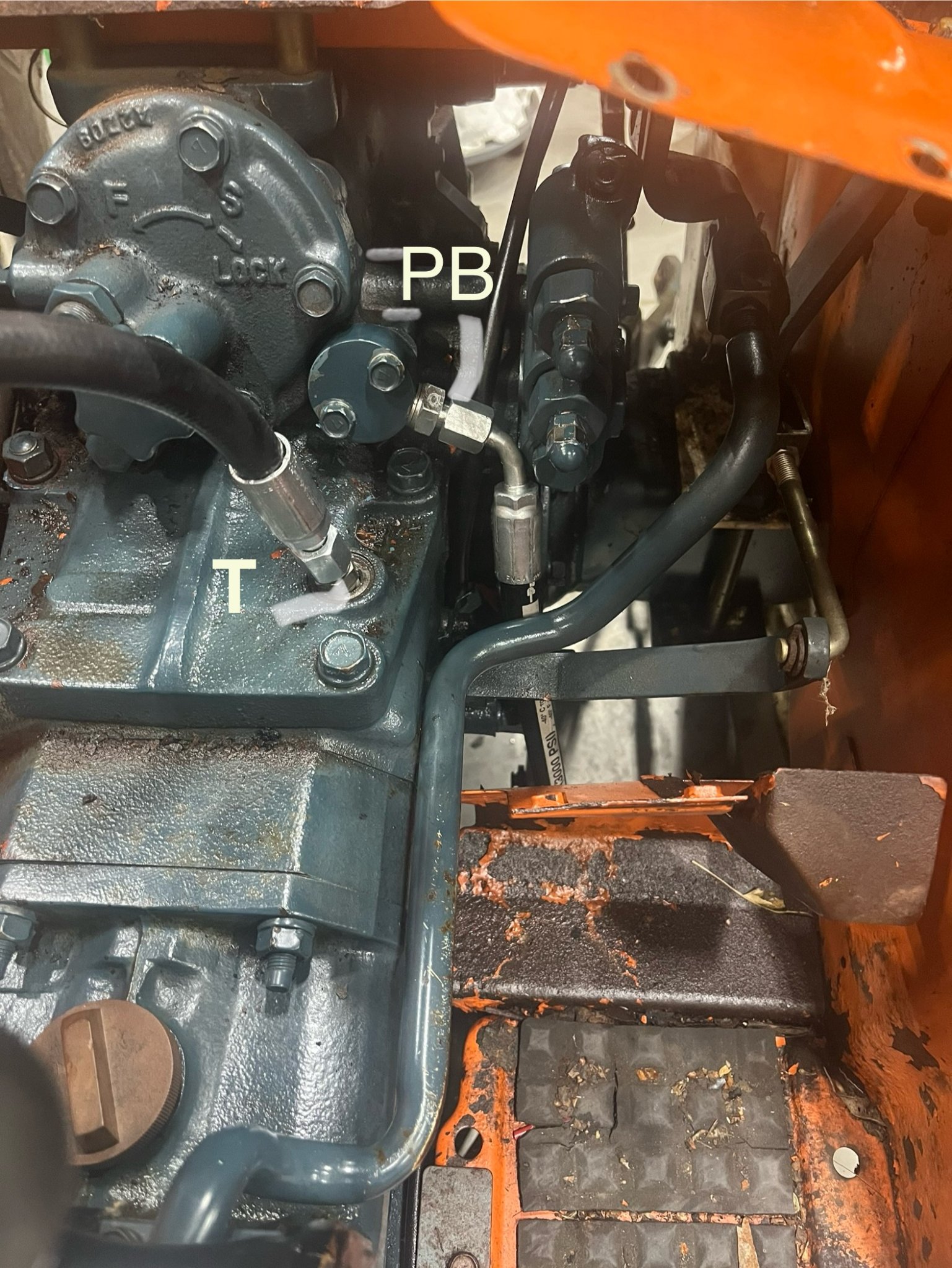

Here’s the way I have it hooked up. I know it’s rigged right now but like I said before I will make it nice once I get it all figured out. Not great pictures but hope this helps.
Thanks,
Charles
Thats the porting we talked about but I am afraid you may have boogered up the threads in the T port. The TYM manual says those ports are BSPP and it looks liie you used an NPT fitting.
Post a picture of the plug you took out of T. I was going to have you put it back..

You are correct they are BSPP threads, I didn’t have a straight fitting JIC to BSPP and the ports are so close I couldn’t thread in both fittings. I lightly threaded the npt nipple in and went smooth I was careful not to strip threads or tighten too much. I can put old plug back in

Put the plug back in and test the 3pt. Hopefully it does not leak.

I reinstalled the plug in port “T” and both loader and 3pt work great with no leaks. I was curious so I swapped
Hose and put plug in “PB” and both loader and 3 pt work as they should that way as well. Am I safe to think it’s ok with just the two hoses hooked up?

The valve is missing whatever is needed for PB operation so T and PB are connected together. That why you got no pressure to the 3pt with the T line connected.
Are you safe? Mostly but you are likely exceeding the maximum pressure on T by about 4X. That often results in leaks at the seals on the spools. You are also at risk of truly deadheading the pump should something block the return portion of the circuit. The relief valve is dumping into a pressure circuit and cannot unload the pump if that happens. Gear pumps will self destruct in a matter of minutes if that happens.
If I were you I would be researching a way to get the proper plumbing in place.

Ok I’ll do some more digging and try to get ahold of TYM again. Do you think it’s possible that another port is the “PB” port and I’m tapped into the wrong one?

Not based on the diagra. In the TYM manual. Plus its in the right spot and has an extended boss on the casting. Look for some sort of port label in that area. More likely you are missing some sort of conversion fitting. Look inside and see if there is a place to screw something in.

I recall the port in the tractor is G3/8 BSPP where you have a hose end just pushed into the port (on top of the transmission).
