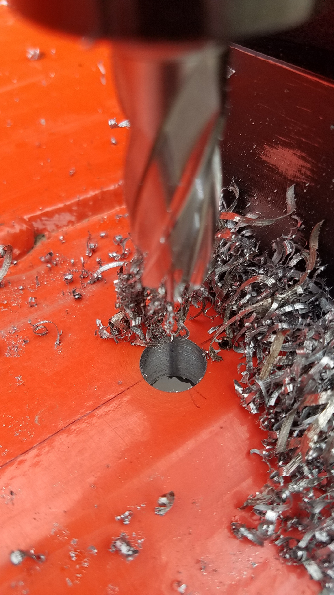

Hi all, so I noticed some wear to the factory cutting edge on both sides of my bucket, so I found a 54” Kubota cutting edge at my local dealer, it’s a non reversible one for $175.,
So I decided to try and attempt drilling the holes myself with a mag drill I rented from a rental place , that was $45 and had to buy a speacial bit for it, $35 for the bit…
Well I made it 3/4 the way through and the bit broke. Looks like I’m going to find a machine shop….. nothing is ever easy

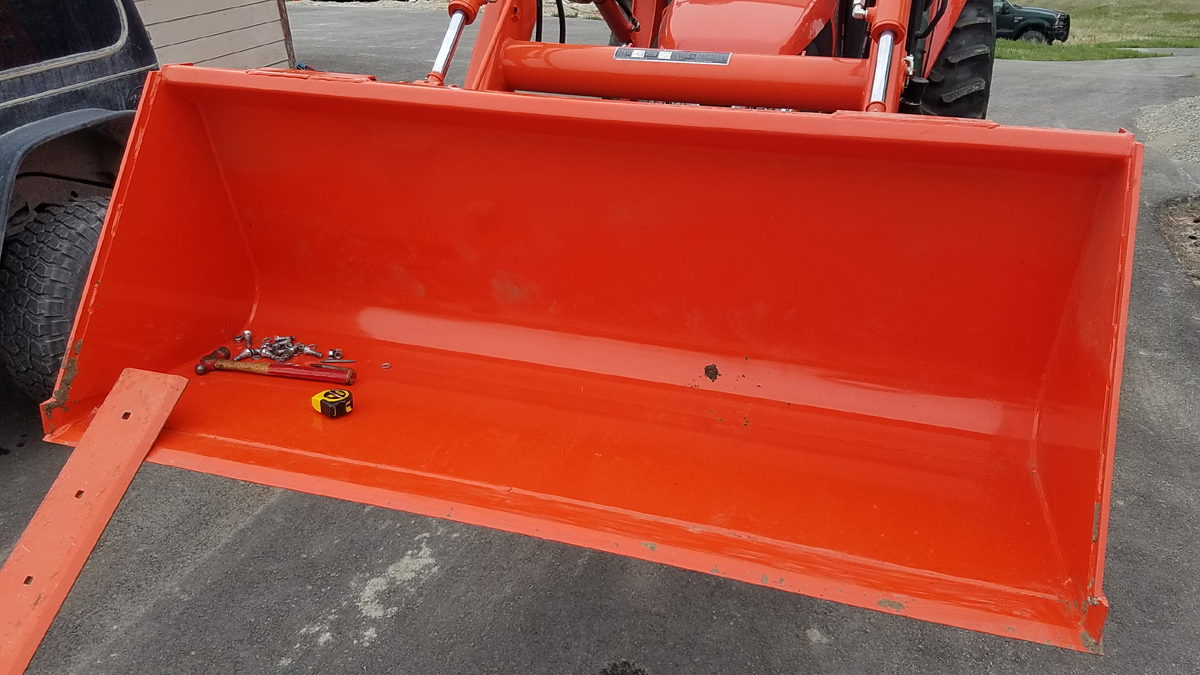

Both of the MX tractors I ordered came with bolt on cutting edges and I think that's a local dealer thing. I ordered an Everything Attachments Wicked cutting edge for the MX so had a spare Kubota bolt on cutting edge. I'm a pack rat for steel so kept it around which turned out to be a good thing since the M6060 didn't have a bolt on cutting edge or any holes for one.

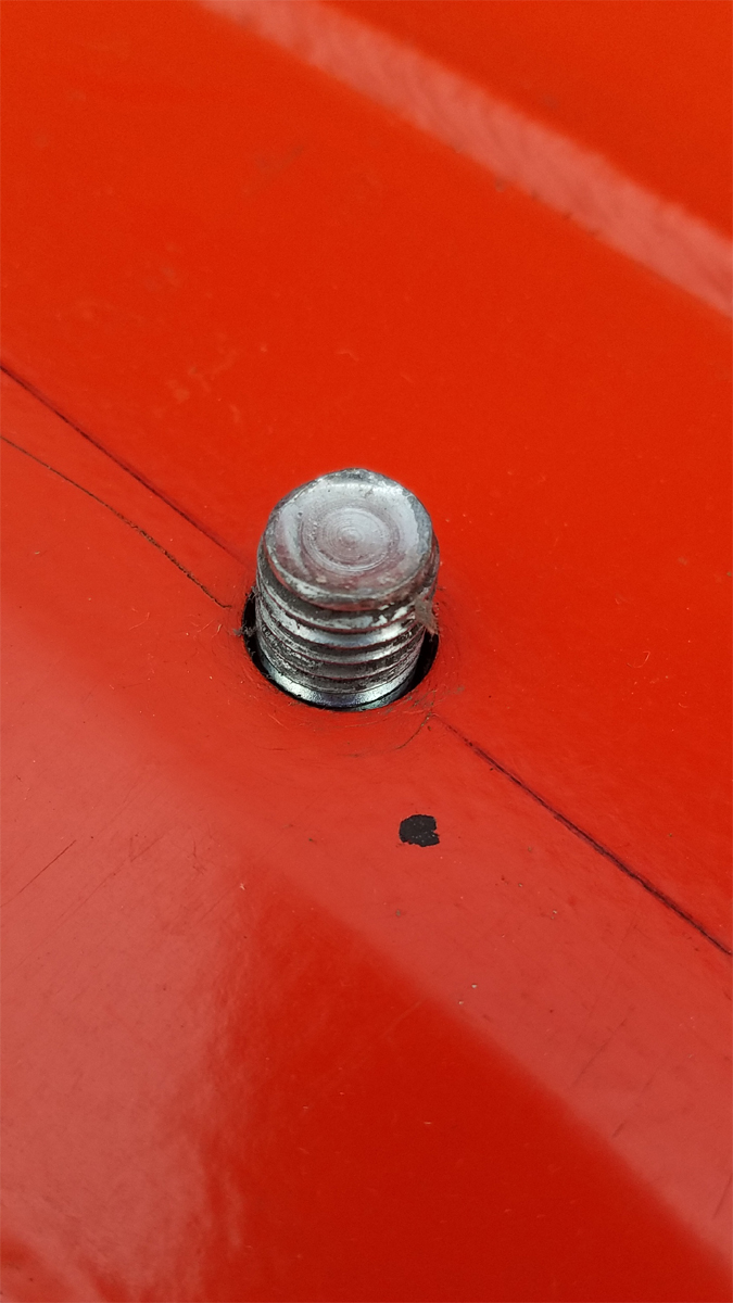

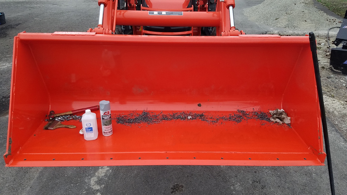

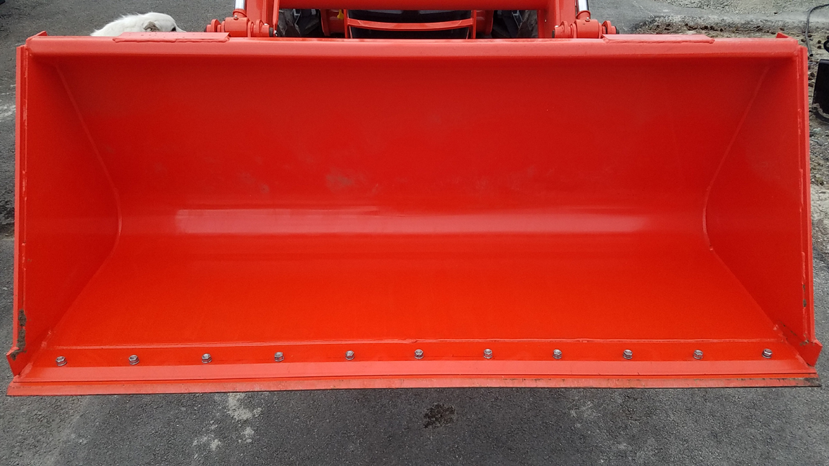

Long story short, a mag drill is your friend for this sort of thing. It'll keep the hole "perfectly" perpendicular to the surface and make alignment about as easy as it can be, not to mention only take about 15 minutes. I had to drill 11 holes through 5/8" plate and that would have sucked. This drill with two sets of cutters and a standard chuck accessory kit was a little north of $1k and worth every penny. I've used it on a lot of projects. I'm surprised you had issues with the mag drill you rented, or the cutting tool in particular. Maybe it wasn't very sharp or you needed to use more cutting fluid, or you applied too much force ... I don't know. But typically mag drills are as good as it gets.

🤣🤣🤣, honestly it was in forward speed, and I think this particular Mag drill is not a very good one. The guy at the rental place told me if the magnet does not turn on grind down the area so it’s fresh metal and it’ll work, so I had to do exactly that. But while useing the handles the mag base wanted to come off the steel with very little down pressure. My Employer’s maintenance department uses them all the time and they work great! But this one I think it’s F*@ked.
There is a welder/Black smith right down the road from me that will do it cheap($50) I can’t buy a crappy drill and bits for that price!
That drill looks very nice and yeah they are very expensive $$$ and rented it because they do cut straight. Disappointed it didn’t work out , But I talked to rental place and they said they would reimburse me! That’s a good rental place, hands down

Talking of mag drills vs. cordless or corded hand drills, it's a tough task to drill 11 holes in 5/8" plate by hand that are optimally sized for a bolt that's intended to have minimum clearance. Keeping the holes on center and keeping them perpendicular to the surface is sufficiently hard that most would need to oversize the holes in order to have bolts line up with the cutting edge. The strength of a bolted connection comes from the clamping force, which is improved if the surfaces of the bolt head and nut are parallel to the bolted parts. If you mark out and center punch the holes accurately, a mag drill will typically give much better results in terms of minimal bolt clearance and alignment.
