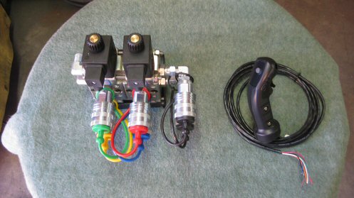

I got a rear remote installed because I wanted top n tilt also. I am using a diverter valve to get 2 from 1 on the rear. This is perfect for me because it's much cheaper than the Kubota set up and I will never need two simultaneous hydraulic functions for the rear at the same time.

I have a single remote, self centering in the rear. My plan was to feed a diverter manifold and run top n tilt with a 12v switch. I have read where some mx series have a problem with a front diverter set up because they have a regen circuit. Is this a problem for the rear remotes also?
I don't think I'll be getting a float for the rear just yet.

A diverter will work fine to add a set of couplers for the rear remote.;)
Might even consider going with a double diverter set so that you can operate 3 separate functions if that need ever comes up in the future. :cool:
