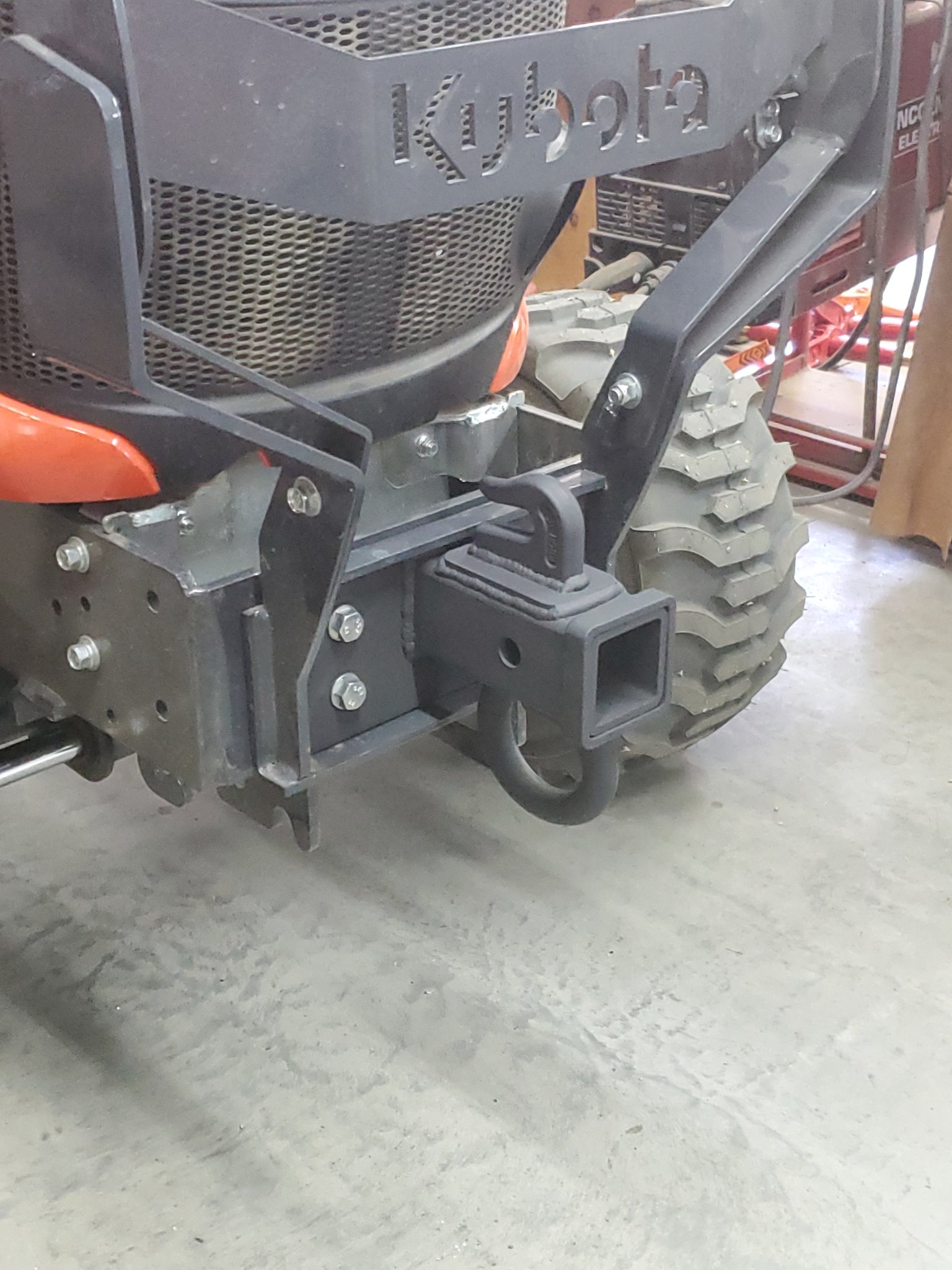

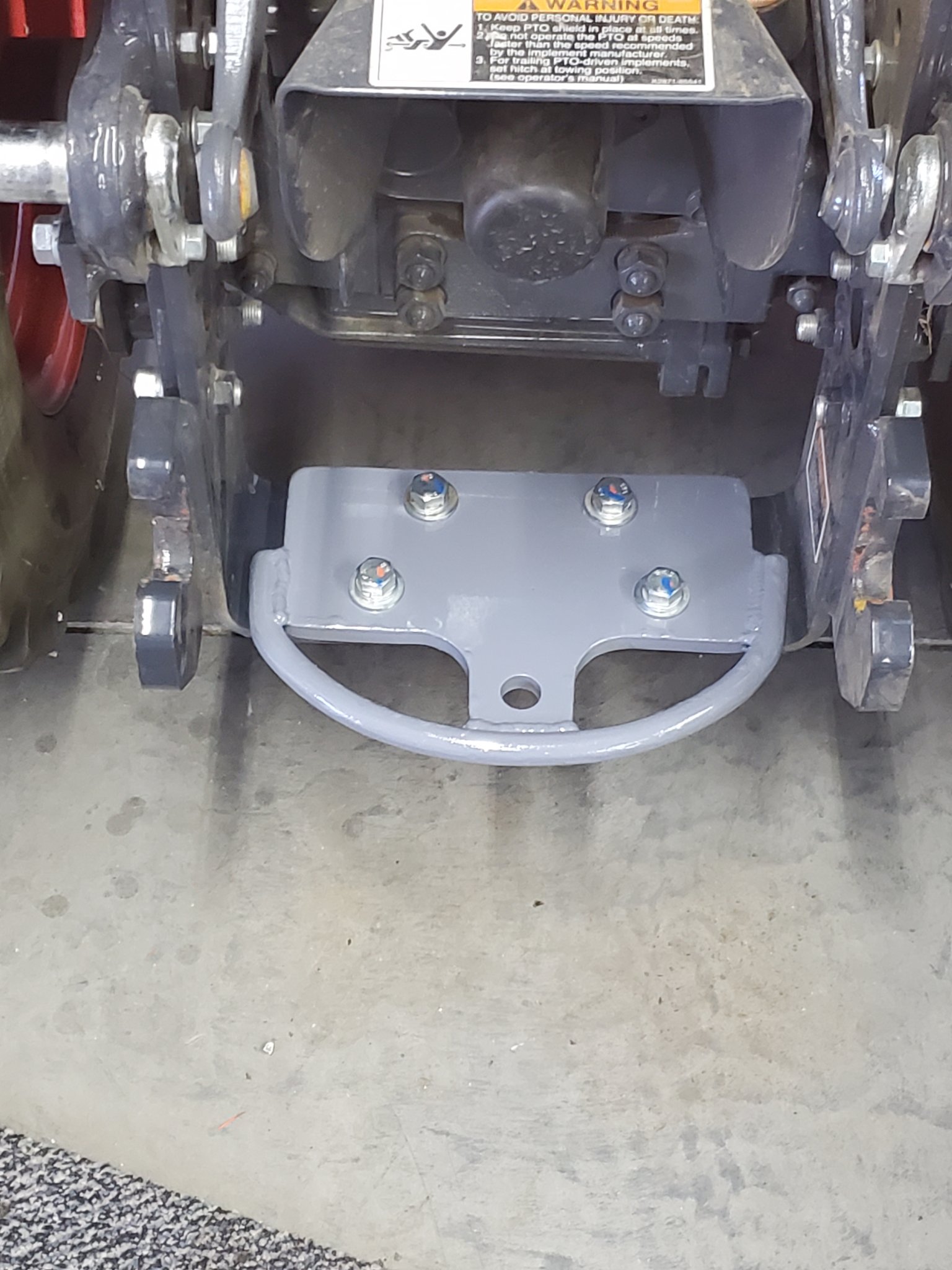

Update: Been over a year. here's what I did for anchorage front & rear. For those that fabricate. This is on BX23S. Front is a 5/8" 5160 steel hoop welded to the underside of a receiver and plate bolted to frame rail with existing hardware. Rear is again 5160 welded to 3/8 A36 plate bolted with existing hardware. included a hole for tow ball or shackle.
