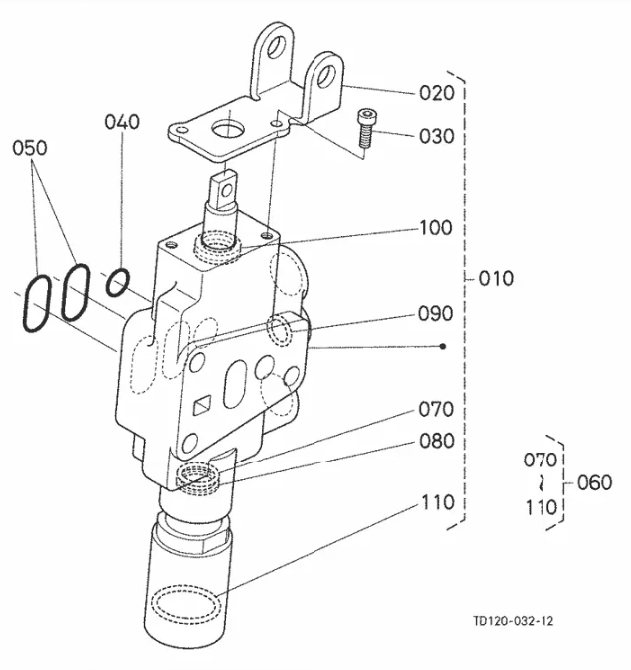

I'm looking at a manure spreader where the web is controlled with the rear hydraulics. Looking at diagrams for the Float valve, it's got a long round cylinder at the bottom - and that's what my 1st position has!
so 2 questions - is my 1st position have float so I can use the hydraulic web as is?
or, if I need to add a second position, what part(s) are needed to order?

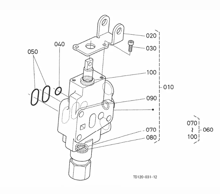

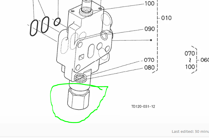

That is a float valve that you have as the detent section is differnt between the 2.
NON Float
Float detent, same as yours.
If it's not locking into float the detent might need to be repaired.
