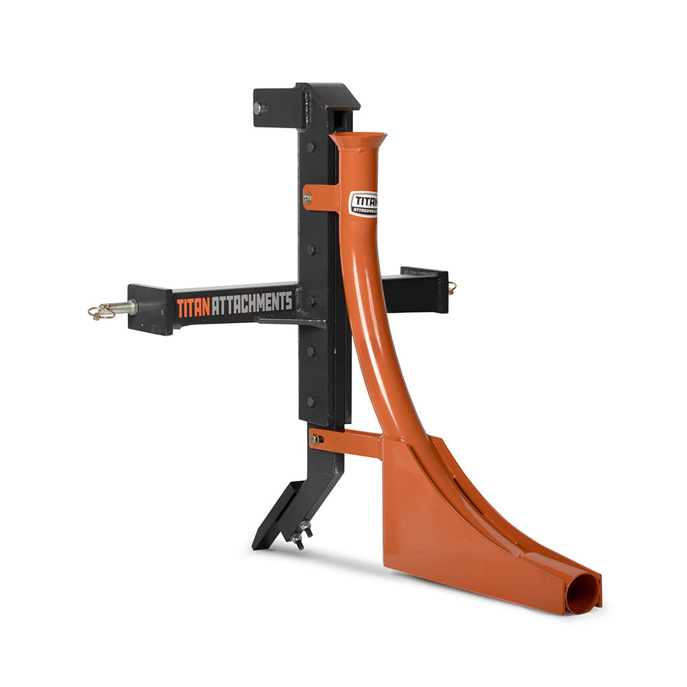

If you think you may have future uses for a subsoiler Titan Attachments has a fairly good reputation.
Their subsoiler is $350 and with the pipe layer adds an extra $140. The pipe layer separately is $200 so you're saving $60 by buying the combo - but still almost $500.

I have never heard of Titan Attachments my worry is it hits a rock and just bends. Tractor supply sells one for about the same price.

I recall some subsoilers have a center beam which is quite long.
Can be a problem for small subcompact tractors, as the 3 point hitch won’t lift the point enough to get it out of the ground, or very little clearance.
Remember it more with BX tractors, but something to look at for your B2650. It is quite a bit larger than a BX.
