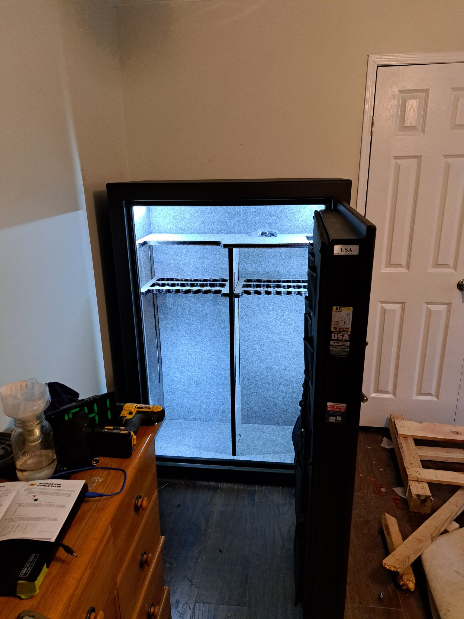

From here on out it was a simple "just use a 2x4 to pry up with one corner and remove a block" situation.
Getting it off the shipping stand was fairly easy as well.

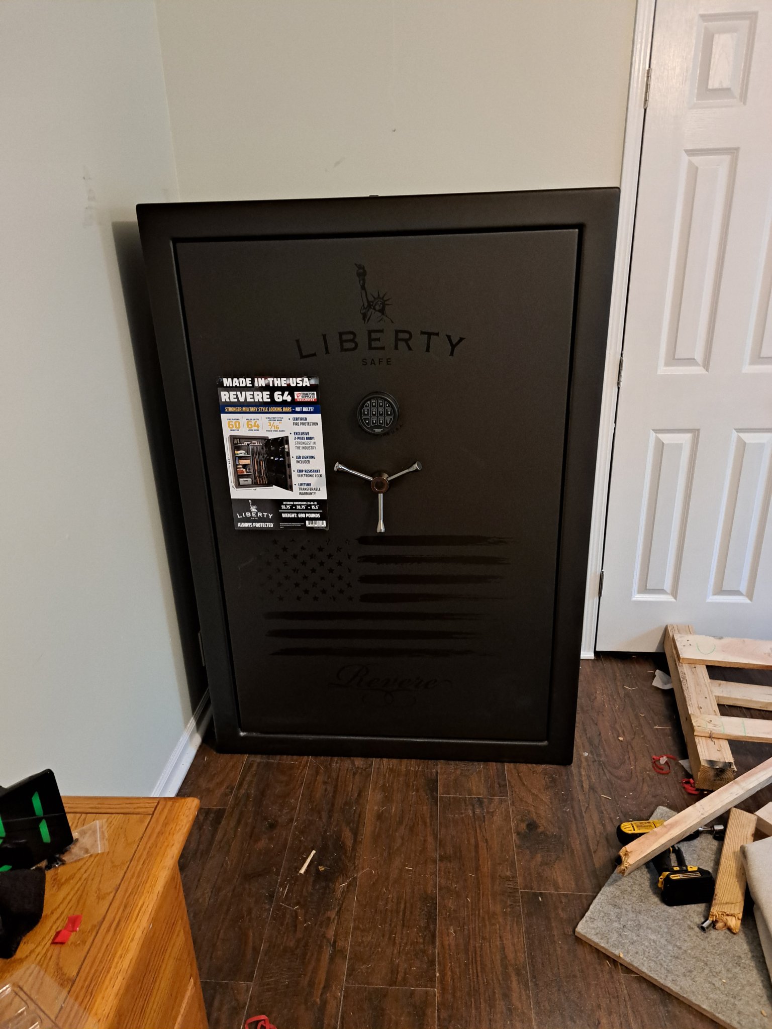

Here she is in her final resting spot.
After this I was cleaning up a little and wouldn't you know it.....I totally forgot that the "giant rug" we use in that room should have been put down BEFORE I bolted it to the floor....DAMN IT!!!!
Oh well, I'll either cut it to fit around the safe or un-bolt the safe and stuff it under there.
And here I though it was going to be a "quiet weekend".... 😂 😂

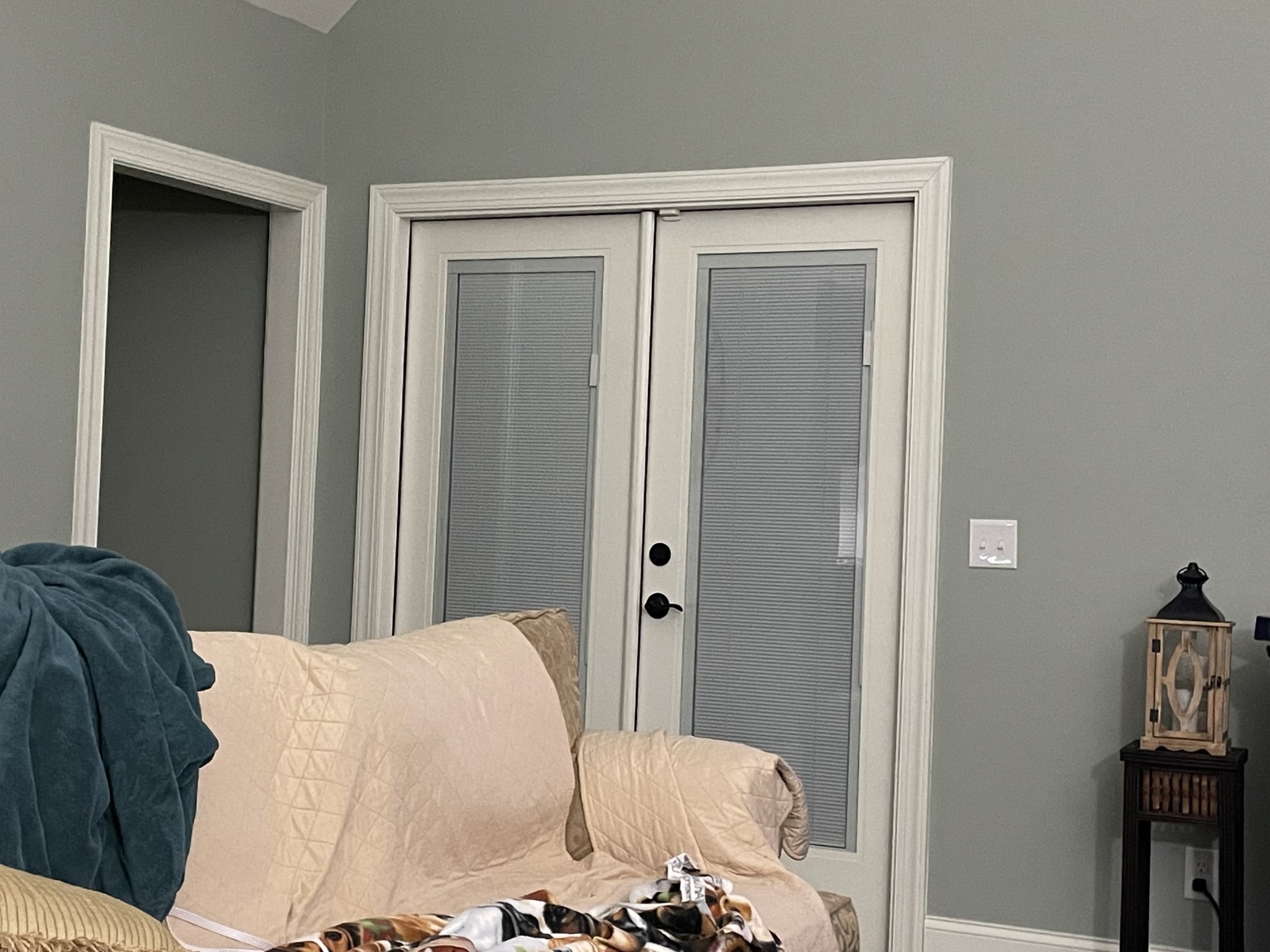

When we built our house, the plans called for 2 x double doors in the living room.
For a variety of reasons, one set was removed and the builder framed the remaining one on the wrong side of the room. When he sent me pictures, I quickly pointed that out and that error was easily corrected. Thank goodness - it’s been a godsend in getting larger items in the house!
The doors are next to the master which was also supposed to have a door to the porch which is where these double doors also lead. That didn’t make sense so we also eliminated that bedroom door to the outside for security reasons.

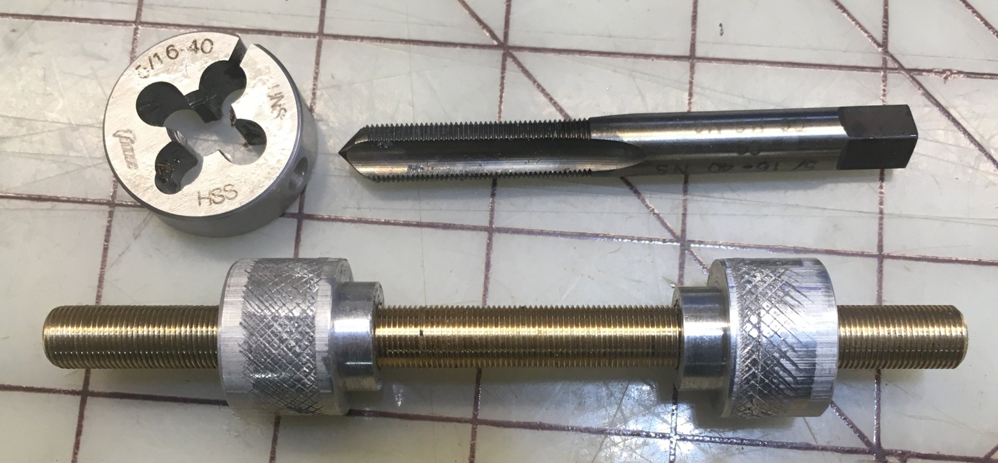

Since you like to make gadgets.....here's something for you.
I've got some more safe jobs to do for my locksmith buddy so I made this "alignment tool jig". When I was tapping the aluminum end pieces I didn't notice they were slipping a little bit in the lathe and I messed up the knurling a bit. But now that the prototype works....I'll remake them in brass.
The two threaded end pieces are turned to perfectly fit the bushing diameter for the front dial ring. The other threaded end is turned to perfectly fit the recess that the drive cam rotates in.
When mounting the lock body to the rear of the door and the dial ring on the front side....using this setup will perfectly align the dial ring and dial shaft with the lock body mechanism.
You wouldn't think it would be necessary to go to all the trouble until you run into a safe that has the pre drilled mounting screw holes in the door off center enough that you can't get the dial ring centered correctly. This setup will tell you exactly where the dial ring needs to be mounted to be concentric with the lock body mecanism. And thus prevents any rubbing between the dial and ring when dialing the combination.
It worked so well that I'll be making a set of ends for some LaGard, Yale, etc. combination locks too.
Here's the alignment set:

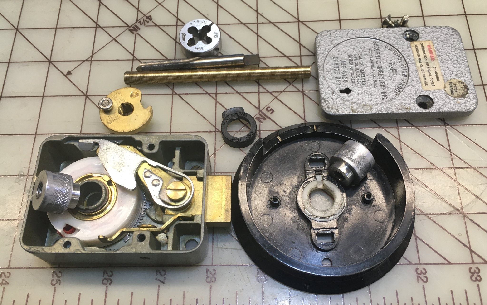

And where the ends get held in place by the threaded rod when mounting lock body and dial ring to the safe door:
the white nylong bearing insert in the dial ring was badly worn. I'll be replacing it with the new black one in the middle of the pic.

Great minds think alike sir!
I started making mine yesterday.
The tool was a hundred bucks plus shipping but it does not look that hard to make.
