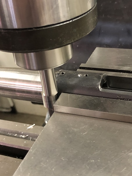

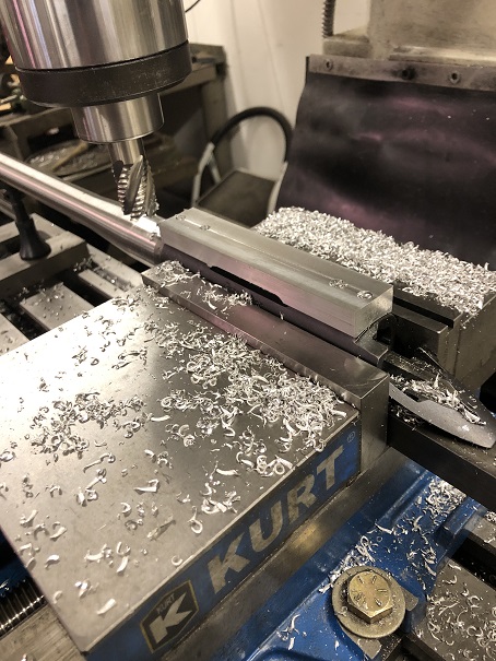

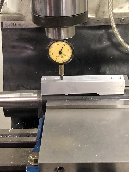

Touching 90 degrees today with dew points in the 70's. Great day to stand in front of the mill with the a/c blowing on me!
I cut a relief slot on the bottom of the rail for the ejection slot on the action.

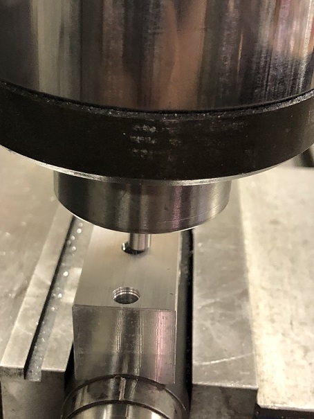

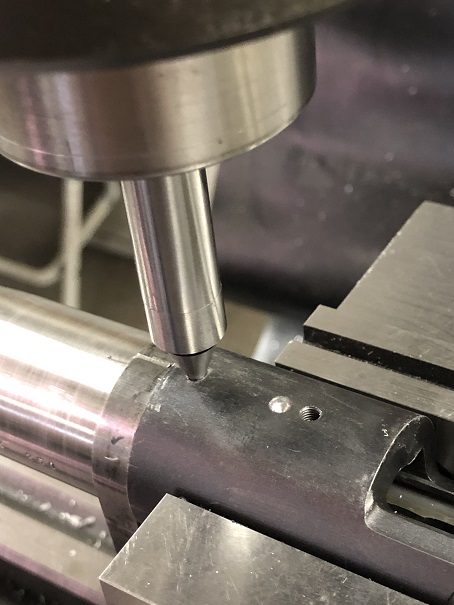

Then I clamped the action (with the barrel this time) in the vise and using an edge finder determine the center.
Then using a pointed edge finder I rotated the action until the mount screw holes were centered with the table locked on zero. I thought this would be the best method but I would soon find out it wasn't.

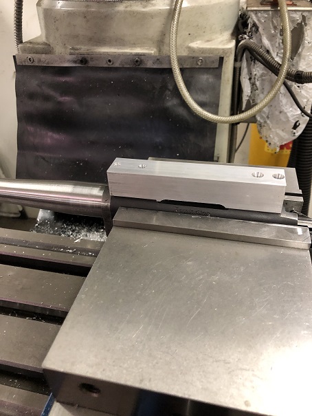

Mounted the rail block on the action and torqued down the screws. Now I'll let it set there for a bit to relax in place so to speak.

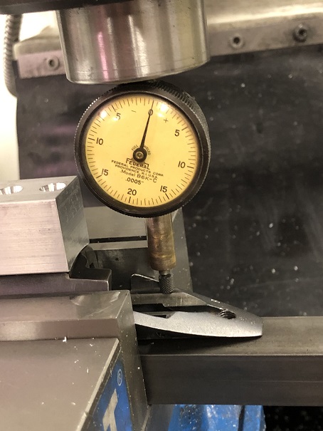

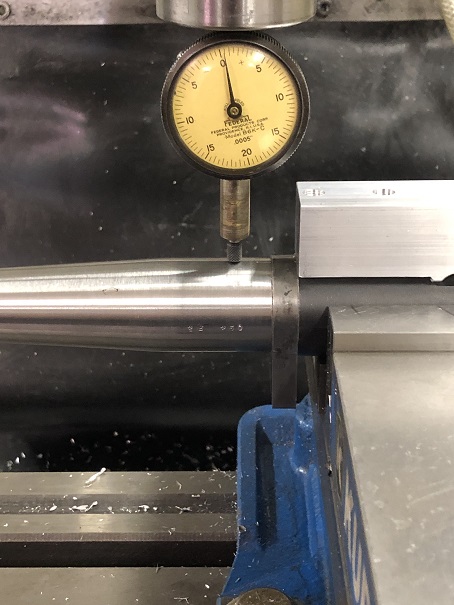

So now I'm at the point of sweeping the surfaces with an indicator to check my setup. I check for parallel with the barrel and its perfect!
But when I sweep the block I notice that the holes offset from the indicator.
So I put a .25" dowel in a collet and check for alignment with the counterbored hole.
Uh oh! This isn't cool. So I use the dowel to center the hole and start checking everything with indicator. I also check the block with the edge finder and it is still off center at the top by .010" So I start looking for another surface to establish center.

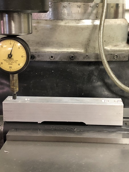

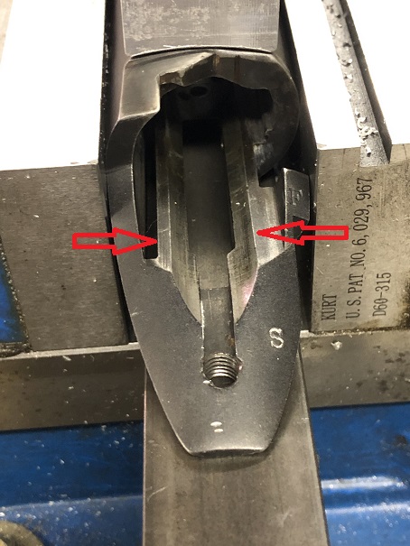

So I decide to try the flats for the bolt lugs on the bottom.
I sweep this with my indicator and get these to zero on both sides.
Then I check the block for center with the edge finder and it is .001" within center. Bingo! I also sweep the top just for the heck of it and it is only about .004" from end to end. Time to start machining.

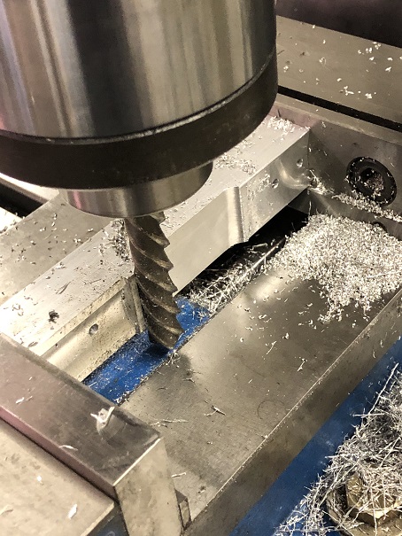

I did the roughing of the surface and will return after letting it relax to start the final.

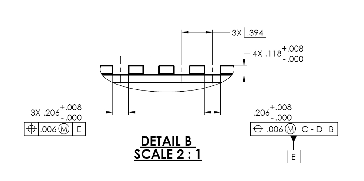

It will be picatinny. As many as I can fit between the mount holes.

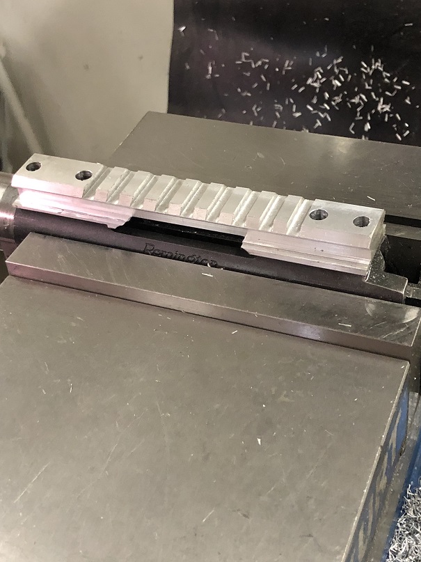

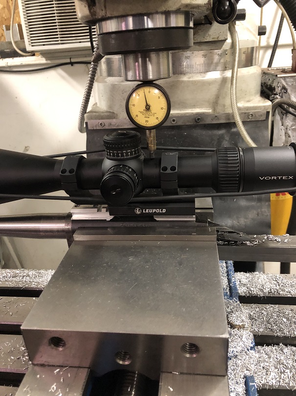

Finished machining the profile and the slots.
Then I mounted the scope and checked for its position relative to center. Came in at .003" which was way better than I anticipated!
I checked it by sweeping back and forth across the tube and noting where it hit the same number on the rise. I found this to be more accurate than the dwell at the very peak of the tube. This one is done!
