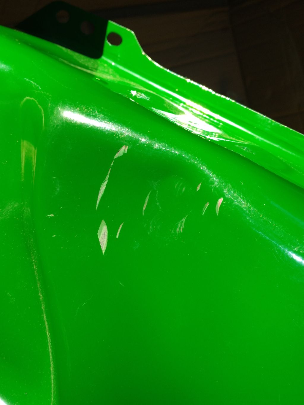

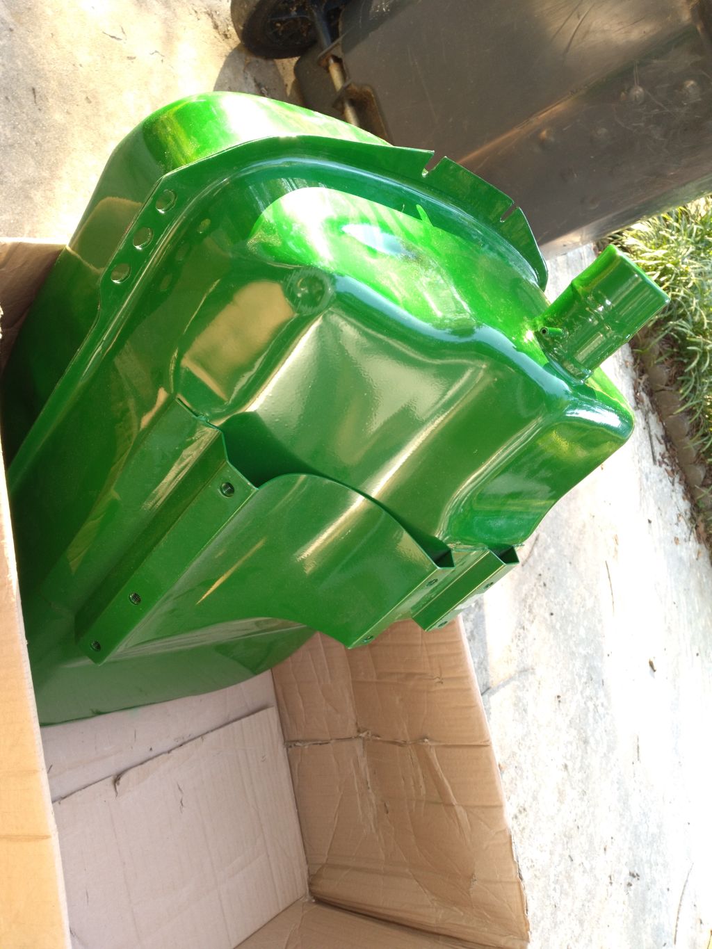

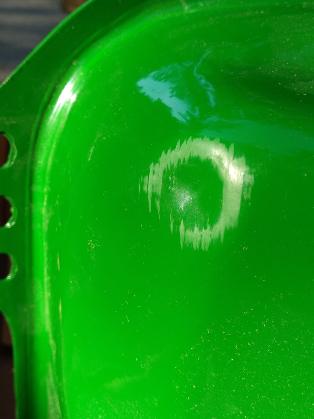

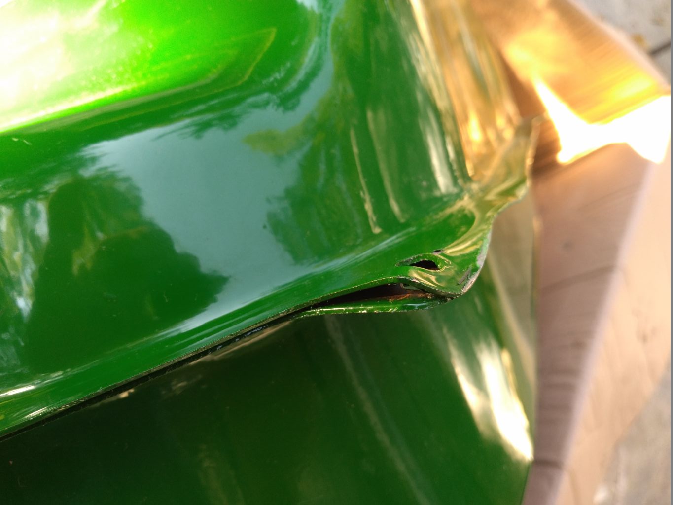

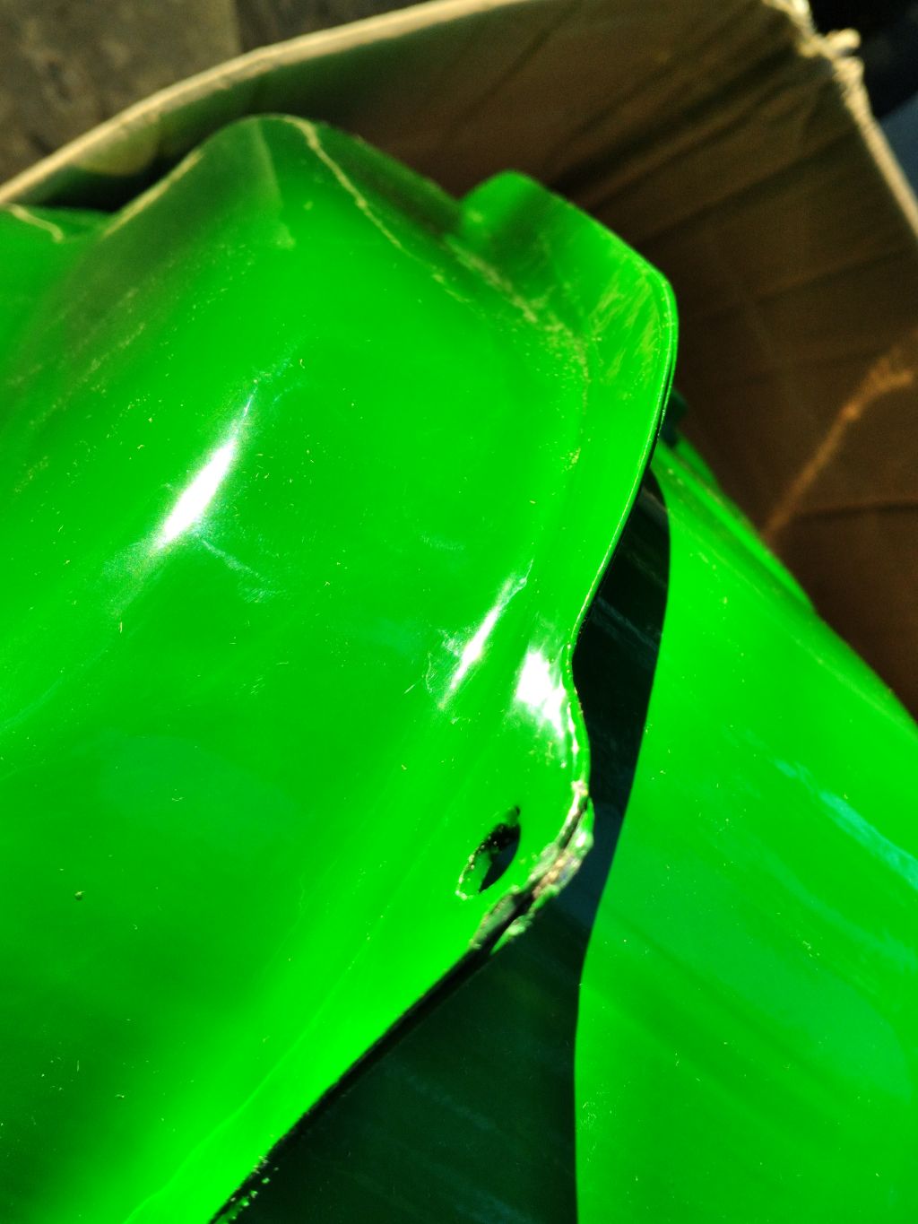

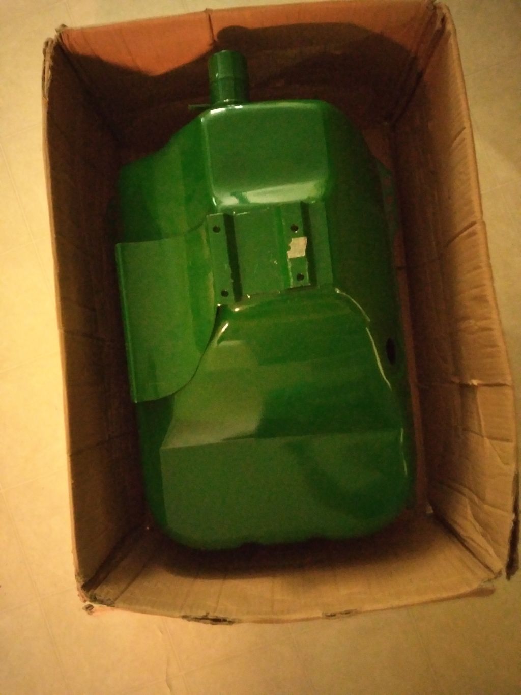

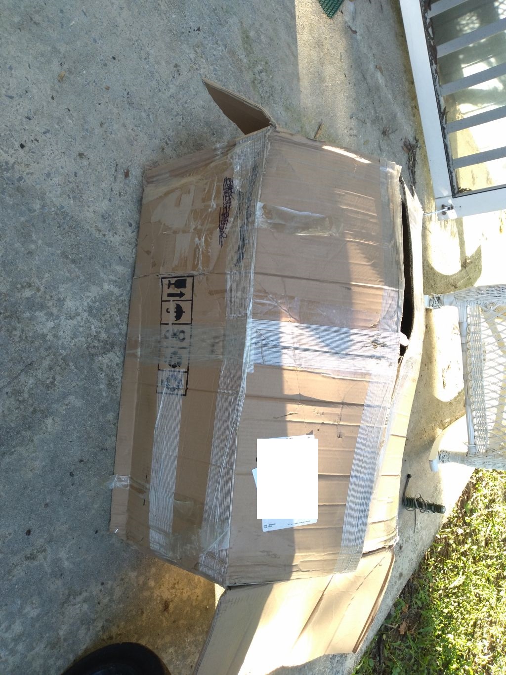

I have an old John Deere 2030 that I only use to pull a rotary cutter to cut my place a few times a year. The tank started leaking last year and it is rusted out pretty bad. I finally found a metal aftermarket. They have been unavailable a while. $566 after tax and shipping, but I sucked it up and paid for it, glad to maybe have a replacement. Well, it shows up today in a thin box, too small, no packing. The tank was dented, but I was more concerned about the edges. I thought about keeping it, but I'm worried about a new tank leaking. I know it is not acceptable. What do y'all think?

That crack in the seam seems pretty questionable. I would be sending pictures to the seller and seeing about getting it replaced.

I wouldn't run it just out of principle. But if there is an issue with the seller you can always water test it first to make sure it will hold fuel. Plug the holes and give it a little air pressure using your hand as a seal ao you don't pop it.
Or, they make a product called red coat that you can use to line your old tank to buy you time. Sort of like adding a rubber liner to it.

Yeah, that's my thought as well. I really don't care about the dents. But, the hits it took on the seams has me worried about leaks. I've pretty much resigned myself to sending it back and contacting the seller. I just don't understand how something could have been packed so poorly for shipping. Inexcusable. Nothing surprises me anymore, and it seems indifference has only gotten worse with each year.

Did you notice the box it came-in..? Was the box damaged also..? Did you get the delivery-service to observe the damage…?
If the box were damaged ….the seller of the tank will likely suggest to you that you should be making a claim against the freight-service, etc.

A couple trash bags and a can of expanding foam would have solved the packing issues for the seller 🙄🙄🙄

Defective/damaged!
Get rid of it!
Send it back, for full credit!

Many times the shipper will refund your money and not want the damaged item back and tell you to dispose of it. If that turns out to be the case, then you can sandblast the seam, have it brazed shut, and slap a coat of paint on it. Let the shipper decide if they want it back or not, since the shipping is on them, not you.

It was in a carboard box that was too small for the tank and the box was very thin. The edges of the tank had cut through the box. There was no packing material in the box. There were many ways it could have shipped safely, and that was not one of them. It should have been overpacked with another box at the very least. It comes with a fuel cap, drain valve and fuel line valve, which were in the box. I could tell those were in a bag taped to the tank. But the bag they were in was obliterated and the parts were loose in the box. How they did not fall out was a bit of a surprise to me. I'll contact the seller for a return. If they told me to keep it, with a refund, I certainly would try to use it.

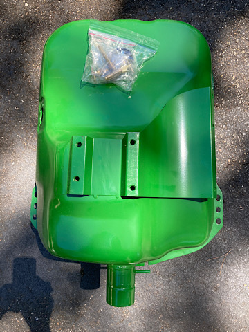

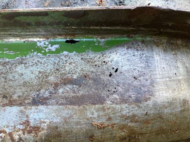

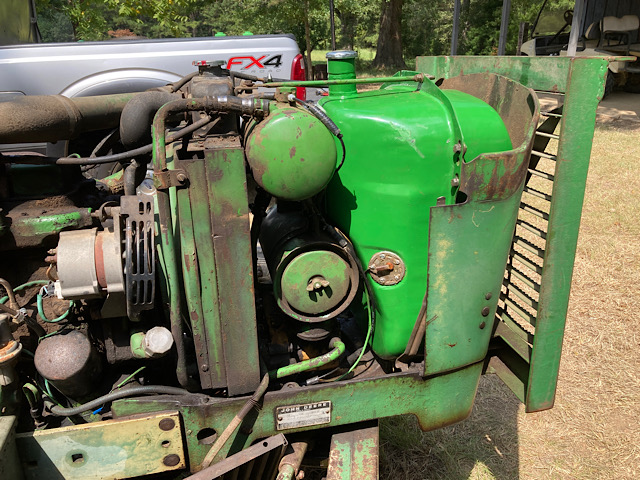

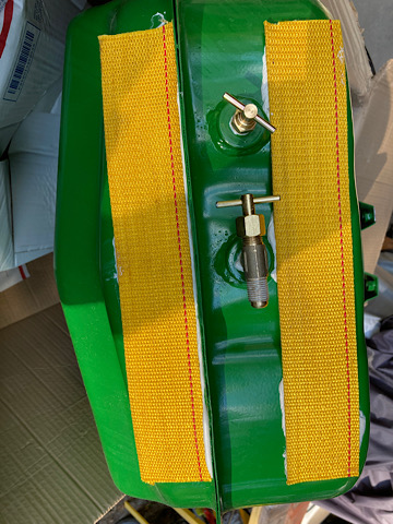

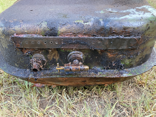

I just finished a very similar situation with my 1974 Green JD 1530. The fuel tank developed a leak so....
I pulled the tank last Saturday and after wire brushing found...
A good size hole in the upper painted portion and also multiple pinholes where the tank contacted the tractor frame. I considered using that "inside of the tank" sealer but after 49 years I felt that replacement was the answer.
I ordered the new replacement tank Saturday and it arrived Wednesday. I was concerned about shipping damage but thankfully it arrived with "narry a scratch".
I cemented webbing to the tank bottom to protect it from rubbing the tractor frame.
And completed the install this morning. Out one Saturday, ordered, received, and installed in one week!!

'return to sender'......
damaged goods, they need to replace or refund, bonus if they say keep it.
Even IF the seem doesn't leak now, it probably will after a few long hours in the field.
If you do get it for free, take to a 'rad shop' have them inspect and repair.
