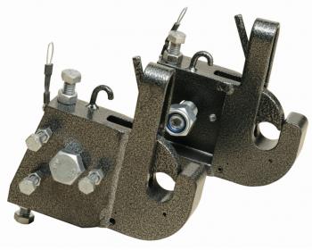

Has anyone tried the Fiel Tuff quick attach?
Would be nice if these came weld on as well.
Upon further inspection, these are one sided which might be an issue bending the bolt.
I am also not sure they latch automatically, might have to pull latch back while attaching.
Can't find any info on how they operate.
