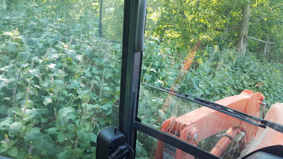

I have the 72" mower on my L3560. When we first started mowing, here are some pictures of what I was mowing through.
Obviously, you are not cutting this at 5mph, but more like 2mph and the grapple low feeling for hazards. Yet, the tractor and mower did it just fine.
