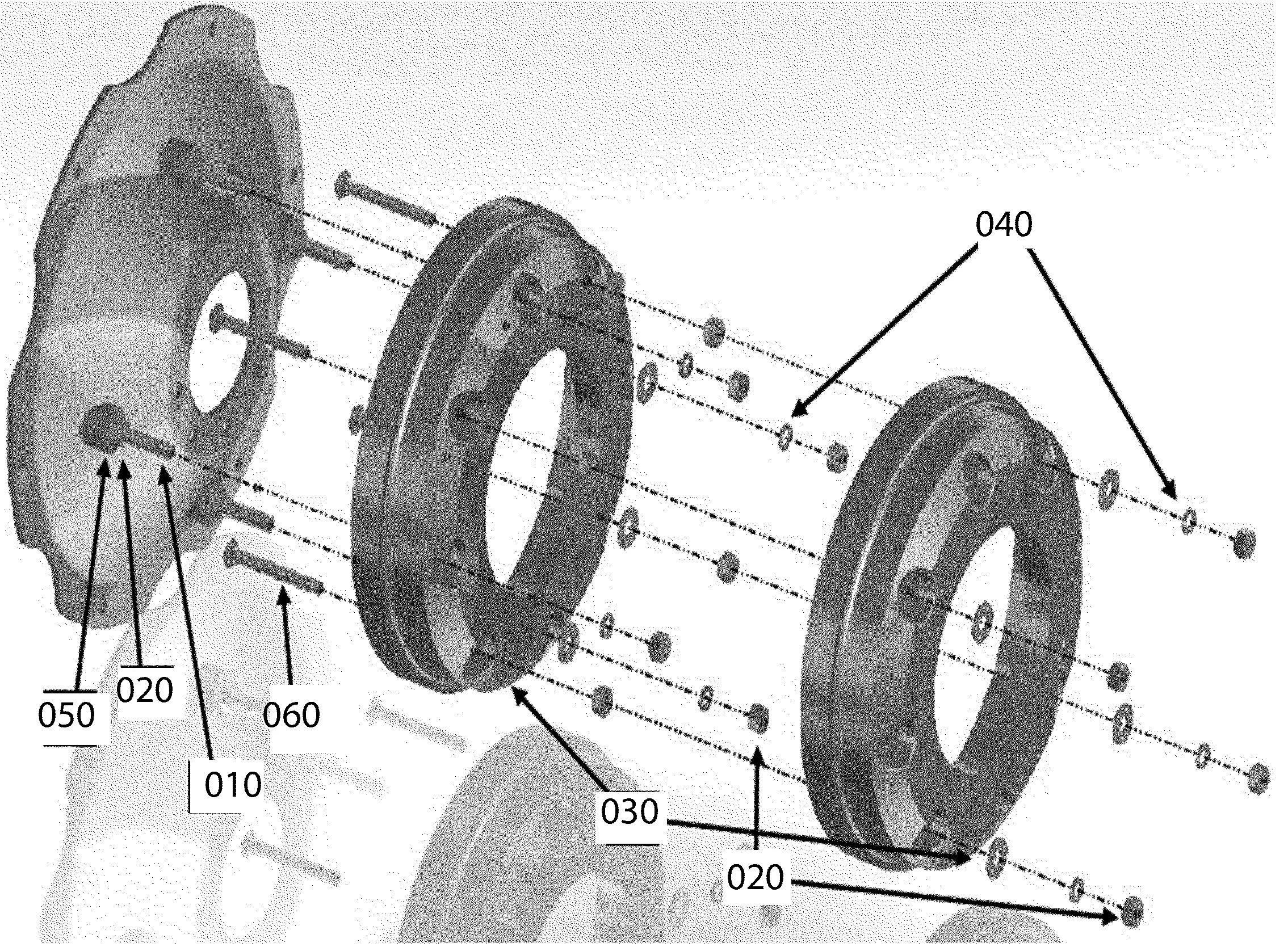

Wheel weights would get you 990lb. That's what I added to my M6060 along with beet juice in the rear tires.

Second on the Wheel weights

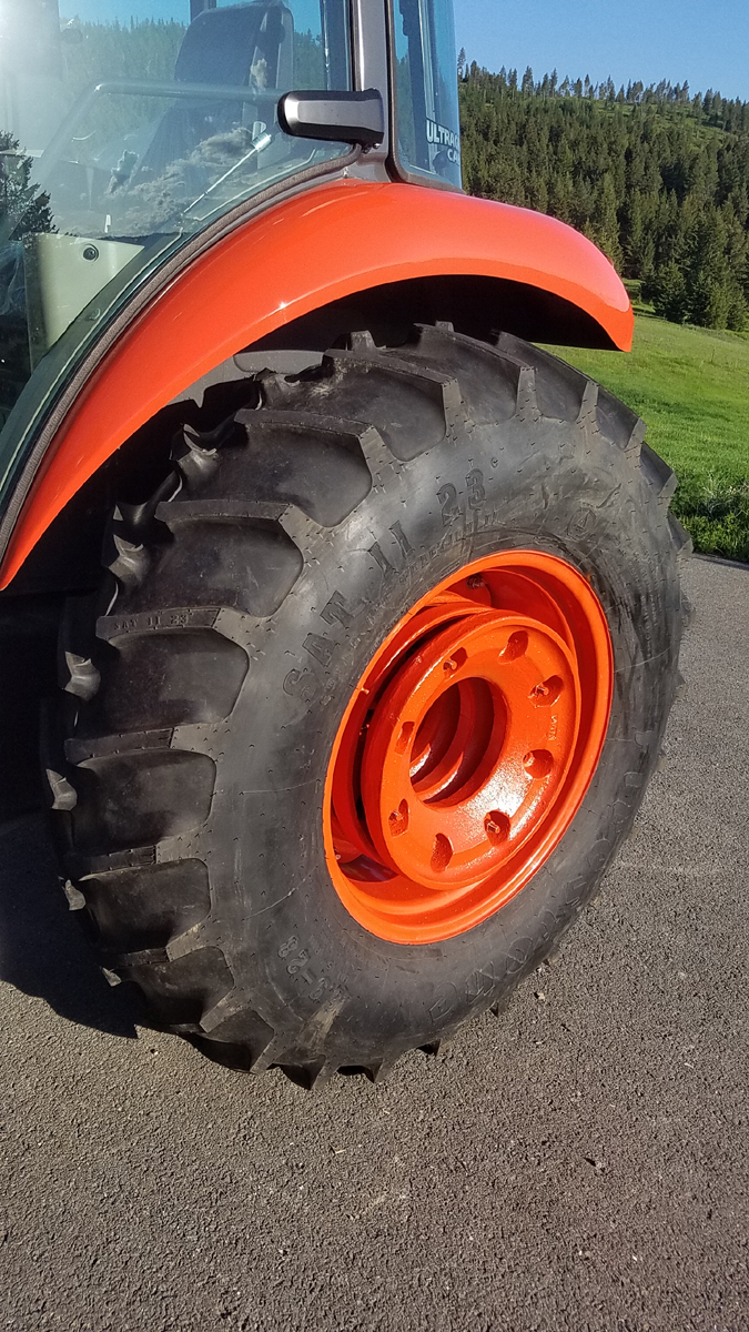

If cast wheels were an option for my MX, I would have gotten those to add a little more weight than the standard rims. I am not sure but I would suspect those are still an option / available on a larger machine like an M. If considering new rims / tires is that an option you are considering? I think you can still fill and add wheel weights with the cast wheels. I am not sure that gets you the extra weight you are looking for but it might help? ☕

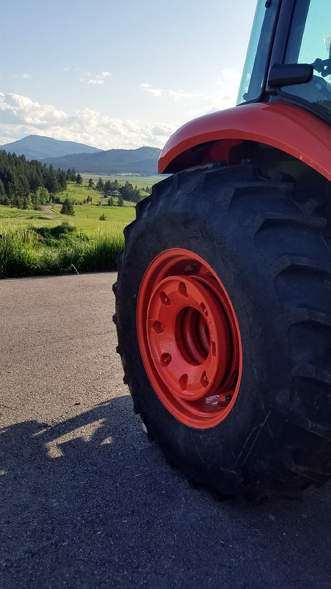

How much do those cost? Are they available from someone besides Kubota? Got any links to that setup? Thanks for the pics and info.
I got wheel weights for the MX and M through Kubota but there are likely cheaper options. The M uses weights with Kubota part number M8126A. Everything Attachments used to have a good selection at decent prices but that's no longer an option. I bought over 1,000lb of suitcase weights from them for close to $1/lb which included shipping.
