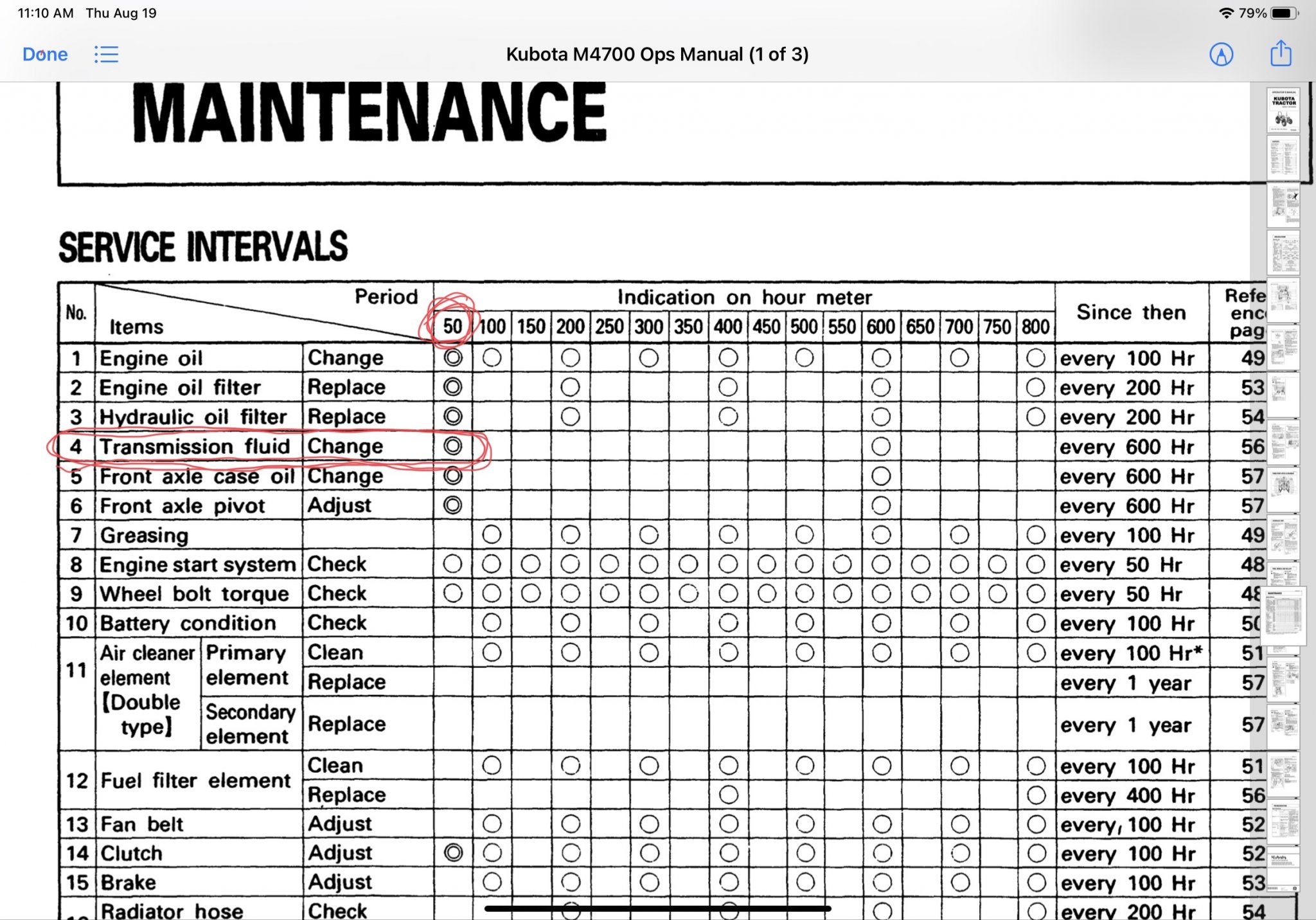

Your Owner’s Manual is your friend. It may tell you that your transmisison fluid also serves as your hydraulic fluid. Are you sure your manual doesn’t specify the fluid being changed at 50 hours..?? Mine does:

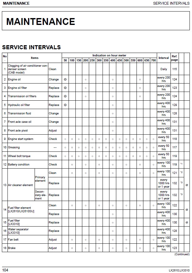

Its on page 103/ 104 of your owners manual.
Its the same as the b2650 for maintaince and if you want to change fluid then go ahead its not going to hurt it. I did not change mine at 50 hrs.
To put more confusion into it the service manual for my b2650 says to change the fluid and filters at 50 hrs but the owners manual says just change the filters. I dont know what the lx2610 says but it may be the same.
