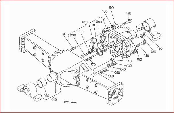

Getting to the front pinion shaft coupler will not require the front end to be disconnected.
Pull #90 (bolt) should bolt to oil pan??? or other location, then slide #80 (cover) back this will expose #10(coupler), that coupler attaches to the Pinion.
Here is what the front axle and diff housing looks like

Pulled the cover back and the shaft is spinning when in 4wd. I guess that means the problem is deeper inside the pinion. :(

Ok, I get it now. After staring at the parts diagrams for a while I went outside and turned the front wheels manually while looking at the coupler. I can see it shake like it wants to turn and then slip. So I'm guessing the teeth are broken on the coupler.
