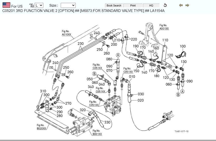

I’m considering installing a 3rd function kit on my M7060. Dealer wants $ 300 to install plus $ 400 for transport fees ( 1 hour drive to/from twice). I’ve Been told that the kit includes limited if any instructions.
Any advice would be greatly appreciated.
The parts diagrams are online so you can have a look but the valve is pretty substantial and a bit more work to install than the after thoughts used on the smaller machines. The plumbing to the front looks like it might require some time. However not a massive undertaking or complicated but personally I would jump at $300 labor. The $600 hauling on top of that would be a deal killer for me but I am a cheapskate.
