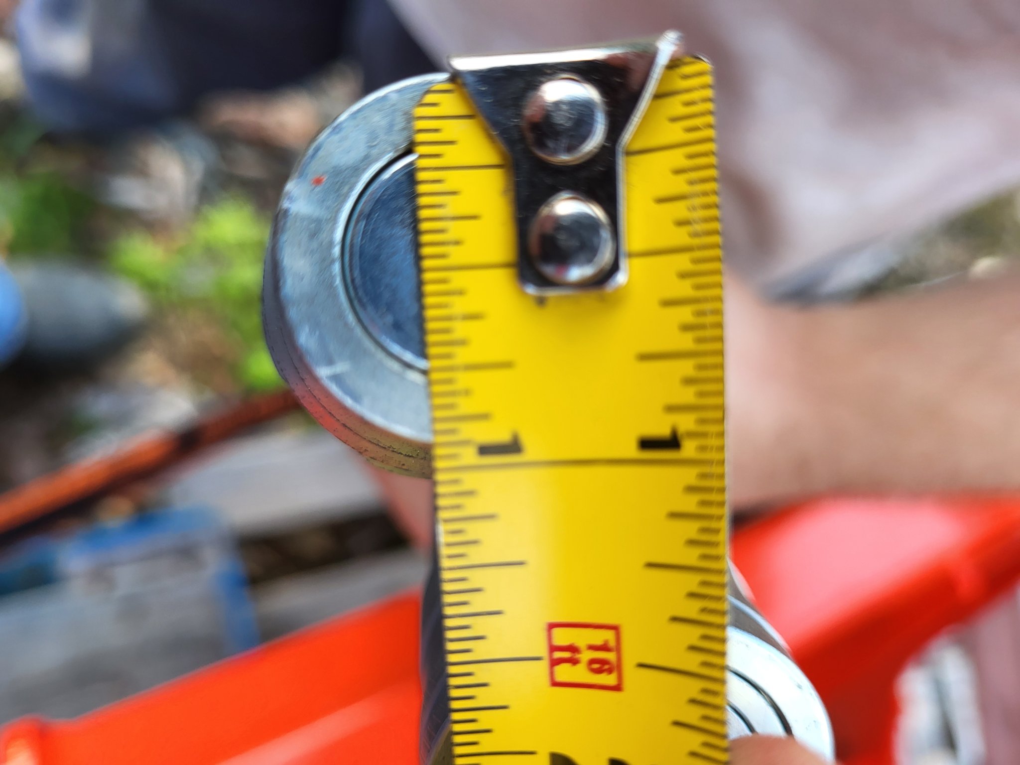

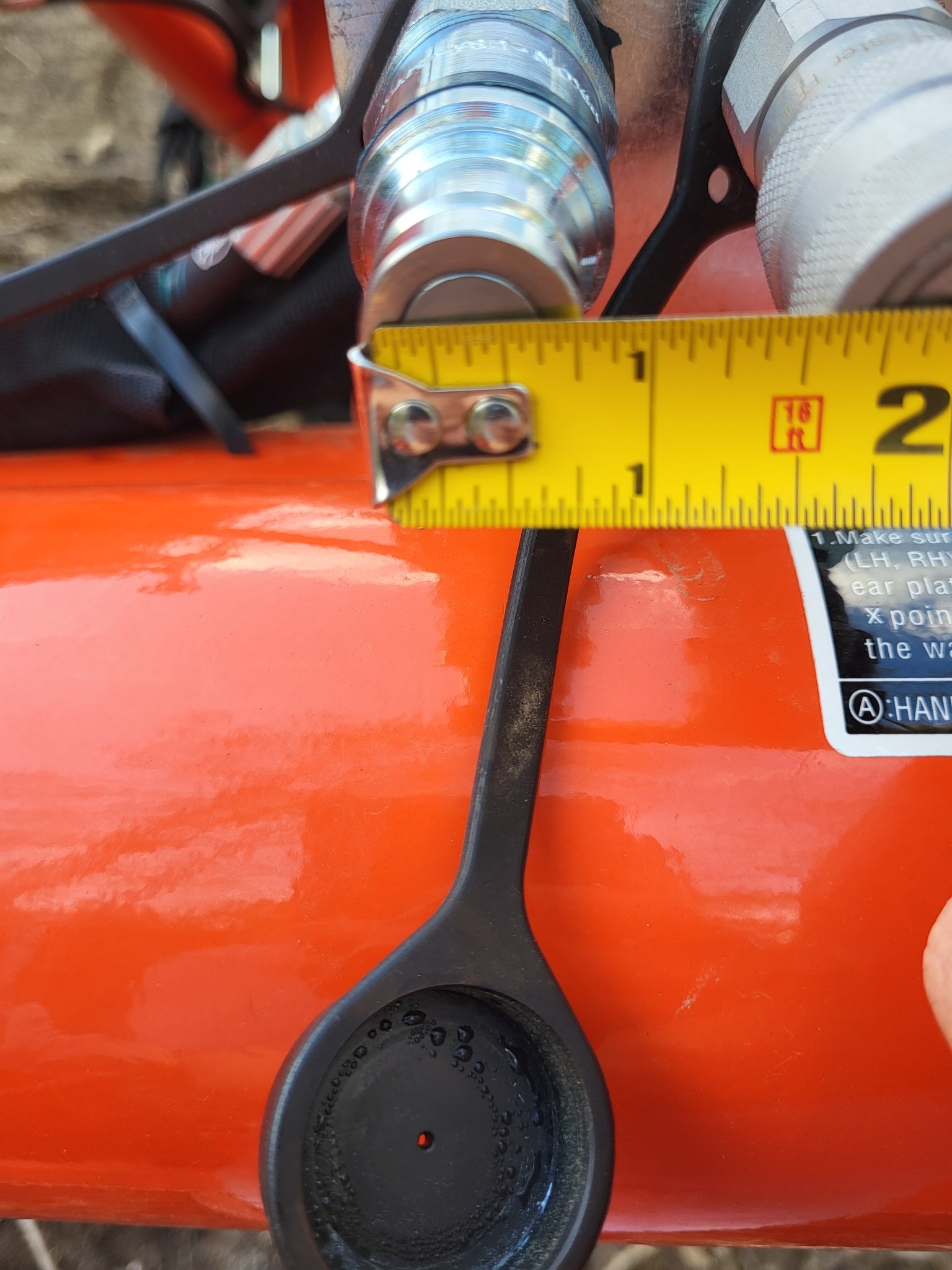

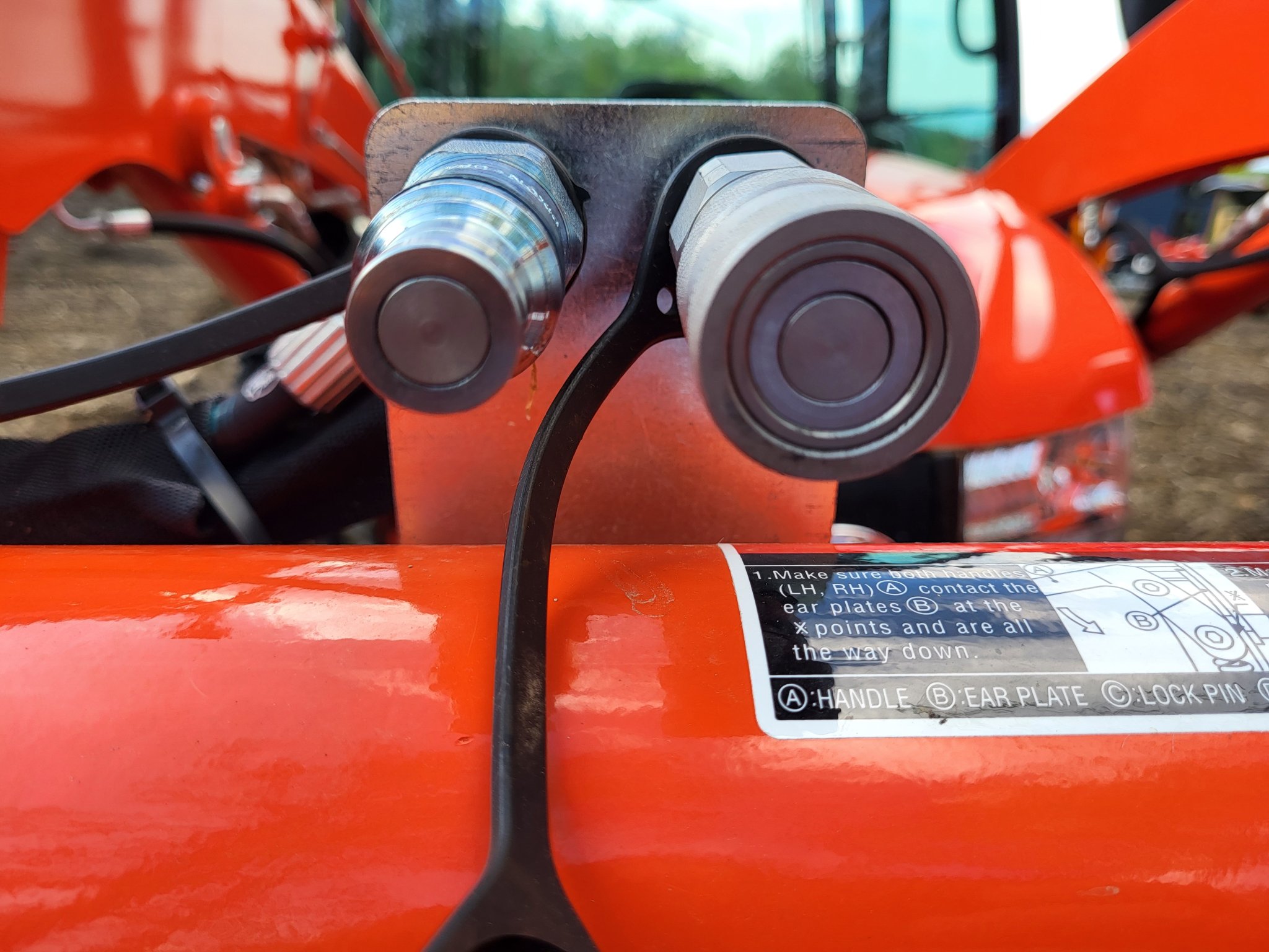

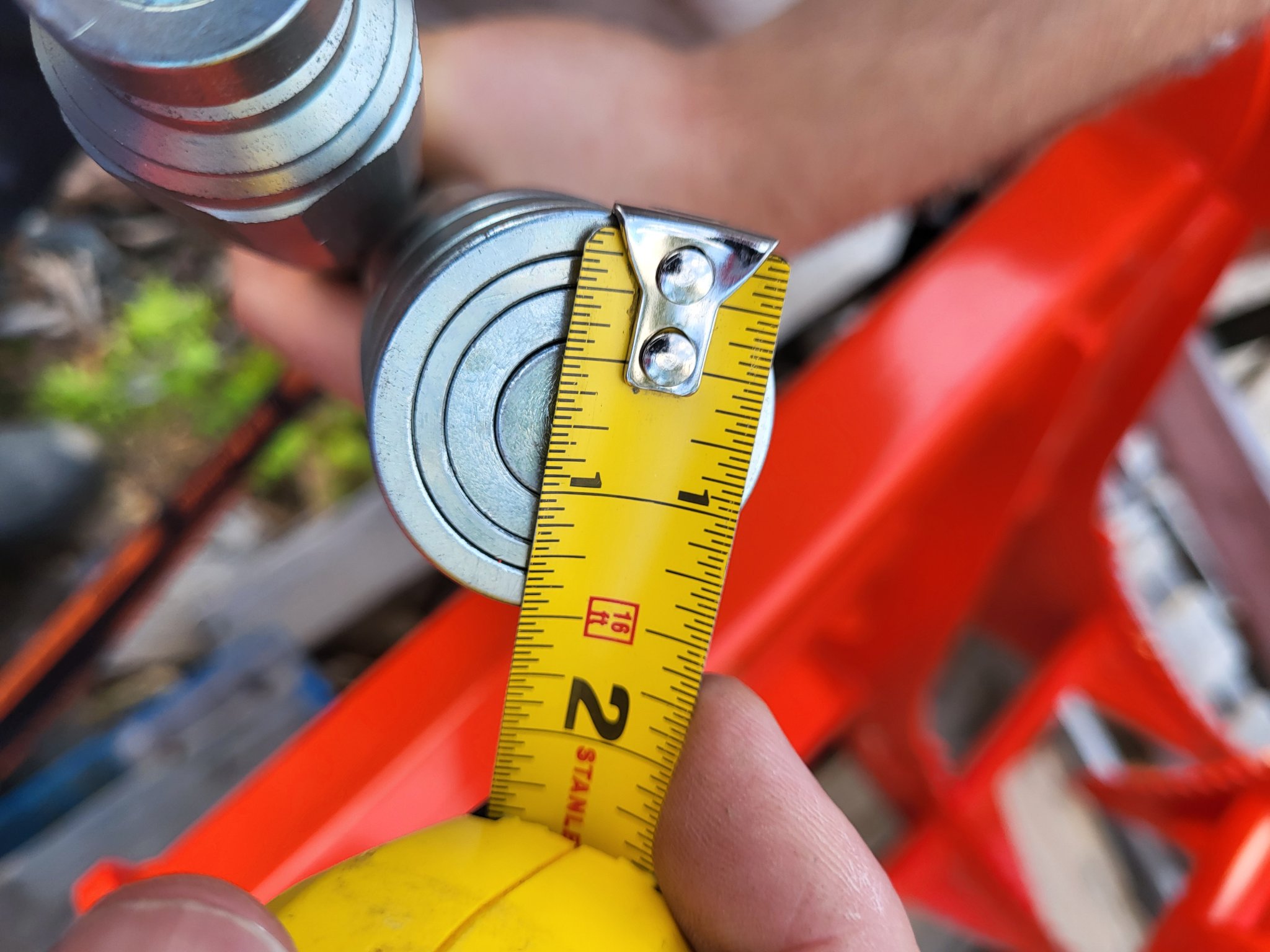

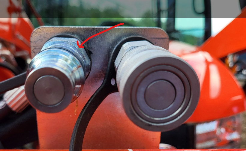

I grabbed some measurements and pics today. For me, the question is what connectors would future 3rd function implements likely have? I am happy to change out either end hoping to be compatible. First pics are tractor side. 2nd set are grapple side. Thanks as aleays for your help gentlemen.

The tractor side is 3/8" body size and grapple side is 1/2" body size.
Most vendors let you choose what you want on the implement. I have already expressed my opinion. Unless you also have a skid with higher flow hydraulics 3/8 is appropriate for a compact tractor with <10 GPM hydraulics.

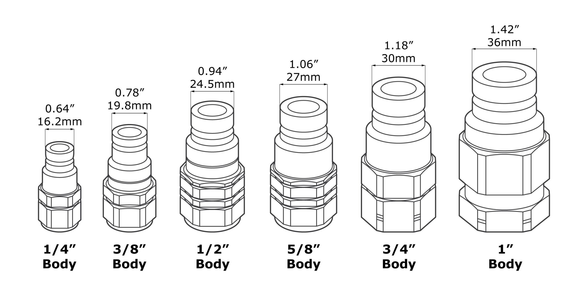

Hydraulic couplers are classified by "body size" which is indicative of their "nominal" rated flow rate. All the industry standards do is establish the physical dimensions for the male plugs. And even that is limited to the mating surfaces. The rest is left to the OEMs that actually make the couplers.

I cannot speak to JD and NH but I am quite familiar wirh Kubota. Kubota generally uses couplers with female NPT ports and hoses with JIC female swivels. There are exceptions.
For direct hose connections the hoses have male NPT ends that screw into the couplers with PTFE tape.
The couplers shown in the OP's picture are bulkhead mounted using a male JIC to male NPT bulkhead fitting. The hose has a female JIC swivel that attaches to the male JIC side of the bulk head fitting and the coupler has a female NPT port that screws into the male NPT end of the bulkhead fitting.
Couplers on loader valves have female NPT ports that connect to hoses with male NPT ends. Valves have female ORB ports, valve mounted nipples have female NPT ports, and they are mounted using male ORB x male NPT adapters.
Aside from the high dollar remote couplers and sectional valves on the larger M series machines I have never seen Kubota use JIC or ORB couplers. I really wish they would but the dont.
I am not from Missouri but please show me all of these JIC/ORB/ORFS couplers on your Kubota machines.
