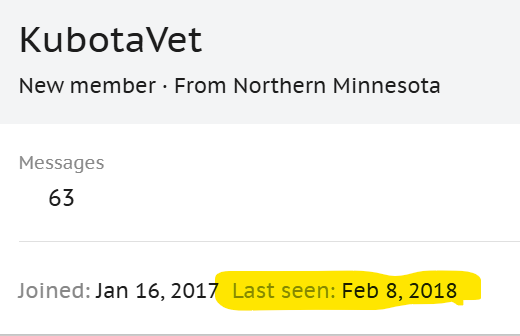

I know this is a very old thread, BUT #KubotaVet, how is your camera system for 3pt snow blowing going years later? Was it a good option? Have you been happy? I think I'm going to go 3pt for a snow blower as I assemble my spring Kubota purchase....
36,156
11,086
Don't hold your breath waiting for a reply:
