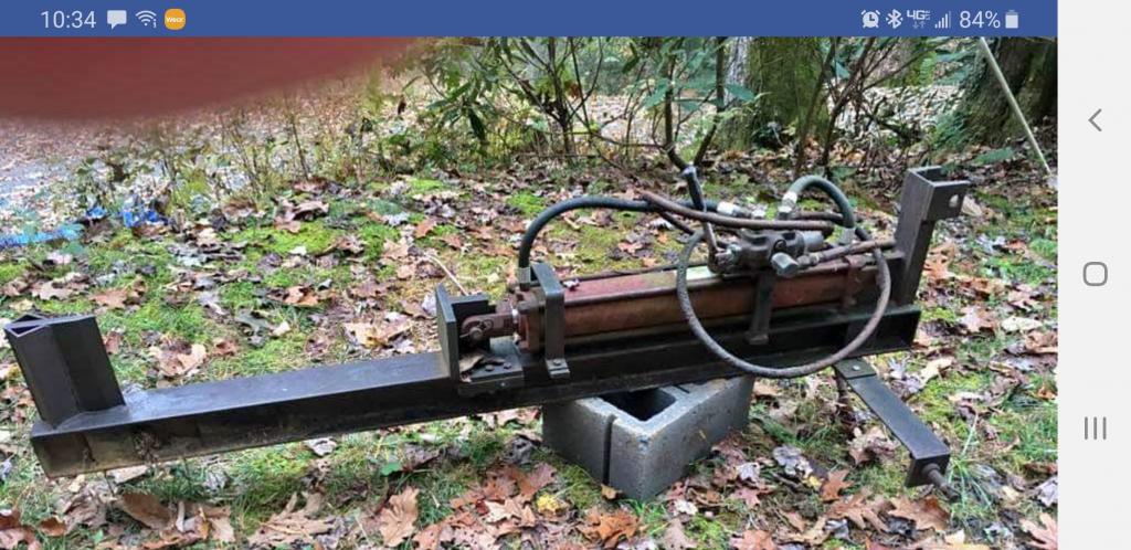

I'll begin with saying I know the pros and cons of these splitters. This will be very occasional use.
I found this splitter for sale and haven't been able to get to see it in person yet. My question is if I can use it with what I have on my tractor? My tractor,,, L2800 with loader and back hoe. Can I just connect the hydraulic lines to the back hoe lines? When I remove the hoe I would normally connect the lines on the tractor together so I guess that is power beyond coming from the loader.
If that won't work, can the loader valve be used in any way to power the splitter?

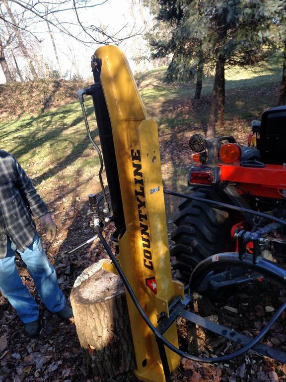

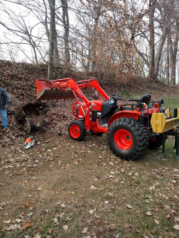

So an update. .. I drug home a BushHog 3 pt splitter this morning. Fairly new hoses and cylinder rebuild in the past couple years. Guy was done splitting wood and decided just to buy wood. He was able to demonstrate it working which was a plus. $350
Got it home and hooked it up. Had to reverse the connections as it was working backwards on my machine. I can say that I'm very happy with it! Ended up splitting about 3/4 cord of blocks I had piled up.
I timed the strokes at different rpm and found 1300rpm works fine for me.
Idle - 45 seconds
1300rpm - 31 seconds
1500rpm - 28 seconds
1700rpm - 24 seconds
2000rpm - 21seconds
