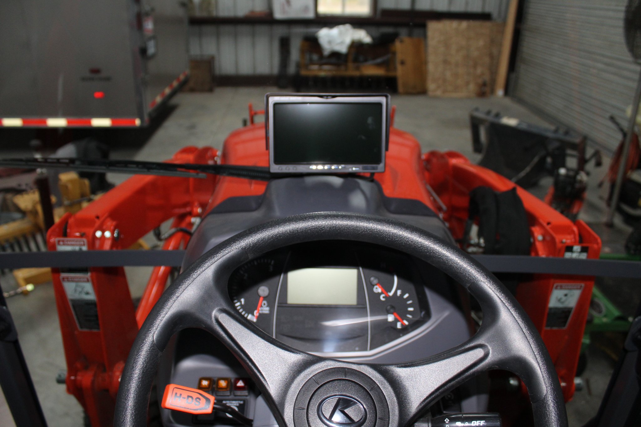

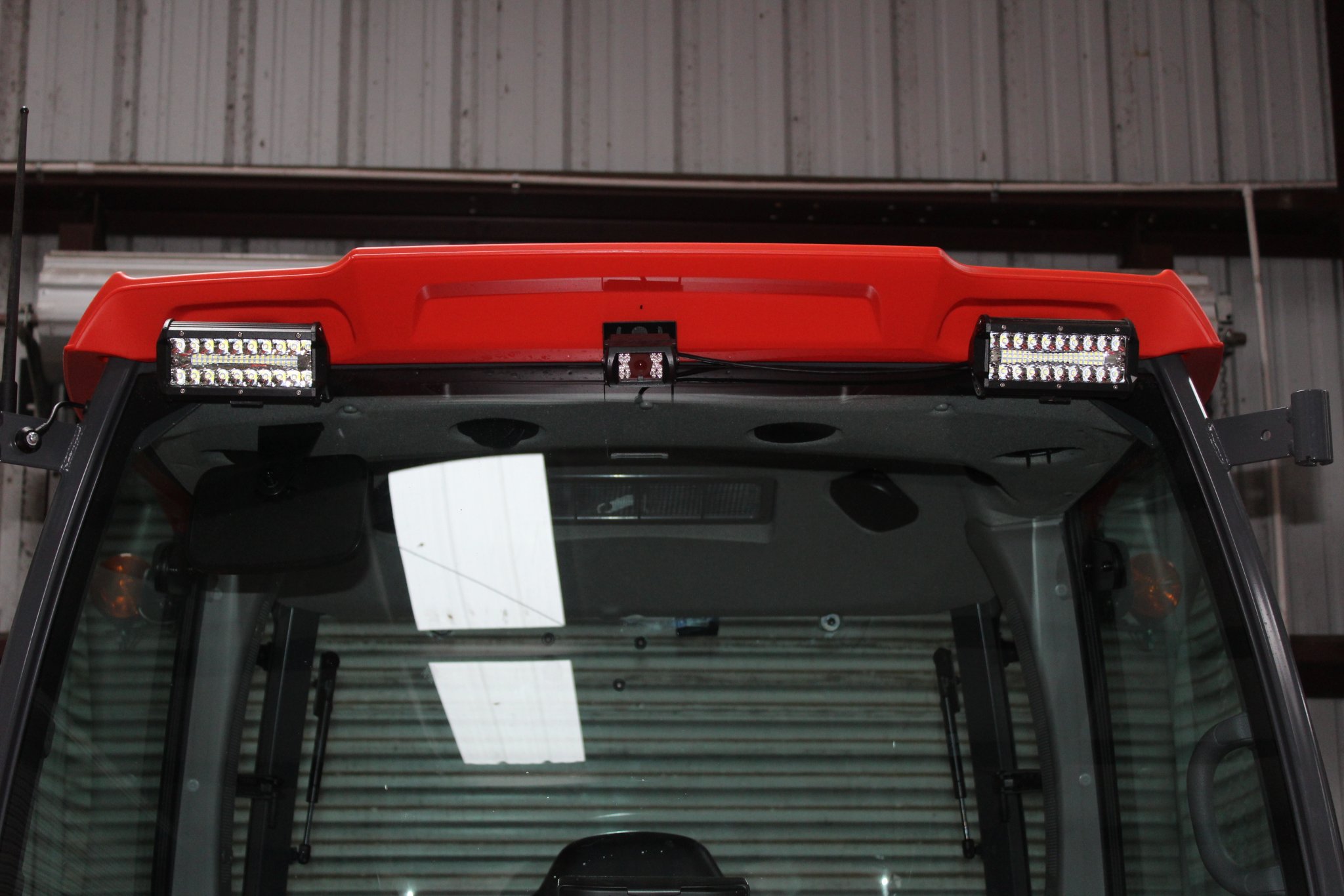

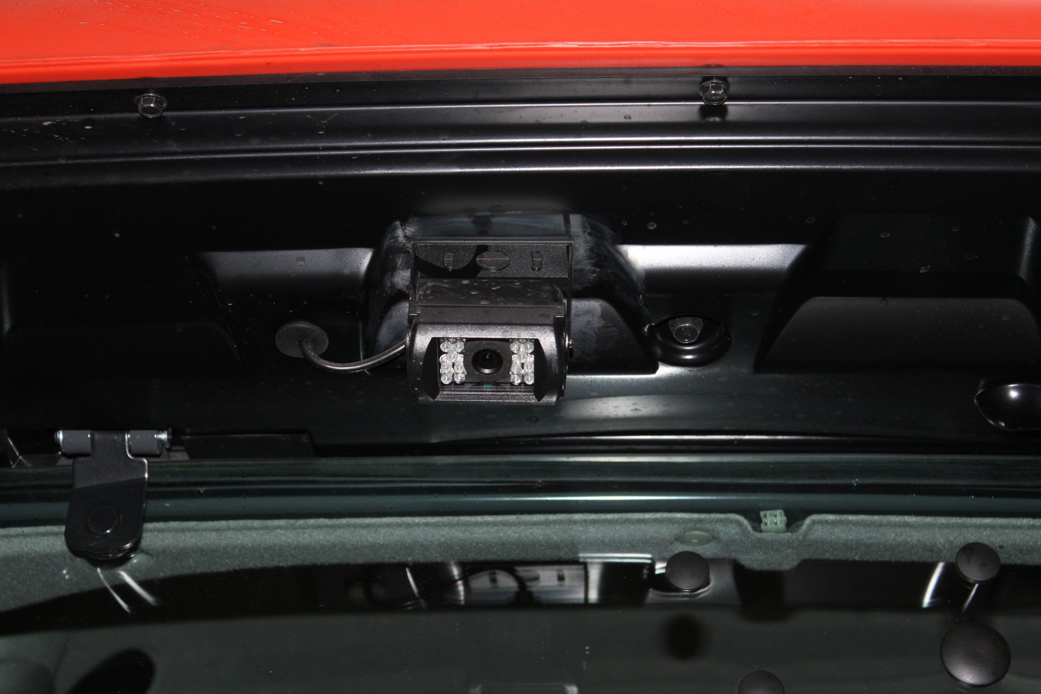

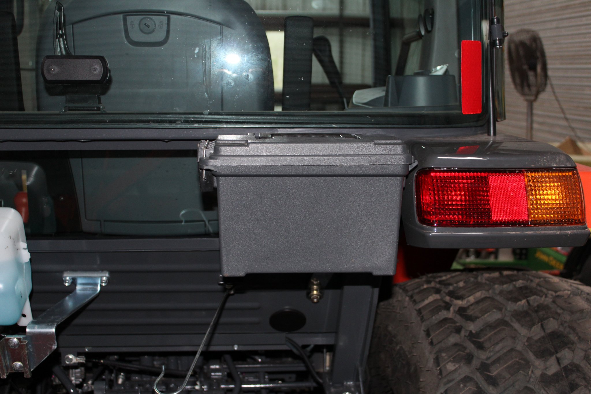

I install led work lights front and rear and a three camera system . Two front and one rear cameras . Also added a tool box on the rear .

Nice work! Love the stainless steel camera guard. Can you post a link or other information on the camera system please?

What lights/switches did you end up using? Plug and play? I'm debating outfitting my LE with front and rear work lights, but not quite interested in spending $400+ on that project

I bought most from eBay , back up camera system 7" monitor with 2 cameras and cables , don't buy from KY . vender at $89.00 .
Rear lights 2x4" led work lights $19.99 , rocker switches mictuning rocker swt. and panel $14.99 through panel away and just used rockers . 7" led pods spot lamps got from Amazon $32.99 . Hope you can read the diagram ok the top is the wining for the factory harness lower is the rocker switches . I bad a jumper between the two . Hope this helps .
