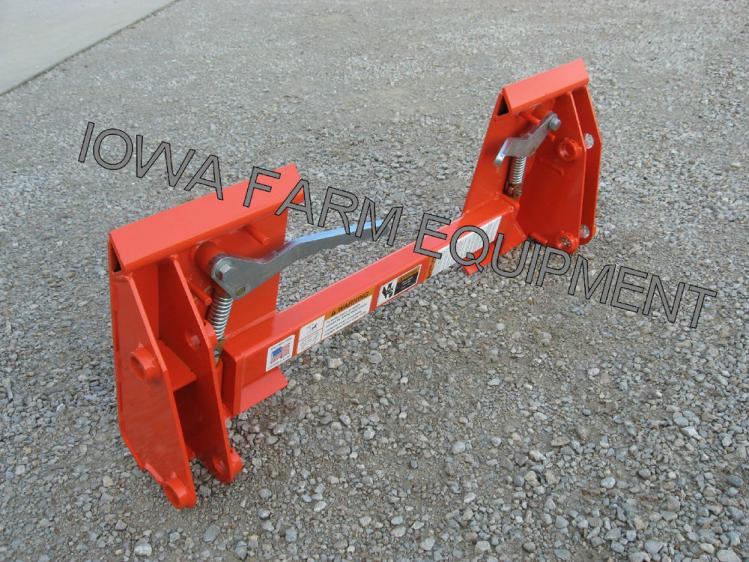

I have all kinds of plans for the quick hitch. Getting my snow plow out of my bucket and on the quick hitch is at the top of the list. I also have a boom pole that fits the QH that will be great for picking things up high. The hook on top of the QH should be great for lifting heavy stuff and save my bucket from any more abuse.

Well crap. I went to hook up my 3 pt. trailer mover today and it wouldn't fit in the rear QH. Looks like the new one uses the smaller size pins. Not sure what to do. About 1/2 of my attachments have the big pins already in them and if I change to the small pins I will have to use the bushings on the front QH. Making the slots in the new QH bigger seems like best idea just not sure I am brave enough to start cutting on it.

Didn't want to take the hitch off ( since its so heavy ) but wanted my bucket in the garage so I came up with this. Worked pretty slick. Going to replace the all thread with bar stock and come up with something better then the chain.
Did a little ( well a lot ) grinding and got the cat. 2 pins to fit in the cat. 1 hitch. Couldn't change the pins due to the nuts being welded in the tube.
