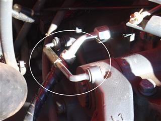

My M7040 has an adjustment rod that changes the height the 3PH goes into relief. Yours may have something similar.
The lever is on the top of one of the lift arms where it rotates around the main arm shaft.

It must be who you know. OK, I got it. A BMP file is what I was trying to upload. Switched it to JPG.[/QUOTE]
Thumbnails are not much help. I have a message off to Number9 to see if he will tell how he did it, if I get the info I'll pass it on to you.

Barquester
You can carefully adjust that turnbuckle that GWD posted a photo of to cause 3 pt to raise higher. Shortening the feedback rod too much will cause the 3 pt to put the relief valve in relief(open) when 3 pt is fully raised.

Barquester
You are exactly right. I know because I did it.
The result is that the FEL wont work correctly when the hydraulic pump is in relief. DUH. :eek: Fortunately, it was an easy fix.
Not sure if the OP's tractor has the same adjustment rod or anything similar. It would be nice to hear back from him.
