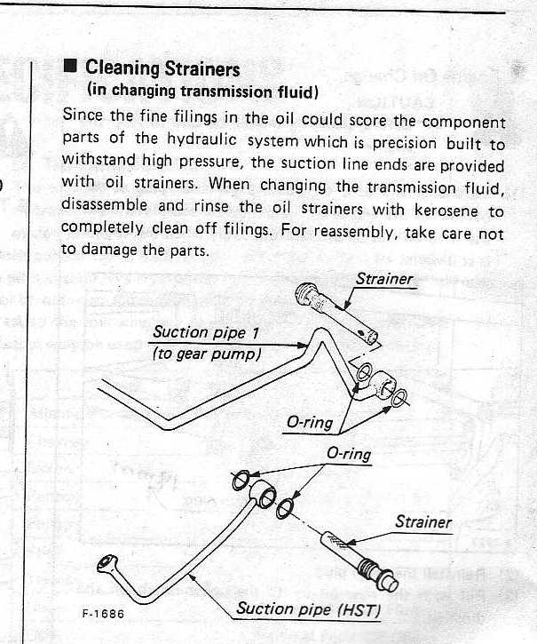

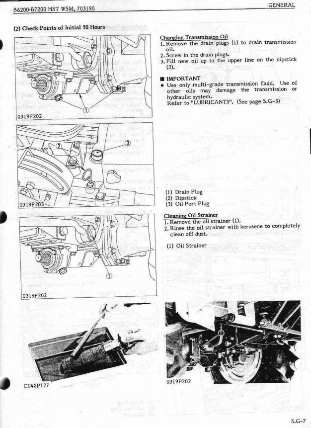

I see from the Kubota Operators and Workshop manuals where the 2transmission fluid strainers are located. Diagrams and photo from the manuals appended. Do the O-rings get replaced when removing and cleaning the strainers?
I'll take photos of the strainers and post them as a new thread in February when I get back at the tractor. Peter

There were three previous owners of this B6200 HSTD 4WD - Greg, Harold and the Newfoundland Liquor Commission. Only Greg used it for a bit of farming (about 34 hours with a plough, rototiller and mower + some snow clearing with the FEL). Greg did not clean the oil strainer, and while Harold changed the transmission fluid and screw-on cannister filter, he can't remember cleaning the strainers. These two chaps owned the tractor for a combined 5-6 years. So, I'll hold you in suspense about the strainers until I get back at the machine in early February (hopefully). Peter
