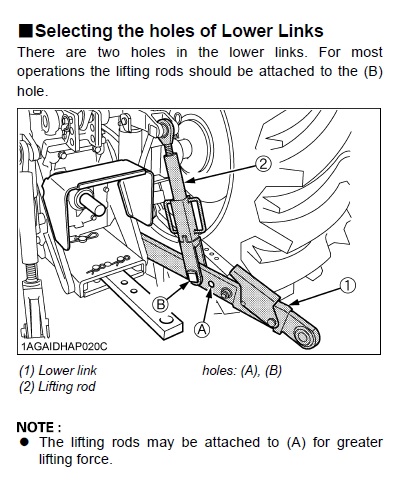

John,I believe you are talking about the nut I circled in blue and not the nuts in red.
If so then I have had the same issues and always tighten it down with a wrench, I leave a crescent wrench in the tool box on the tractor just for that.
You are correct, it is the one in Blue is my issue. I was thrown with the double nut on the turnbuckle since I wasn't even focused on the lower part of the 3 Point assembly. I'll now adjust my process to tighten that top nut with a wrench and see how it works out. Thanks Everyone
