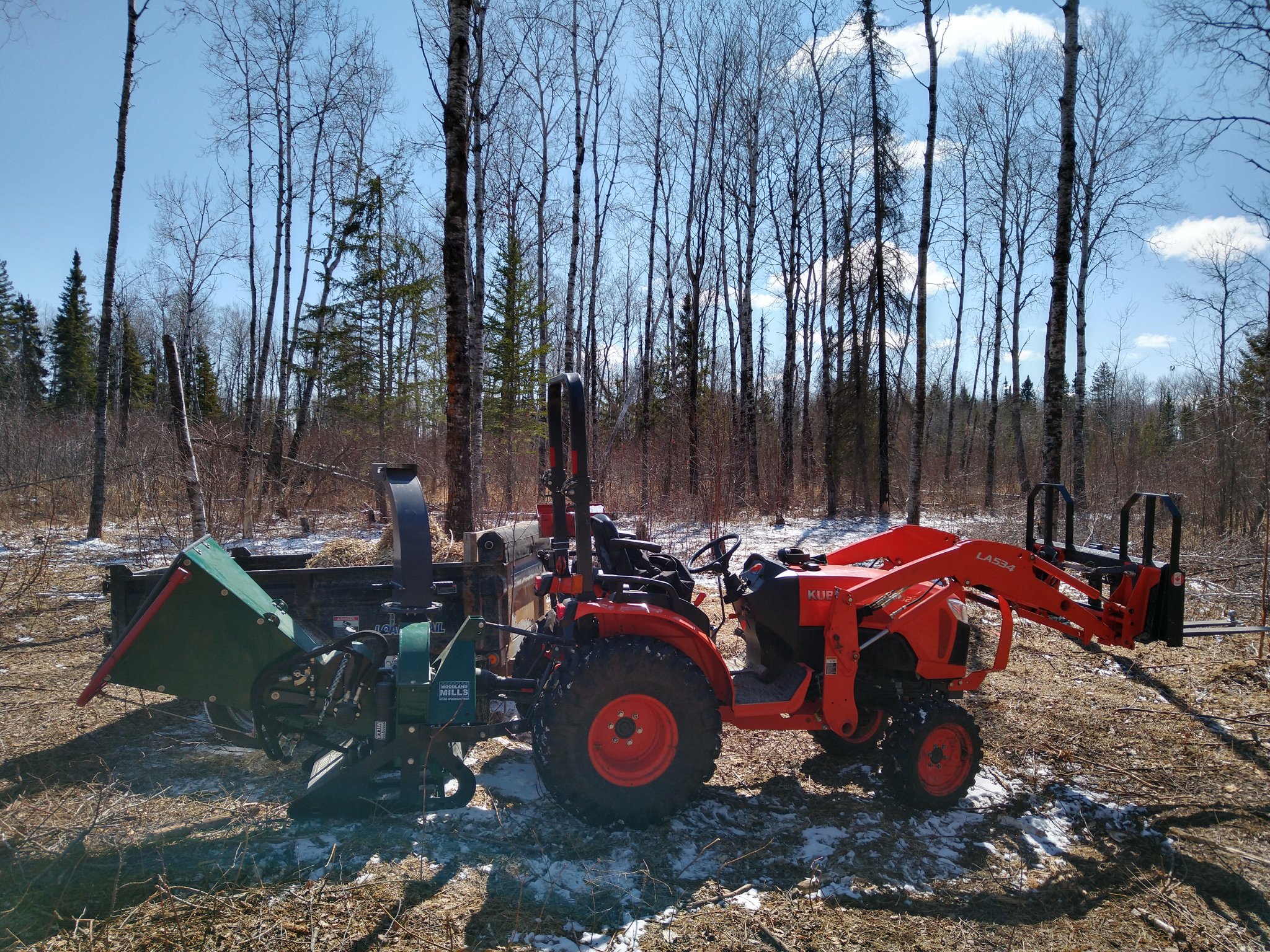

I have a B2650 And i am looking for a wood chipper.
It does not need to chip anything bigger than 3".
Stuff bigger than 3" will be burned in the wood stove.
Looking for suggestions on a three point chipper.
Jsjac
Lovin' my Woodland Mills WC68.

I've always got my pallet forks or loader on with the chipper on the back. When I go to the bush I pull my dumper trailer behind on the 3-point trailer receiver and forklift the chipper to the work area. Could trailer the chipper but the trails get squishy this time of year and the extra front wheel traction really helps.
I can put the chipper on the 3-point and then maneuver the trailer with a pallet fork that has a 1" hole for a hitch ball near its end. Can pull beside the dumper trailer and the chips pile right in. Then replace the chipper (and leave it in the bush) with the trailer receiver to pull the yard or 2 of chips home to dump.
If you look at my first pic in post #4 here the hitch ball can be seen at the tip of the fork on the right.

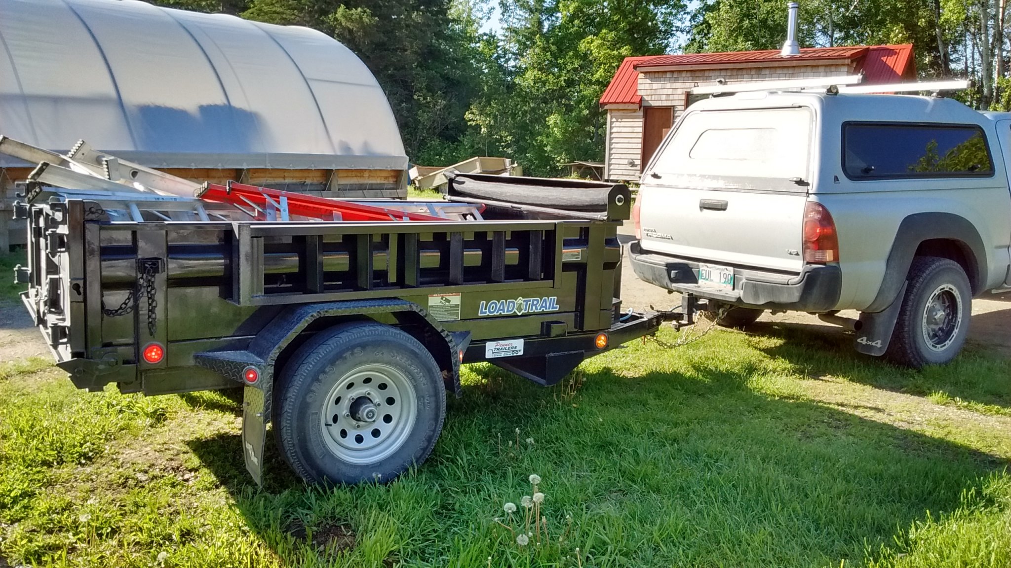

I would like to hear more about your dumper trailer. Thank you in advance.
Load Trail 5,000lb GVW single axle w/ electric brakes.
60" x 96" x 18" box.
Battery powered pump dual acting hydraulic lift w/charger/meter. It can handle lifting a full load (gvw-wise) of sand when fully charged and warm.
3-way gate - open at center and swing fully forward and lock in place for dumping, pivot top adjustable bottom opening for spreading, and standard tailgate with pivot at the bottom.
A photo brand new:
PS: 6 years later it's rusting to death, over 50% of that powder coat has peeled off or will shortly.
It's now rust brown. I hope Load Trail's powder coat quality has improved.
A photo brand new: View attachment 77468
Get a gallon of Ospho rust converter and stop the rusting. https://www.ebay.com/itm/115033127667?epid=23032423563&hash=item1ac8823af3:g:K44AAOSwBRVh6jqx

The ONLY way to 'stop the rusting' , is to remove 100% of the *(*&%#$^& powdercoat 'paint'. probably the worst 'paint' invented. Unless 100% of it is removed(no 'fun' task', water(moisture) migrates under the paint and attacks the steel. A true no win scenario. In 5 decades I've never seen anything powder coated actually NOT rust once it gets a chip, ding,cut, slice. i do like the trailer though ! Thinking of trading my 6x10 tandem for one like yours.
