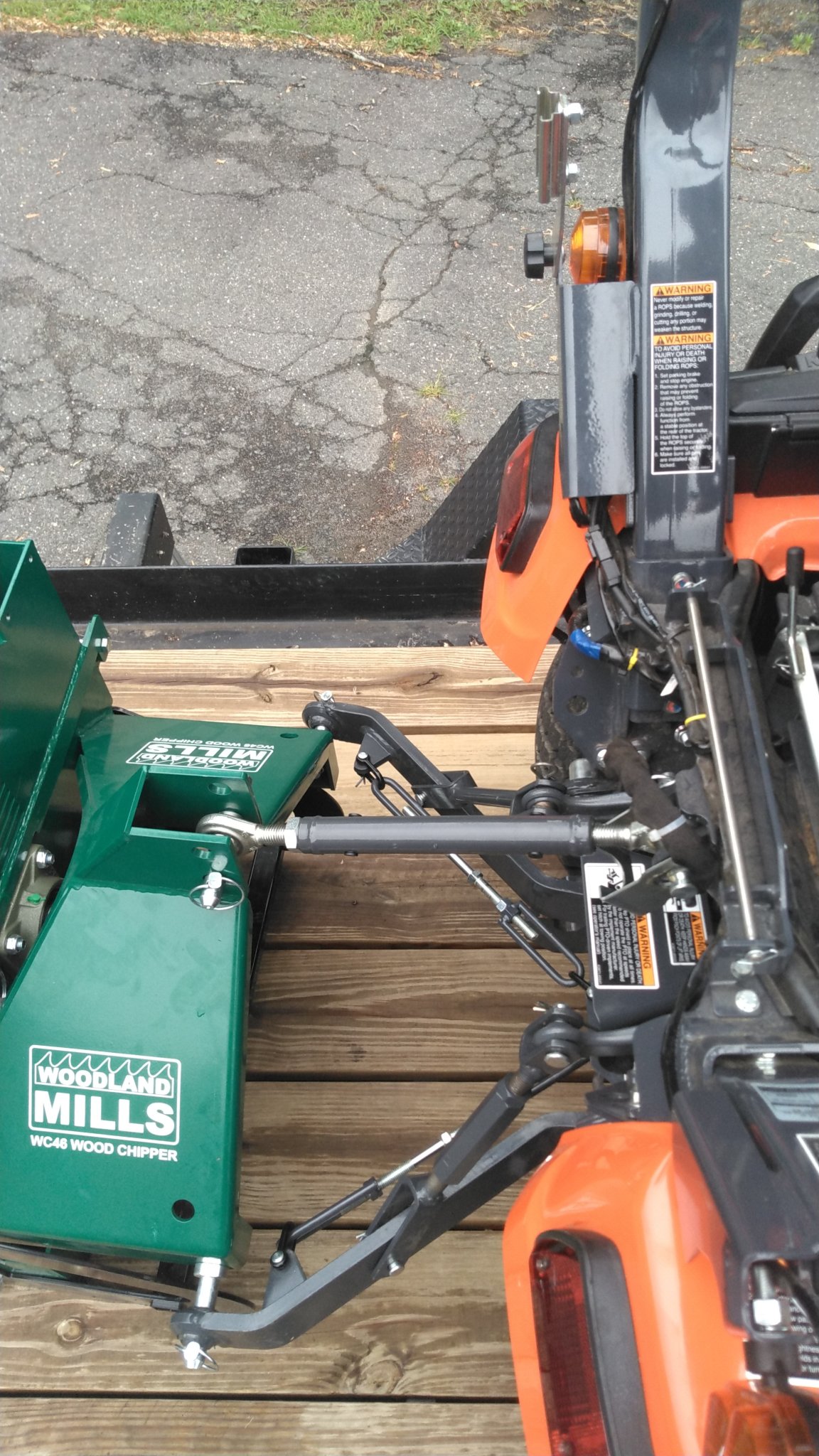

Question: Hooked up and used my 3 point hitch for the first time last night, why did it take me 30 minutes to attach my chipper and why is it crooked????
View attachment 61554 View attachment 61555
The real reason the chipper is crooked is that there is no PTO shaft between it and the tractor.
The tool will need to come off to install the pto shaft.. The second time you fit up the attachment, it will be much easier, and you will have gained the understanding of what all the parts and pieces are for, and how to adjust them! ;-)
