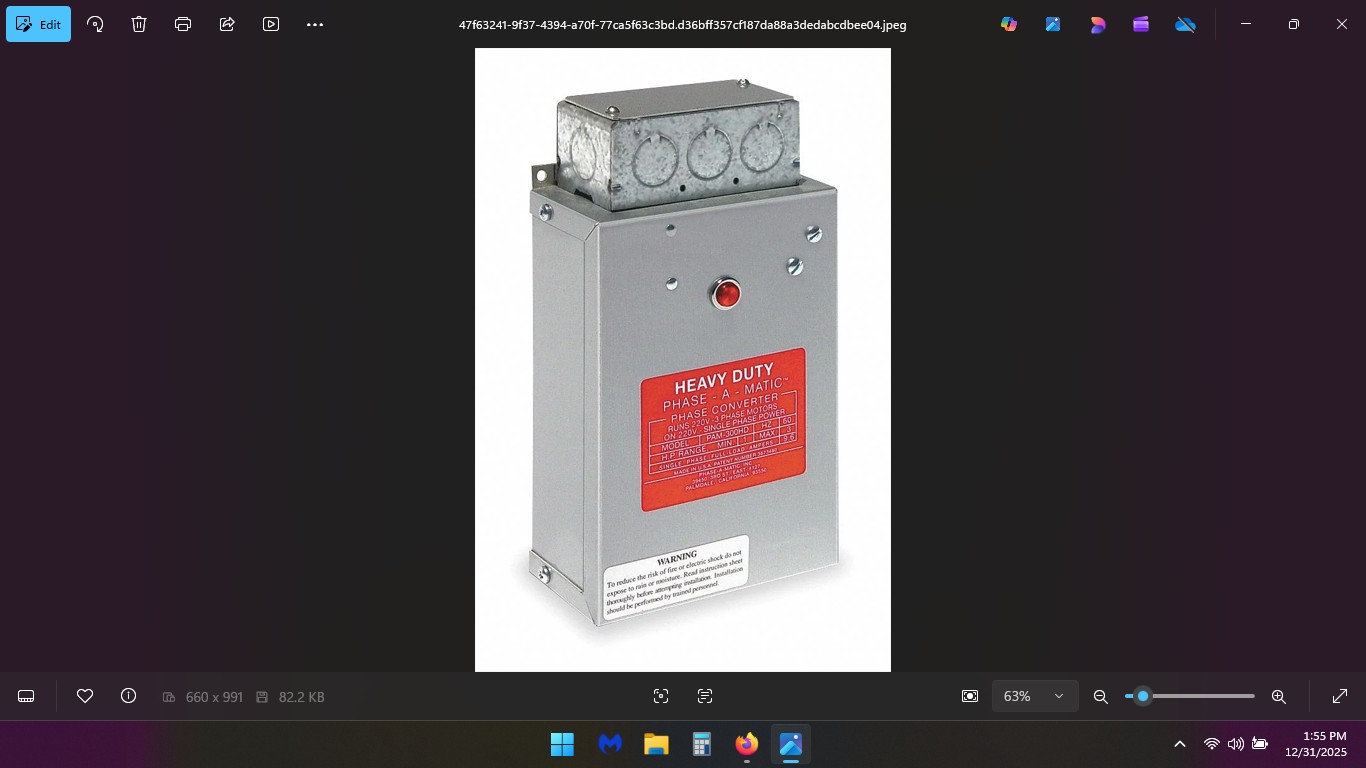

I see one of these for sale locally.... for $150 bucks.....
I know nothing about converters and have no need for one.....
But, I'm not against making a few bucks flipping it.... :ROFLMAO:
any thoughts?
heres a link to the unit new...

Wondering more if this is a desirable unit.... and is it a good option for someone looking for 3 ph power ......
Running with scissors had a thread and lots of options were talked about...
any opinions on this unit?

No question that I would buy it for 150 bucks.
Kind of a “niche” market though……….Out of all the people I know personally, I’m the only knucklehead that would be interested………. (Hell, none of my friends even know what 3 phase is, but they can recite the batting average of the Dallas Cowboys from memory…….:ROFLMAO: )
I think I am going with a VFD, but for that kind of money, I might be swayed…...
I do not know anything about that company though.

Thats a great deal if all you need is 5HP.
Reading the technical description its designed for powering hard starting loads like an air compressor. It has logic that repeatedly cycles start caps into the circuit at the zero point on the phase transitions. Thats a new idea to me and I have no idea if it works as claimed. Seems like cap life would be shortened considerably.

Did you happen to read what the Minimum starting HP was?
My buddy has a one similar (different brand) and it's 3hp min / 5hp max
It will not start his lathe unless he turns on his Bridgeport....

I just skimmed the blurb. I dont understand why there is a minimum. Can you explain the starting process.?

I'm not sure about any of this... I am pretty much ignorant to anything 3PH
But I happened to be talking to a friend of mine ... to quiz him on value of this one...
and he asked about min HP
Then told me about HIS converter and how it won't start unless he has over 3HP draw.

A normal RPC is started before any load motor. Once the RPC is up and running you start one or more load motors. The RPC simply supplies 3P power and knows nothing about the load motors.
