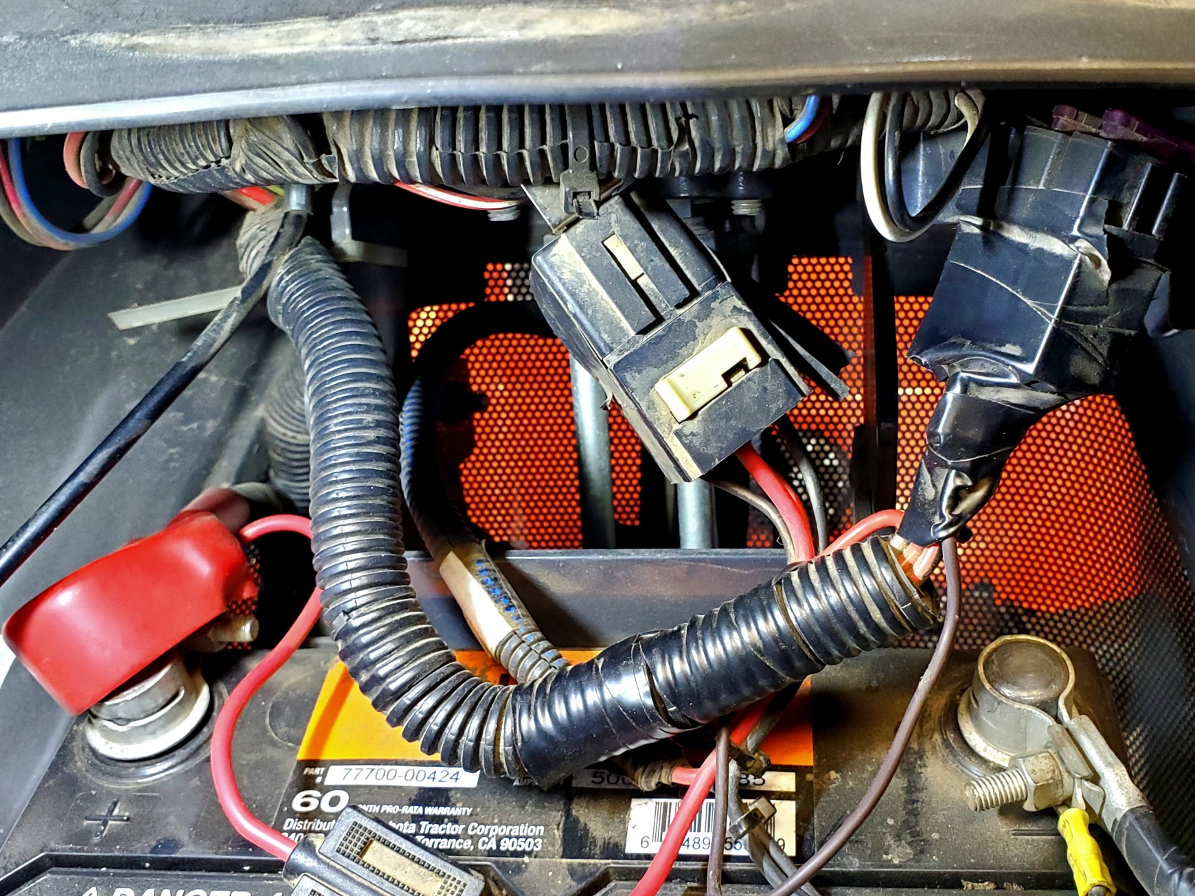

In the beginning, as described tested chute rotation after snowblower was installed. Went one direction then the other once and STOPPED. No obvious reason. FWIW included picture of wiring "under the hood" Checked there no problems found

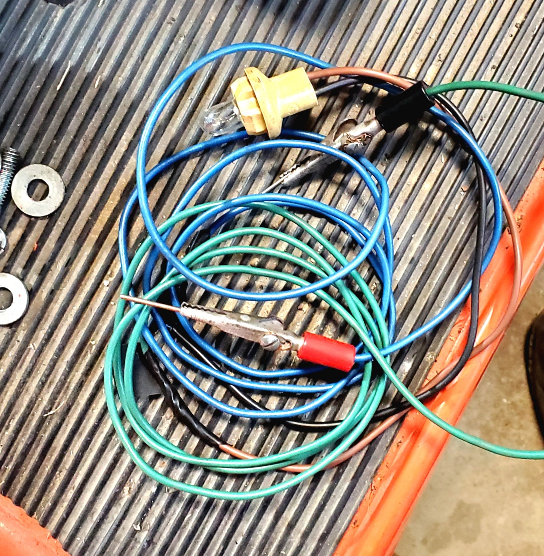

Cleaned contacts and tried again, no change. Used test light in photo, with ignition on, made contact with the cable connector light worked with switch in both directions. If the light bulb worked why not the motor?

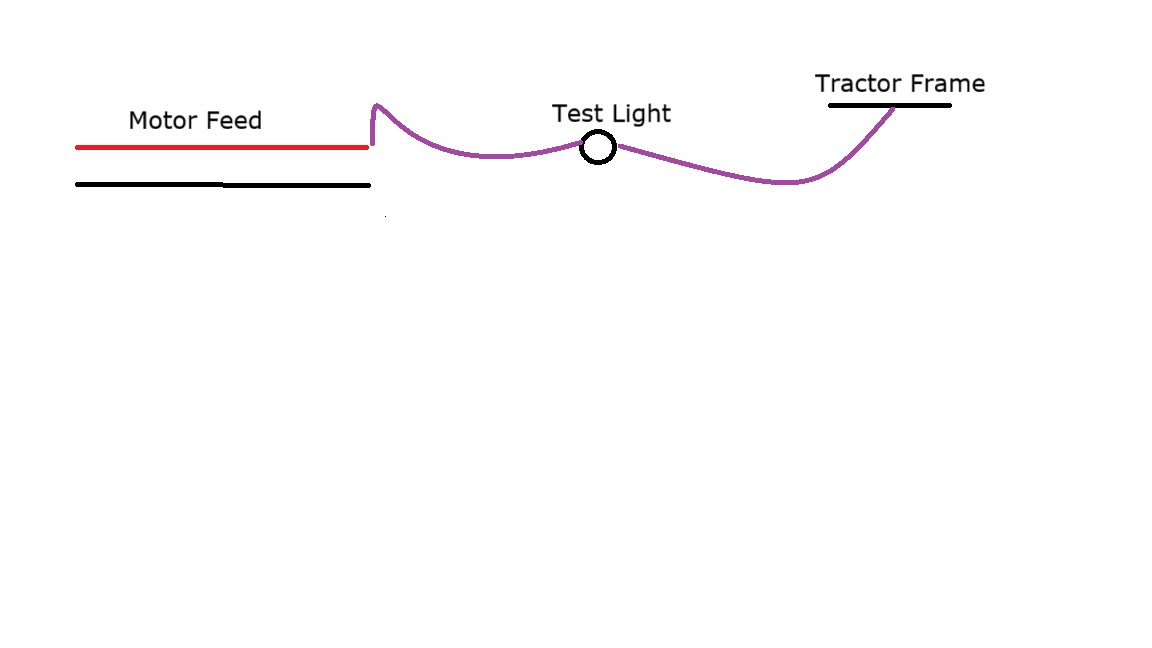

What Dustball said. Test polarity. You can do this with your light. The colors were used for ID and probably won't match what you have. Assuming you have two wires that connect the chute.
First, connect the light between the wires illustrated in red and black coming from the switch to the motor. Do this with both switch positions. It should light both times.
Next, test between the red and a known ground as in the picture. The light should only light when the switch is in one position.
Next, connect the light between the black and the ground. It should only light when the switch is in the opposite position. Blower Chute.jpg

Thanks very much that makes sense. Very well done and clear

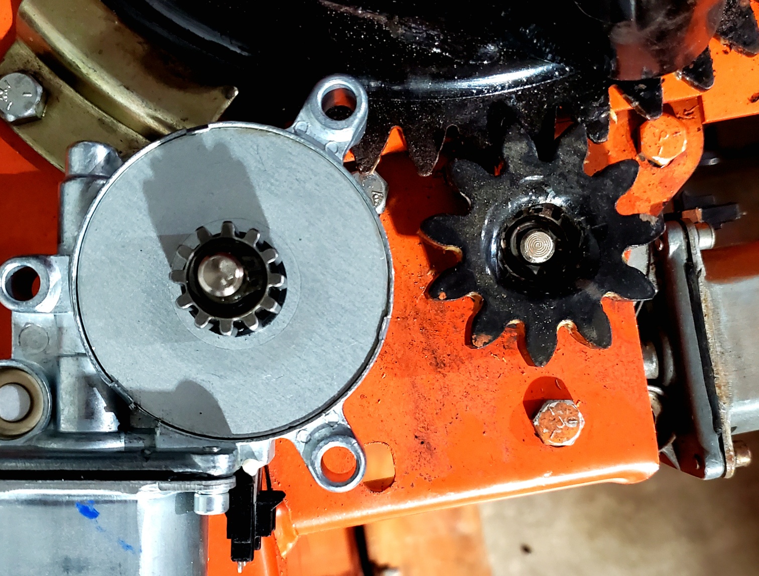

Update I bought a new "actuator" from the dealer. The gear on the new vs old can be seen in the attached photo.
I opened the box at the dealer to see what the gear on the new actuator looked like.
Showed him the picture of my hardware. He put the parts illustration up on the big screen. With the big image saw a gear that judging by the proportions looked like mine. I got the part number for that gear. The gear in the illustration ($60)! I saw an image of that part in the Messicks catalog. Looked about right but cant see the critical features on the "backside" that illustrate how it interfaces with the actuator. I'm hoping when pull the little gear of off the new motor it will have the same interface as the old one. That's the easy way. Attach new actuator to the bracket ant install the old gear, buda bing, buda bang, buda boom all fixed.
Also plugged the new part in for function test it worked like it should.
Any body familiar with this hardware?

Raymond Lopez
Thanks I was supremely ignorant. I have a bad habit of using my tablet.
When I looked at the parts tree I had to zoom in. With small screen did not see the large gear and set screws.
Got it together and have been using it the last two days. It’s a great machine!
