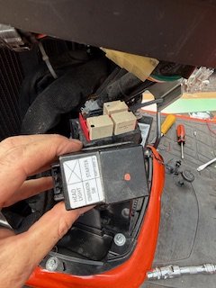

Update - had a quick break from rain so I was able to find the relays for the starter and headlights. I marked the starter relay and switched it with the headlight one and retested. I still have continuous power being delivered to the starter wire. Does that mean this is definitely a problem with the ignition itself? All the wires seem well protected and in the factory loom so I would think a short is less likely.

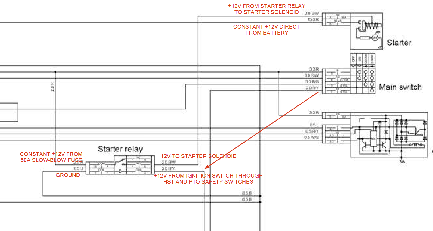

Here's the wiring diagram pertaining to the starter on the BX23S. It's very straightforward so there isn't too much to check.
Battery > 50 amp slow blow fuse > ignition switch > PTO safety switch > HST safety switch > starter relay coil
Battery > 50 amp slow blow fuse > starter relay common terminal > starter relay N.O. terminal > starter solenoid
Pull the starter relay. Check for continuity between the red wire and the black/white wire at the starter relay socket. If you have continuity between those two wires, those two wires are shorted together somewhere along the path.
If there's no continuity between those two, next check for 12 volts between the black wire and the black/yellow wire at the relay socket. The 12 volts should be switched on/off with the ignition switch and with the opening of either the HST or PTO safety switches. If there's always 12 volts coming from the ignition switch but turns off with opening either safety switch, it's the ignition switch that's the issue. If there's 12 volts always with either safety switch open, the 12 volts is coming from somewhere else between the HST switch and the starter relay socket.
