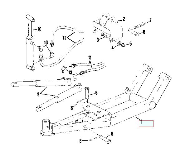

I just picked up a 2020 blade(pic enclosed)with what i will call the hitch, which has the left & right angle cylinders. I do not have the lift cylinder & hoses or any of the subframe...
Anybody have those items they would sell? Anybody have one they can measure lift cyl & mounts? I am hoping they are sizes... that can be gotten locally

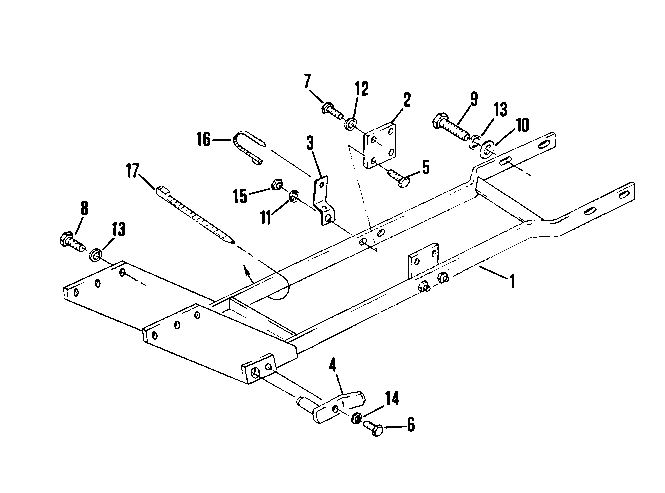

It's not as simple as just the mounts and lift cylinder, you will also need to build a subframe that goes to the rear, some cases the clutch housing, some cases the rear axle, it's all tractor model dependent.

Surplus Center for a lift cyl, hoses & fittings. Finding a subframe, not going to be easy. I bought a complete tractor just to get a subframe.

Ouch! I will likely have to get someone to fabricate a subframe, and buy a lift cylinder & control valve ...
I would hate to think a drivetrain housing would be used as a mount for something like a blade. Seems like a recipe for a major repair with the potential pounding

Any chance of getting pictures? Would love to see where the subframe mounts to the tractor.
