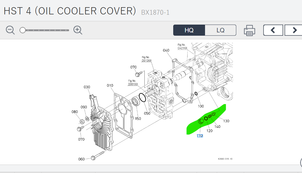

You did remove the charge relief and inspect as seen in yellow below and not the high pressure relief/check valves in red correct? You can leave the poppet, spring and shims out temporarily as a test. That should direct all charge flow back to the sump unless there is blockage downstream to the sump from that. I would find that unlikely unless it was introduced at the charge relief opening.

I did not direct him to remove the high pressure reliefs. I asked if he had removed the charge relief and not the high pressure reliefs.
I am looking at the BX1870 WSM posted on the Kubotabooks site.

The reason I asked which manual is that you picture do not match the parts in the BX1870 in the US version.
It's very common because kubotabooks has a lot of ever seas manuals that don't match our US models.

I have already read the entire thread. Here is the cover of the WSM manual.
The poppet you reference is from the exact same location on the HST housing as the one I posted. The image I posted is from the disassembly/assembly section.
