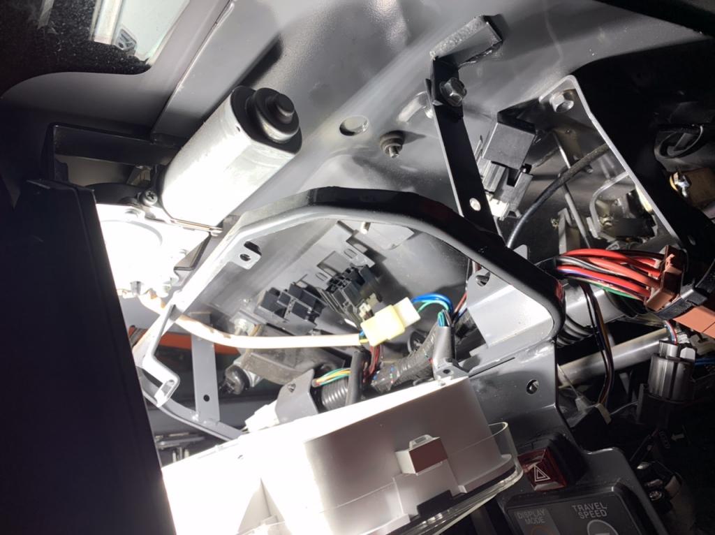

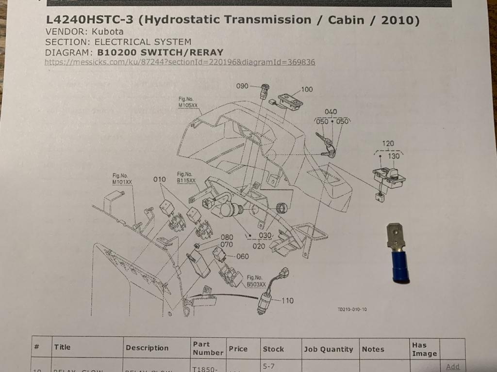

I pulled the dash cover and instrument cluster to access the glow plug relays.
Pulled one of the suspect connectors and checked it with the relay, didnt seem tight enough but not loose either. Grabbed a solderless connector and used a micrometer to check the thickness. It was .01 thicker. Tested the remaining three connectors. Loose!
Made wire inserts out of .010 wire instead of paper clips.
Added Power Service and topped off tank with winter fuel.
Started and it still had some white smoke but not as bad as before but it was hitting on all four cylinders!
Ordering relays from Amazon.
Thanks!

Did your relay have the 1/4" wide tabs?
What relays did you order?
Glad you're up and running.
Yes they had 1/4 tabs but back to the drawing board.
Left it outside today and it acted up again. I need to get a shop manual to check out the GP circuit. :-(
Must have been a fluke this morning.
Didnt order yet, I was planning on getting the same ones you linked on Amazon.

Relay part number RD451-54210 (this has the 3/8 inch wide spade terminal)
https://www.messicks.com/part/rd451-54210/relay-40a-iso
According to the video, the one on the right (sitting in the seat) is the stop relay. The left is the GP relay.
I just swapped the two on mine but didnt see any blueing on the terminals or bubbling of plastic.

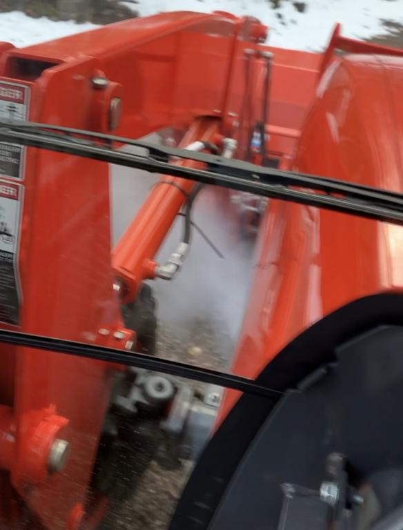

WRT Picture: That seems like a lot of smoke. My L4740-3 doesn't smoke like that on startup.
Have you done a compression check? If so, what were the readings?

The picture is a screenshot of the video with the worst of it. I watched a Kubota dealer YouTube video where he went through the whole lot in middle of winter starting his inventory. Some looked similar to mine but ....most puffed slightly.

Does it smoke like that immediately after startup or maybe 30 seconds after it first started?
Is your coolant level OK? (Just to rule out a headgasket issue, which is unlikely).
One test that might be helpful is using an infrared heat gun. When your tractor is dead cold, aim the gun at each cylinder while an assistant turns the key to activate the glow plugs. This way you can determine if each glow plug is heating about the same or not.

Guys, dfixit emailed me the video. He operates the glow plugs then starts the tractor. It starts but runs very rough and belches out white fuel smoke. The video is short and doesn't reveal whether the tractor eventually smooths out.
In my opinion, the glow plugs are not working, or not working correctly, assuming the tractor engine smooths out after 30 seconds to a minute or so, depending upon how cold it is out...
