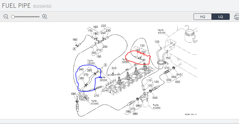

What your explaining does not sound like air in the system, sounds more like a glow plug or injector issue.
You could start with the simple test of seeing if there is air in the system.
Remove the fuel supply line (Blue) and replace it with a clear line.
Also remove the return line (red) add a piece of clear line and a barb to connect it back to the return.
Then if that works and there is no bubbles I would double check the glow plugs and make sure they are all good.
Then I would pull the injectors and take them to be tested and rebuilt as necessary.
