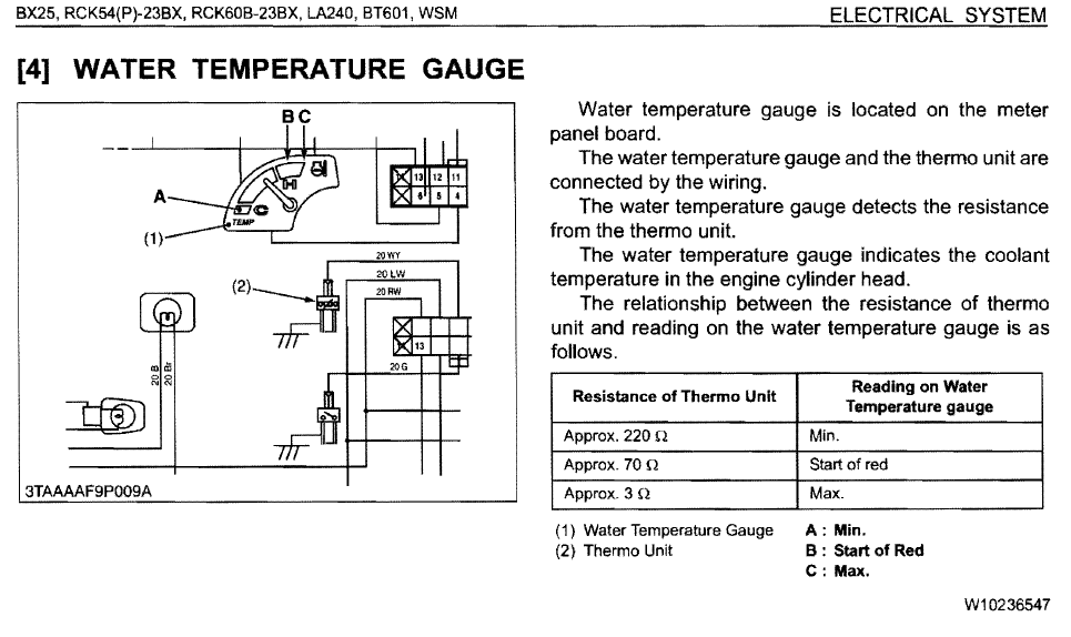

Both temp and fuel circuits will have a voltage regulator on the high side( typically 10 volts ) allows for better more accurate and stable readings. The WSM should have a chart of resistance vs temperature.
I use bowl of water on stove to slowly heat up sensors with a know calibrated themerometer close to the sensor. That way I can plot the sensor's actual response.

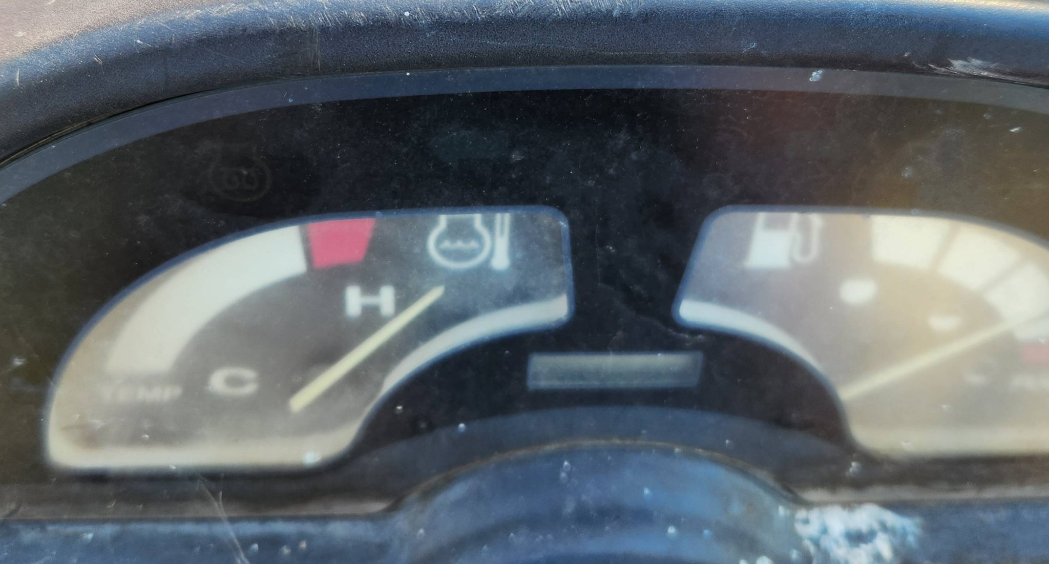

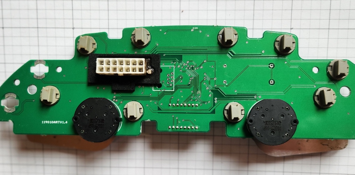

Does anyone have pictures of the Different style gauge clusters used over the years in the BX25 Series? I believe my tractor is and 2014 and looks like the one in the picture I believe or it was used for more than a few years.
