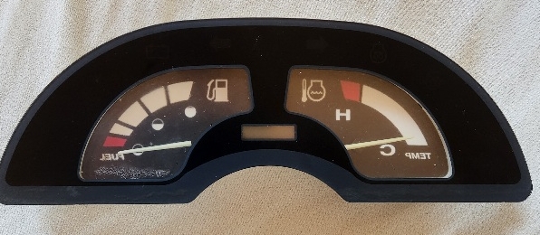

Since you seem to be electrically oriented and you (or someone) mentioned LEDs, could you use the existing gauge and embed a few leds into it? Maybe three to six LEDs and set them off at different temperatures and color code them?
Basically a digital/analog type of gauge. I think I have seen some on modern car dashes.

Yes I thought of that and might end up doing that. The reason is mounting a clumsy gauge on a tractor with no logical place that often gets rained on is a problem. I thought of just doing the circuit I already showed and by adding a simple comparator like an LM393 and 3 LEDS for maybe Blue or white =cold, Green = in safe range and Red for too hot. I could just put them inside the existing dash which is waterproof and located in front of the driver. Not a bad method. thanks... It eliminates the mechanical gauge mounting issues which is messy. Its all I need to know anyway. I could even but a small buzzer alongside the red LED as an audible Hot warning. This might just be the best solution. I could just tap the existing temperature sensor voltage entering the dash and calibrate my LEDs for appropriate voltages for cold, normal and hot.
