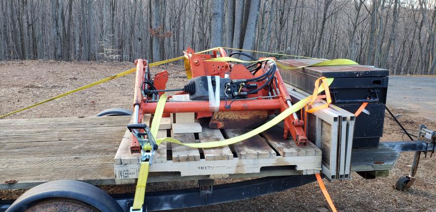

Hi everyone. An update: I have the front loader from a b7510 I posted a picture below. Its sitting on my trailer still but I will try to install it this weekend and post pics again. Any tips/tricks for the install will be appreciate. Still no time to make any headway on the deck identification but will get back to that soon as possible.

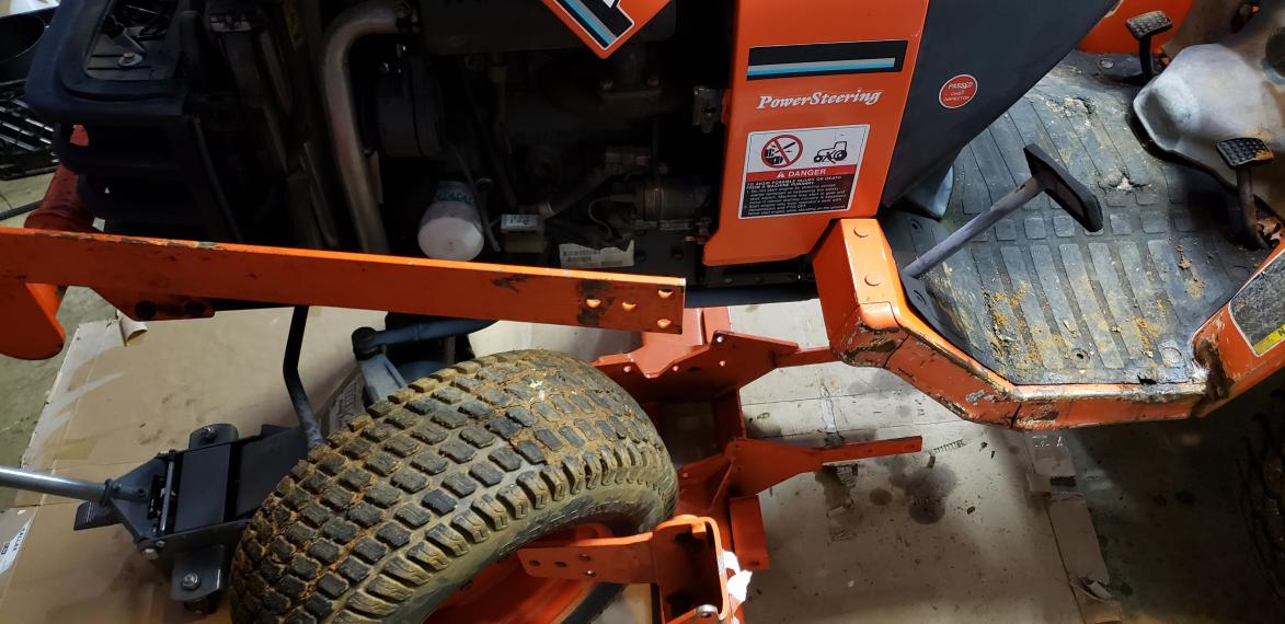

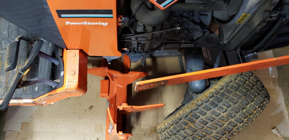

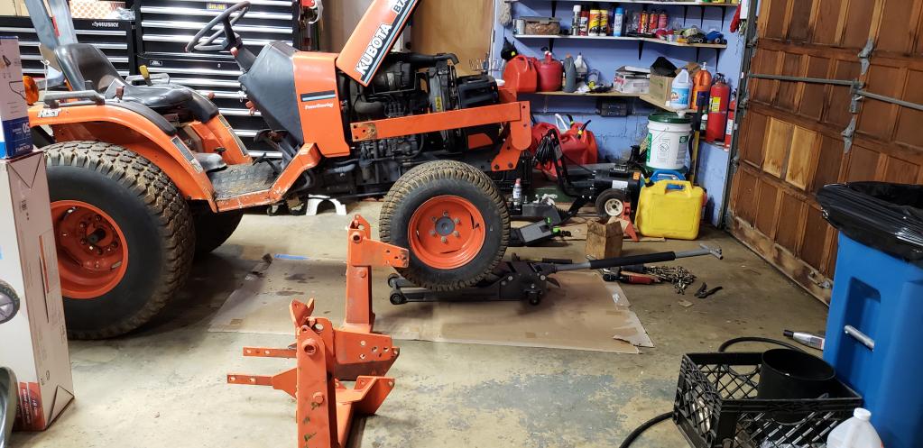

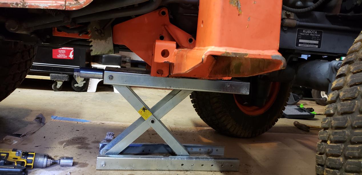

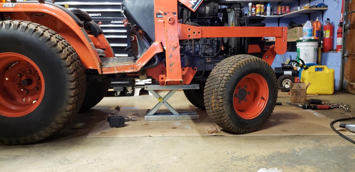

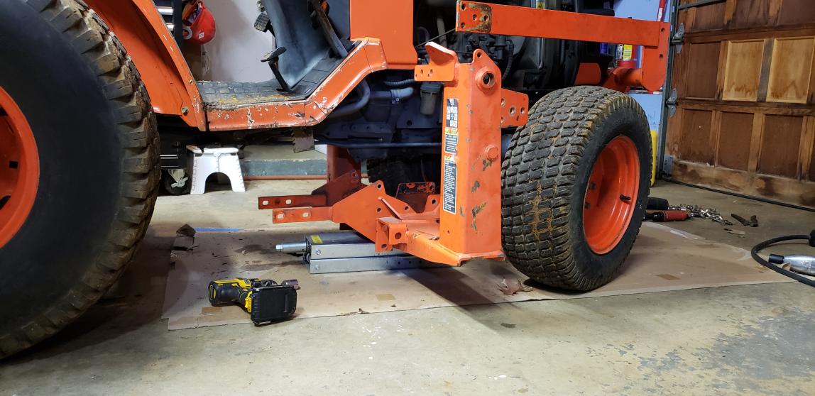

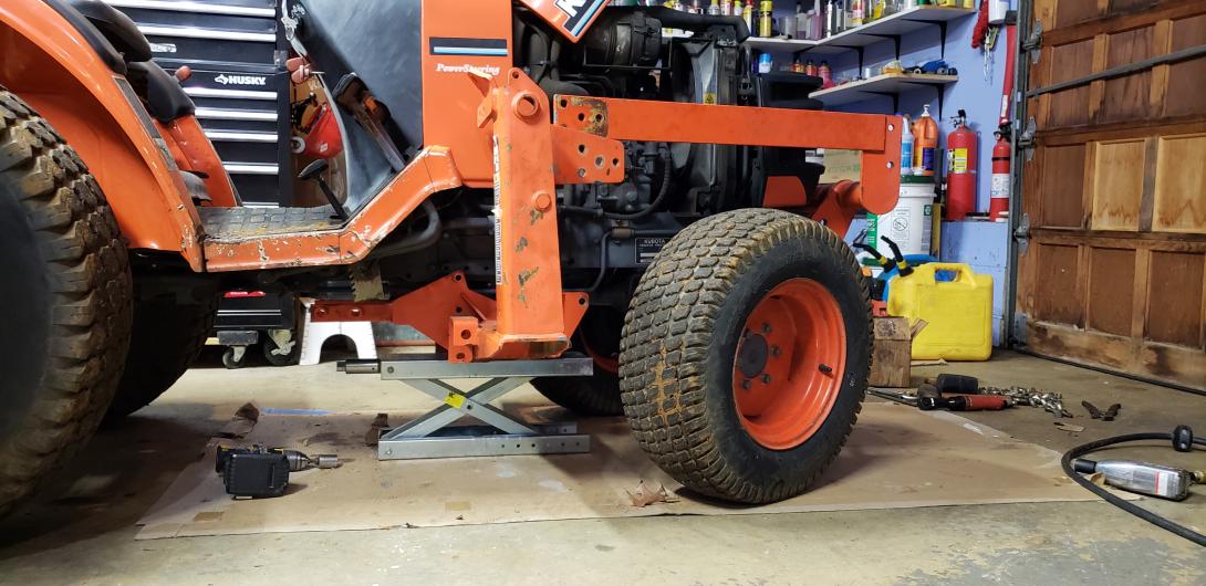

Update:
its late so i'll be brief but will post pictures
went to dealer, got fluid, came home and muscled the loader in to garage. Took about 4 hrs non-stop to install using air tools and jacks to lift parts in place. will re-check everything tomorrow. Didn't do the hydraulics yet. I don't know which of the two short hoses goes to which side of the block that mounts to the tractor! I have an orange and a green hose. There is also a longer hose_not color marked_ (the return i guess)and I have no idea yet where that goes. Will try to figure that out tomorrow. Sorry but I don't have time to do a full write up but hope the pictures are somewhat helpful to someone. Thanks for all your help

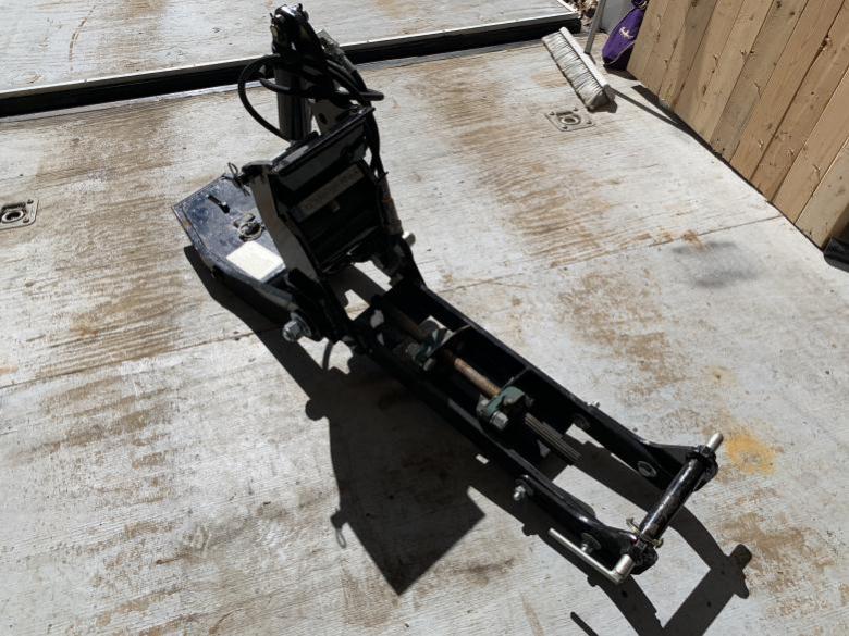

Hi Again. Grazy idea but might work..... Im in the process of buying a front hitch as pictured below and a sweeper attachment. I priced out the hardware missing from my mmm deck and it turns out they are $1800!!!. also a rear finishing mower is about 1k. I have a craftsman tractor i use now so I just cant justify another thousand dollars for rear deck just yet (I will try to break the craftsman ...by accident in the future .-).
Does anyone think its possible to fabricate a mount and attach my mmm to the front and power it via the pto thats on this hitch? I can do the fabrication and maybe add some nice big wheels to the deck so it can ride on them and just use the front hitch for lifting/ moving the deck. I will be basically just moving the deck 2-3 ft forward...any thoughts?

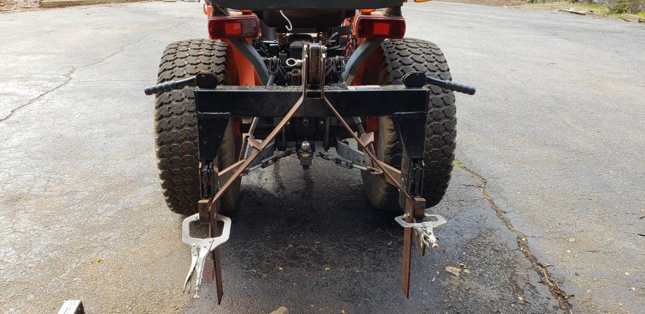

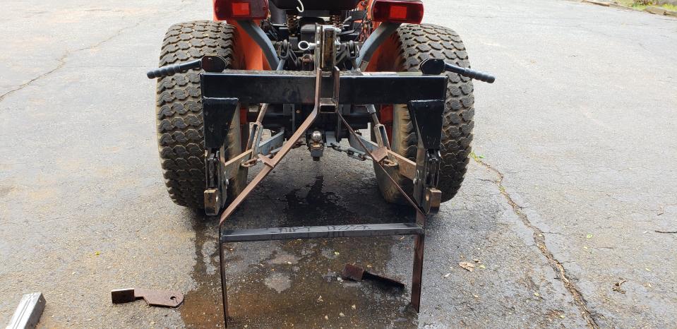

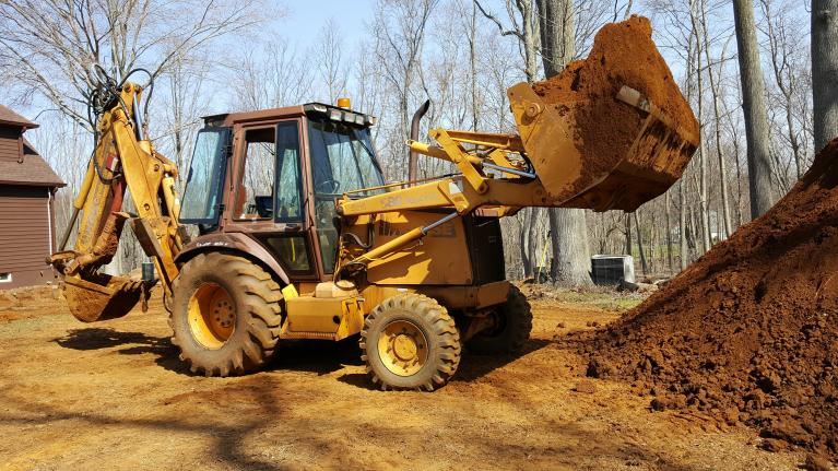

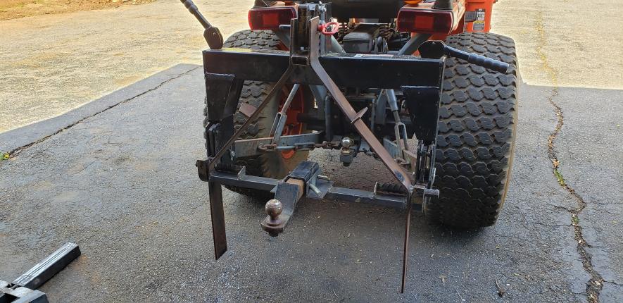

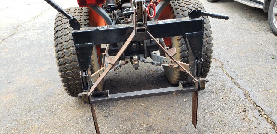

BTW If anyone finds this useful. I also built this with parts I had laying around. I needed on a Sunday and stores where closed!
Probably not very strong but handy as a multi use 3 point attachment point. I originally built it for the (shallow) trencher partially pictured on the left bottom of the fourth picture. Sorry no other pictures of it right now...it worked great. removed soil leaving a pretty clean trench about a foot deep

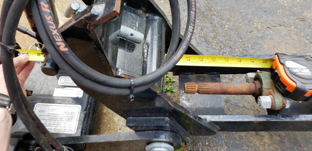

Hi Again. Do any of you know what parts I need to compete the following installation? 2003 B7500 tractor to BX2537A sweeper through B2733A front hitch. The sweeper came with a front driveline male shaft that is too short (12") I measured about 19"-20" length needed. I think I narrowed it down to 70060-02171 or 70060-01783 with the help of someone at Messicks. Also the rear of the straight shaft thats on the hitch needs to connect to the rear PTO. I was told maybe the 44" part # 7060-02186 would fit. Can anyone verify that or have any input on the first question? Im including some pictures for clarity
