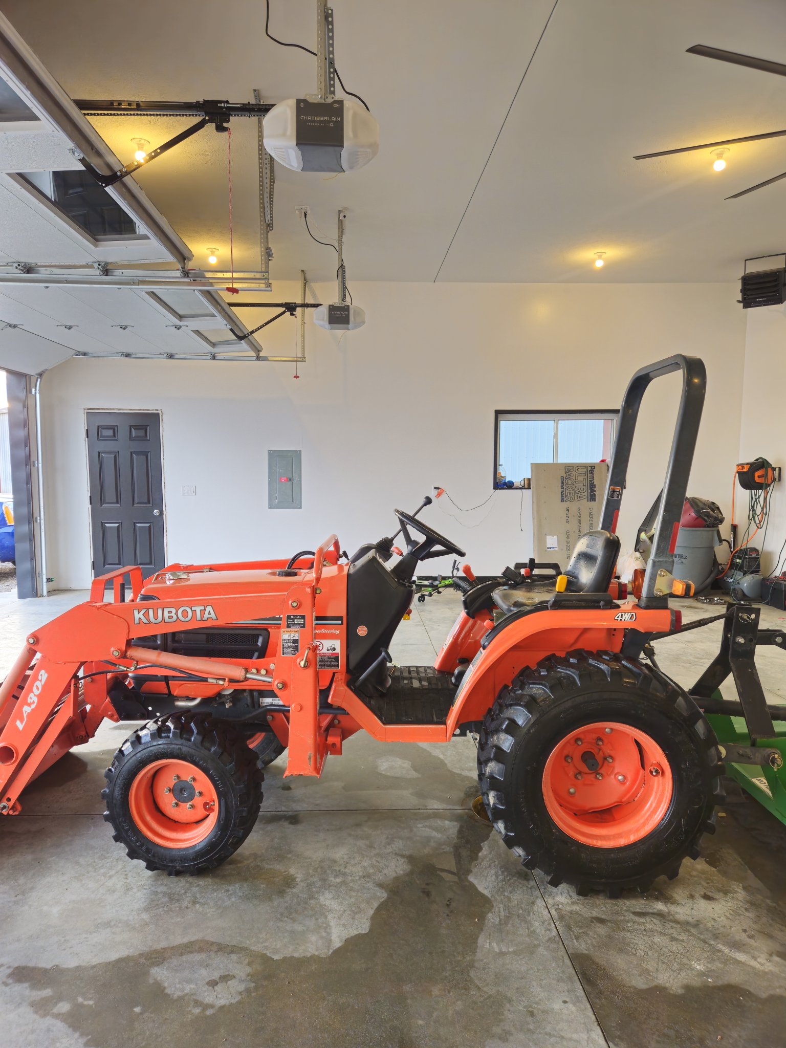

I have a 2001 Kubota B7500D that has 300 hours with the 1.0L diesel. When shifting out of neutral (1,2,3,R) all of the gears do it. It grinds very bad. Like if you dont jam it into gear you cant even get it into gear. It wouldnt start one day and realized the clutch saftey switch wasnt getting pushed in so i thought maybe the fix would be to just adjust it per the book. This fixed my safety switch problem and helped the grinding a little bit but still does. Once its in gear everything works like it should. Does anyone have any input on where i can start to figure out what the problem is? Also, this is a new unit to me. Ive ran it about 5 times since ive owned it for a total of about an hour.

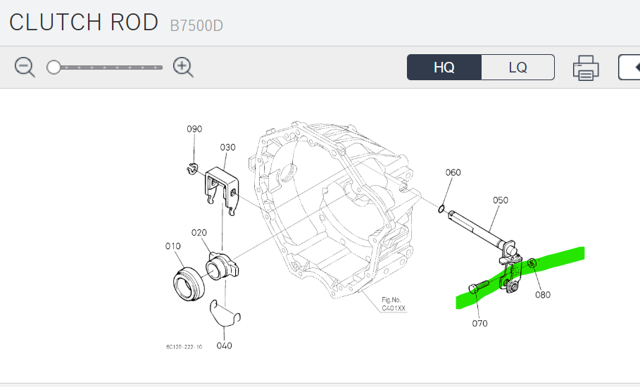

Yep, like this one:

Is there an adjustable stop bolt that is preventing the clutch pedal from depressing enough?
The same thing was happening to me on my older B6200D and the stop bolt wound itself out due to vibration and needed winding back in and nipping up with the locking nut.
Wow awesome suggestion! I did adjust it a little when i made sure i had enough free play but apparently did not mess too much with the stop bolt. This fixed most of the grinding. Theres still a very slight grind but if i go real gentle theres none.
